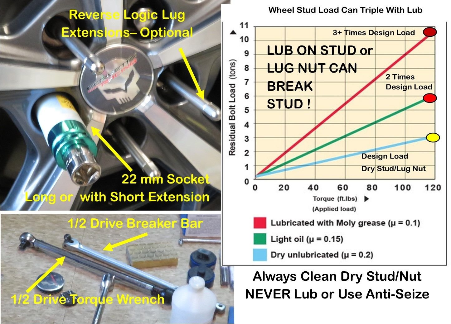

Every place you look IF you try to understand the implications of adding lubricate or even anti-seize! Quoting just one I found:
"For everyone that thinks using anti-seize on wheel studs is a great idea, you might want to think about it more. Sure it will torque up and clamp the living do-do up really tight, but at the same time it is also can stretch the stud beyond the yield point to the point they could just snap. Dry, clean wheels studs, and a good torque wrench is the correct way. Here are a couple of pages from my training manual, which has examples of the what the effect of putting lube on the studs, which can DOUBLE the clamping force, which turn into tons of force. Proper clamping force is the key to keeping the wheels attached to your vehicle. Also, excessive clamping forces will probably distort, and damage the lug nut seats on the wheel, and brake rotor. And who knows what damage there is to the actual threads on the nut/stud."
Just one of many if you search. Yep that 140 ft-lbs on a lubed stud could be like using twice the load on the stud or the equivalent of using 280 ft-lbs! Same with all bolts in any situation. Yep could break the stud!
PS: Perhaps this graph will help explain why when in says the lug nut and wheel stud should be clean and dry when torqued to the specified value:

Made this summary pic showing what is needed; including CAUTION to NEVER use any Lubricant, WD40, or Anti-Seize:
