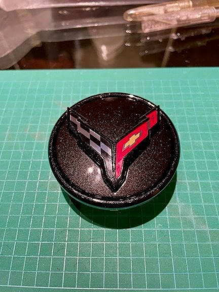

They are three piece and come apart pretty easily for paint. I plasticoted the background so I could change color easily. I found it better to pry them apart from the rim of the cap rather than crimp the tabs and push them through to seperate the pieces

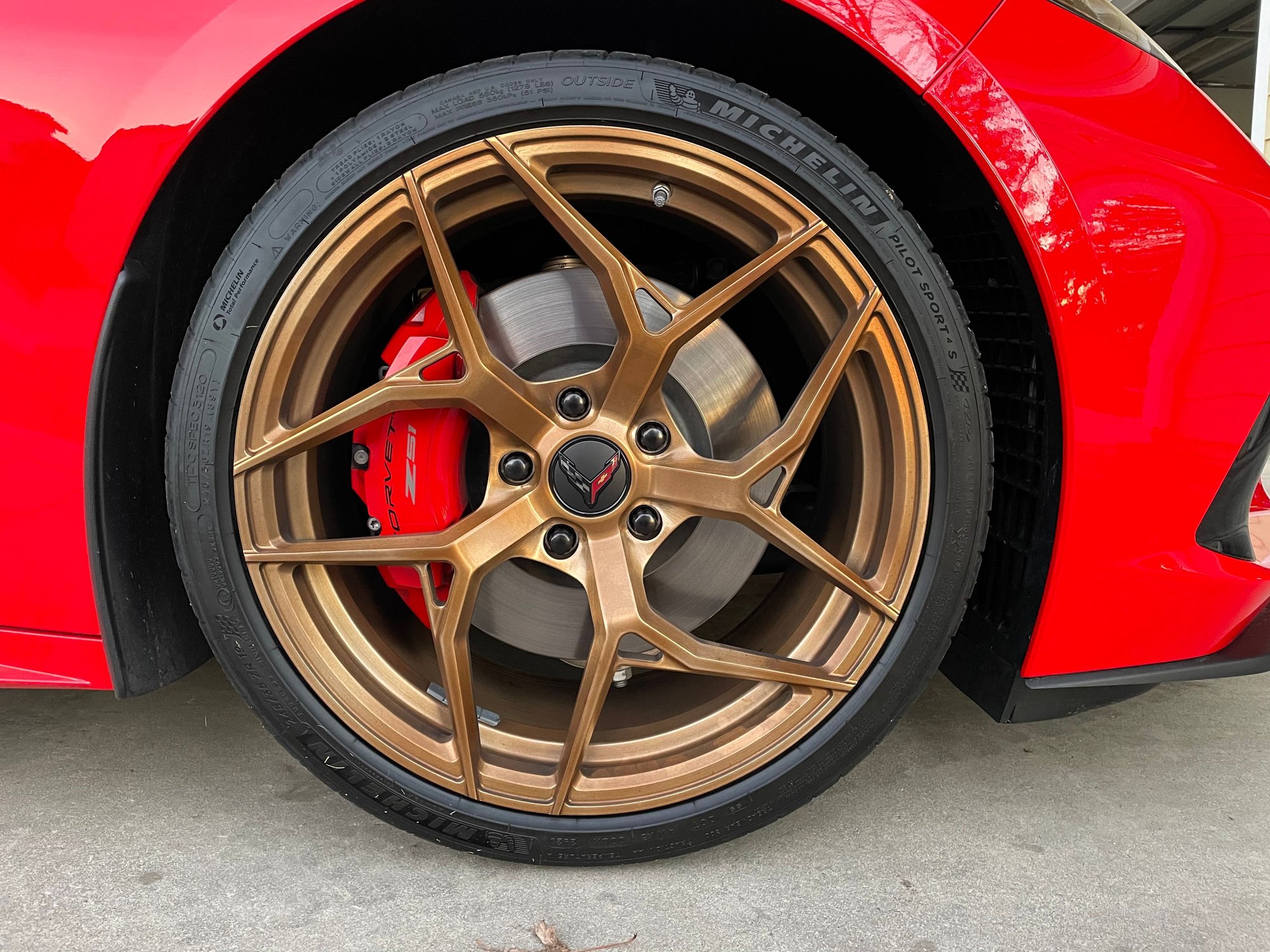

They are the stock center caps that came with the base silver wheels. I am not sure of the diameter
here is some pics before I painted the caps

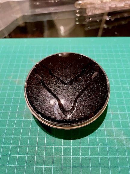

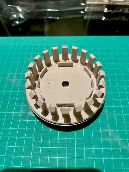

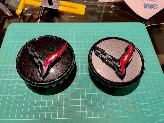

I stumbled across this thread tonight and decided to give it a go with some 3M vinyl instead. Agree that there is no need to separate the caps into 3 pieces; just gently lift the trim ring and vector up and work your way around the perimeter gently. It is held in place in a series of slots around the sides and it slides out easily.
Once separated, I just cut some circles of the vinyl and stuck them over the cap center. I applied a little hairdryer heat to set it and that was it! Super easy and I am really happy with the results. The finish of the 3M product is an excellent match for OE Carbon Flash. Finished off the caps with ceramic coating for a total cost of maybe a couple of bucks. I bought a 5'x1' roll on Amazon for $15 and used maybe a 4" x 1' strip total for all 4 caps.
OE Silver Cap
No need to separate into 3 with tabs
3M wrap over main cap
Carbon Flash Vector & Ring reassembled
Carbon Flash Wrap + OE Silver Finish
3M 1080 G212 Gloss Black Metallic

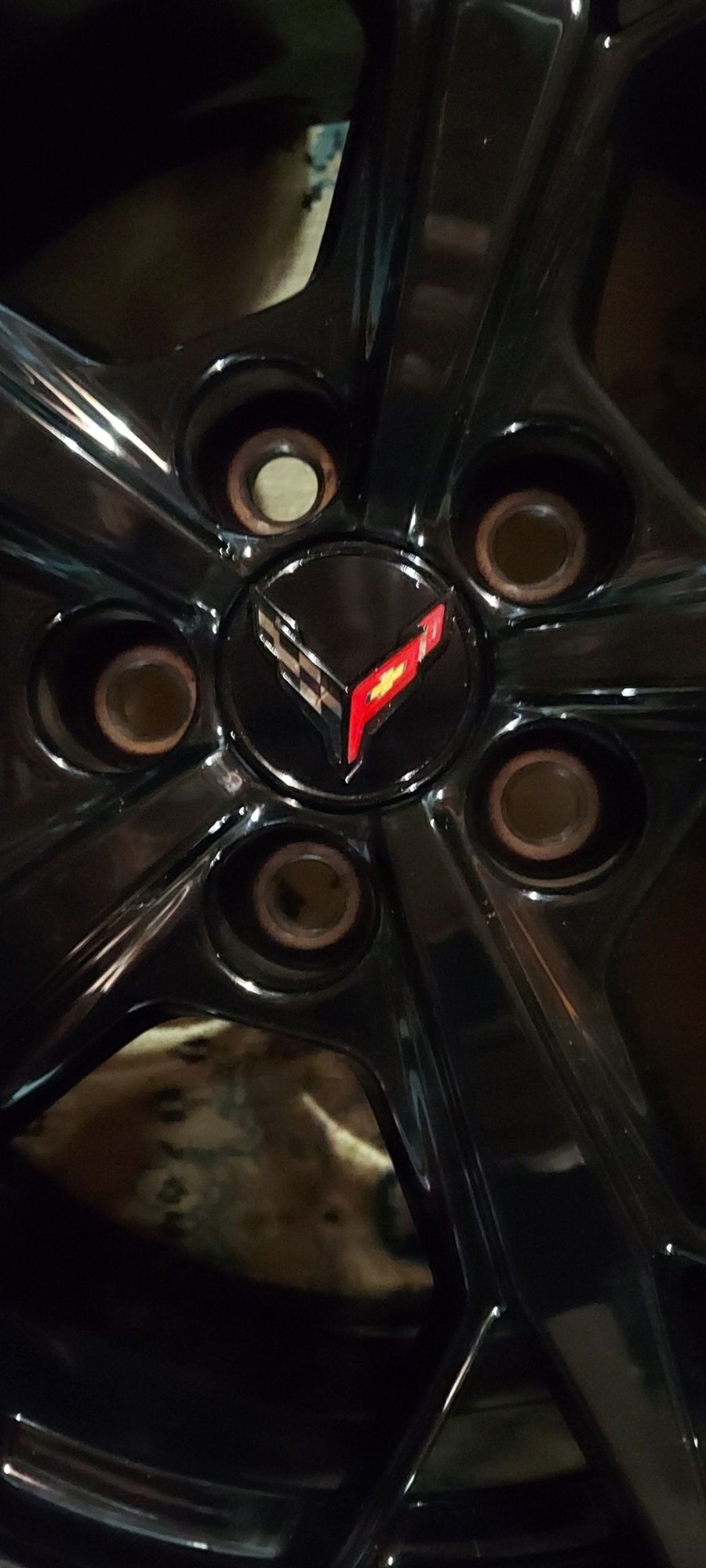

Used Oracal 651 black vinyl. Very easy to use and mold into the emblem base. 👍

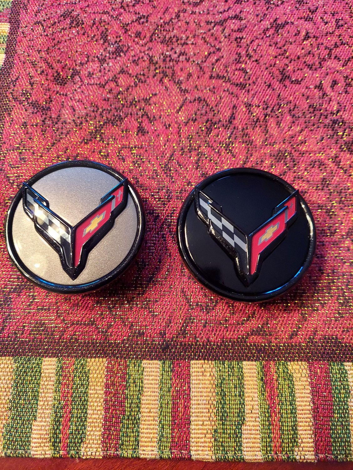

just popped it on the wheel, matches perfectly!
To Center cap disassembly

The vinyl does not affect the way that they snap back together. As far as laying the vinyl in the logo area it was not difficult. Just be sure to work it in with your fingers. Start at the bottom of the cap and work up smoothing it out side to side. Really no need for a heat gun or hair dryer. Make sure to clean the surface with alcohol to remove any wax etc. Cut the vinyl a bit bigger than the cap so you have room to work it into the logo area. Trim off the excess when finished and snap it back together.
