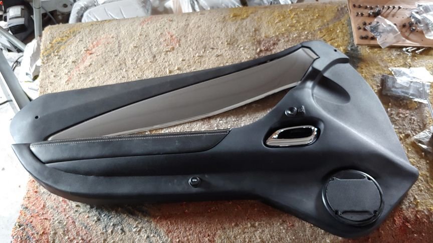

GM has used TPO for the interior plastic parts. Went through all the adhesive iterations and only found that a minimal bond can be had after heavily sanding the two surfaces and bonding with super glue (they are not all the same) while compress the glued area with clamps.
For more complicated bonding, I used a Harbor Freight plastic welder and fiberglass. Here's a near final pic of a modified 2014 Camaro door panel transformed into one for my 70 Malibu.
