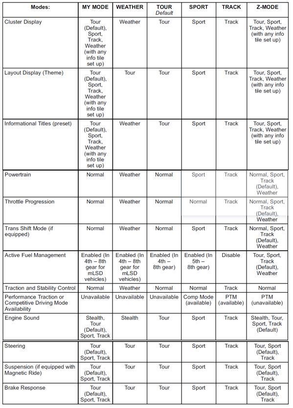

I was wondering if you order the Z51 Package with the NPP exhaust but without the MAG ride option can you still change the exhaust sound to the track mode (loudest) sound from the infotainment center?

Yes. Mag Ride (MSRC) has nothing to do with the exhaust settings.

As far as I'm aware, the only additional feature you get with MSRC on a Z51 is Performance Traction Management. If fact, Z51 with MSRC is the only way you can get PTM.
And adjustable shock damping. With MSRC, the different drive modes affect suspension damping. Without MSRC, the suspension is the same in all modes.
