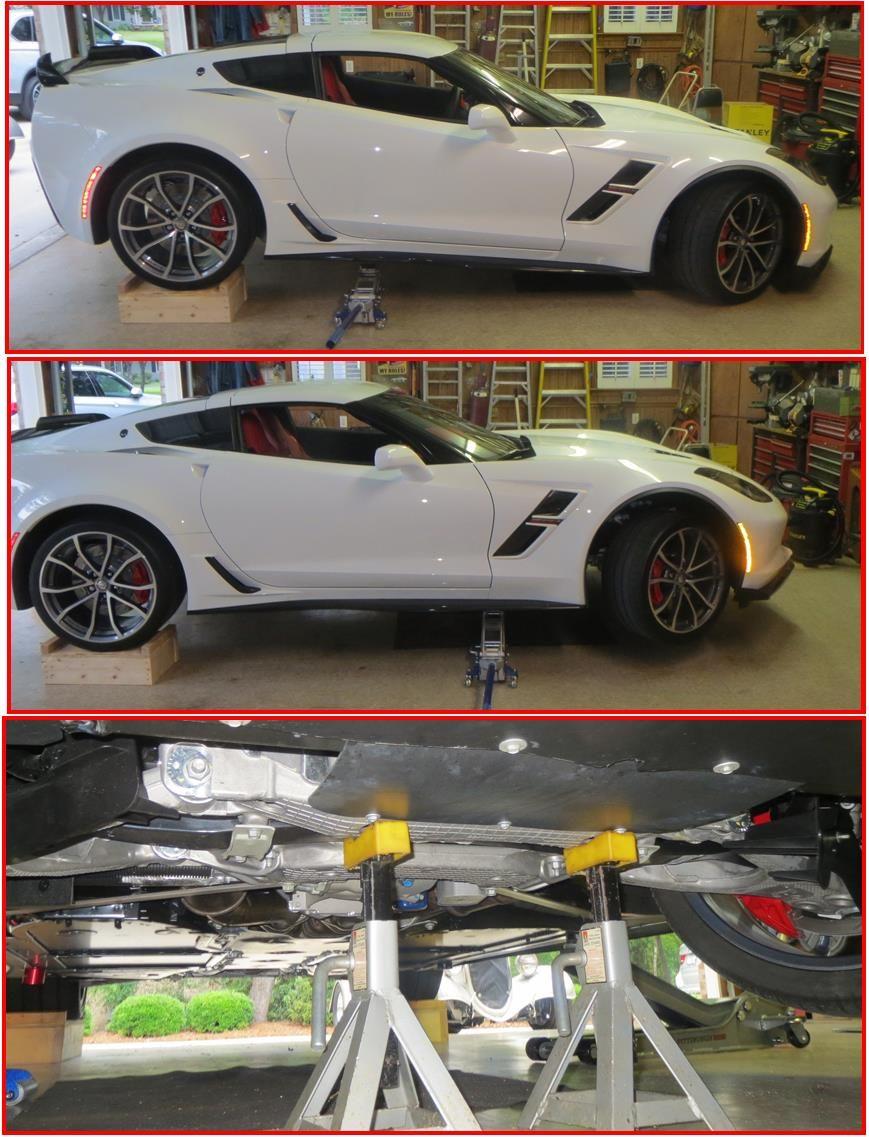

I jacked the rear of my C8 up and took this pick to show why it is important to put your wheel chocks on the other side of the car. Using the Rear jack point with the tire about 8 inches off the ground and the front looked like this.

Yep, using the rear jack point will raise the front tire! Chassis is stiff and with 60% of the weight in the rear that is what will happen. C7 was similar if you used that front jacking point- the rear wheel came off the ground, albeit not this amount!
Would not remove the front wheel or get under the front (or rear) without, as a minimum a jack stand under the front "A" arm (my suggestion NOT from GM but have used that before on many cars.)

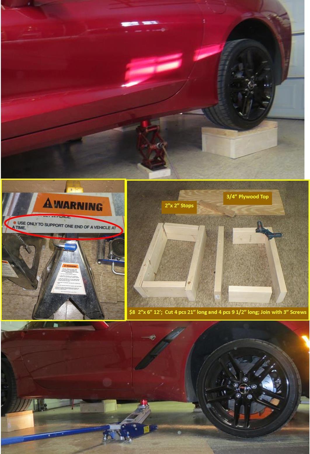

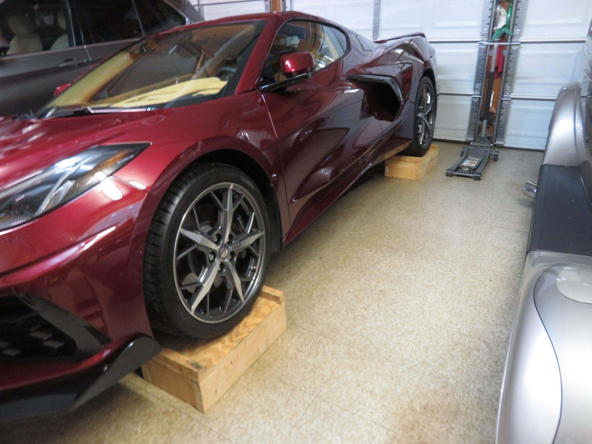

Yep, all that will work BUT if you don't want to spend the money or deal with heavy powered lift devices, I have used a cheaper perfectly safe method of lifting my two C7s and for my C8 installing low dust brake pads, side skirts and splitter. Here are some pics:
A pair of Stanchions and Jack Stands after using Jack Pads and Hydraulic Jackat the GM Frame Locations works fine
Note made my Stations for a 2014 Z51 from a 12 foot long Pine board and some plywood, <$10. For fun calculated the "Safety Factor" and even with less than prefect construction was >15. MUCH higher if well made on a flat surface. Could use a 2X8 etc if want higher. Have 12 inch high commercial Stanchions I used when building my street rod BUT requires a two step lift not needed for most work. Don't want to make your own, can buy them from ramp folks (Note, not a ramp fan.) Also note warning on one pair of my Jack Stands- USE ONLY on One End of Vehicle at a Time. I would NEVER get under a car supported with 4 Jack Stands.
For my C8 Low Dust Brake Pad install used the Stanchions under the lower "A" arm.
Two worked fine on one side for my C8 Side Skirt install.
GM Official Lift Locations Plus my suggestion for using a Jack Stand under a lower "A" Arm if needed. Avoids the need to remove the aero panels to access the cross members to use Jack stands at those locations.

I'm sorry, but the homemade stations are NOT SAFE! If you look carefully at the pic on the right, you are supporting the car on 3/4" plywood and AIR. The 2x4's are on the perimeter of the stations and the weight of the car is in the middle, which has very little support!
I would recommend you add addition support (2x4's) immediately. The entire base of each station should be solid 2x4's. Is risking your life not worth an additional $10 of wood.

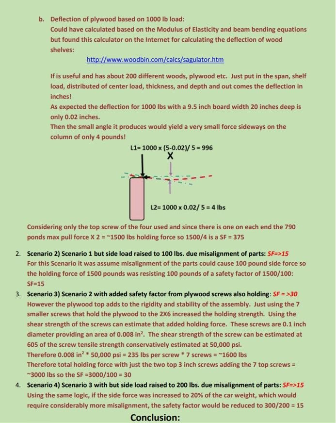

Made the Safety Factor calculations as apposed to subjective opinion!
Had that comment before and, as I said I make the calculations for fun using bending loads, deviation from perfect 90 degree assembly etc. The Safety Factor IF you use the screws I recommend (used the holding force in the pine I made mine from) and IF all cuts are square etc is >200! Considering a side load from not perfectly square construction (I defined by an angle anyone could do better) was >30. the worse case was >15. All calculations are on the last 3 pages of the 18 page PDF I made on Jacking a C8 and C7: http://netwelding.com/Jacking_A_C7.pdf
Expect some of the Silent Majority who visit the Thread (already at ~1000 versus ~10 or so posters as many of us Vocal Minority post more than once! ) may find it interesting!
BTW, the bridge you go over every day probably has a Safety Factor of ~3! AND it has a lot or air under it!!
But as I say at the end, the engineers that designed the Titanic said it could never sink so build at your own risk! BUT will bet it's much "safer" that the plastic ones you can buy or even the 12 inch high commercial ones I used when building my Street Rod! That company showed their heavy dually truck rear on them for proof!
Here is one calculation pic showing the deflection in the plywood! BTW Plywood is very strong!

Hi Jerry - thanks for posting up the calculations. You have built yourself a strong box. My concern is that if any of the screw threads ever lose their integrity, or any sudden unknown failure happens which would cause the box to lose its shape - then the calcs don't work anymore. I have very similar wooden supports, and they're solid wood. Please consider upgrading yours! Would hate to hear of an injury.

Appreciate your concern BUT it's unfounded! The deviation from the Safety Factor of >200 is from my calculations of the sides NOT being perpendicular. I was planning to use first principle calculations of beam deflection, strength of materials etc. BUT the Net is amazing! Lots of plug in the numbers etc. Found a source for screw hold force available on the net for various size and length screws in many types of structural wood. My choice is an overkill! Still a lot of wood bridges around! I have used those stanchions since 2013 when I built them. They are a way overkill.
