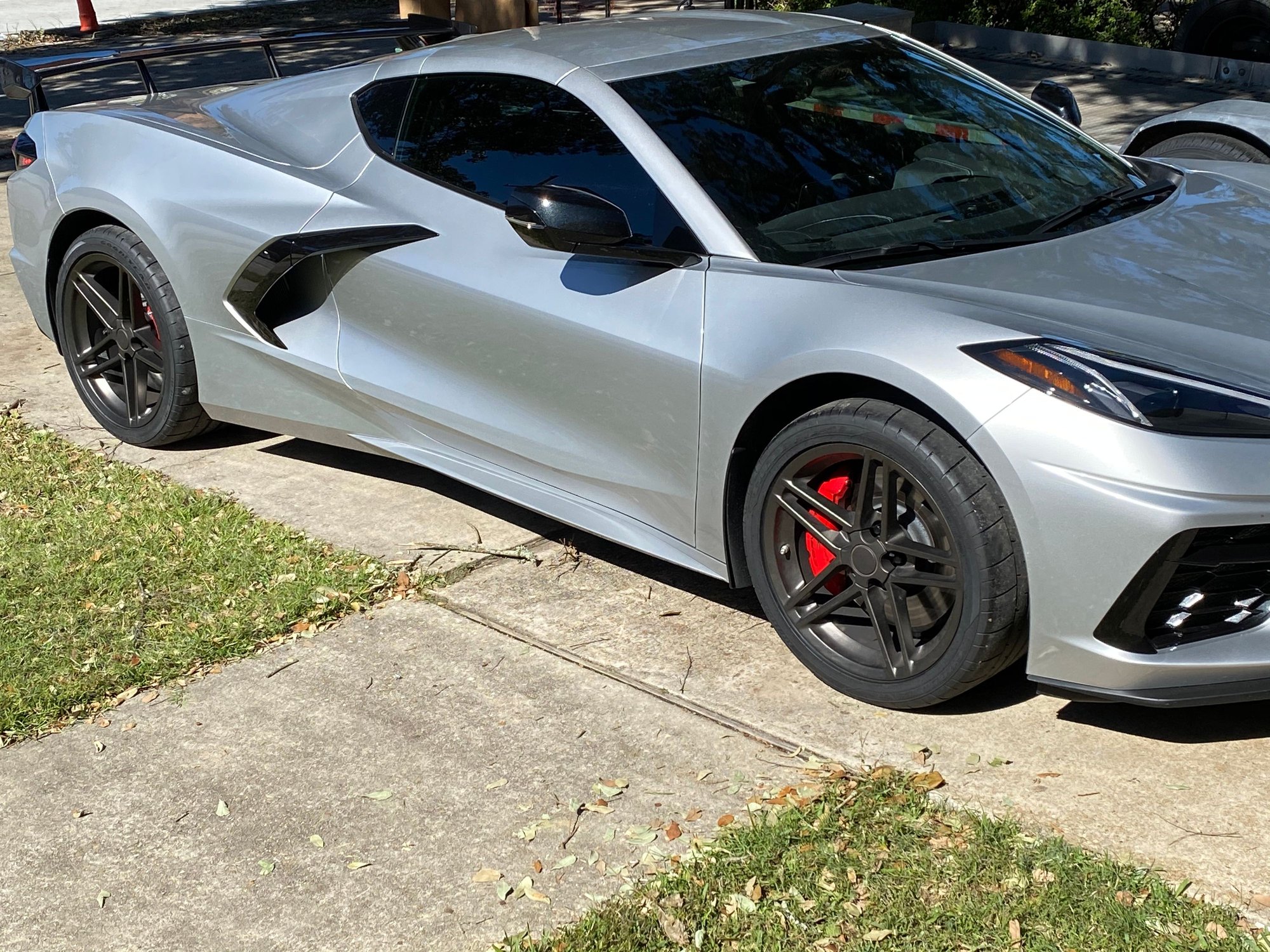

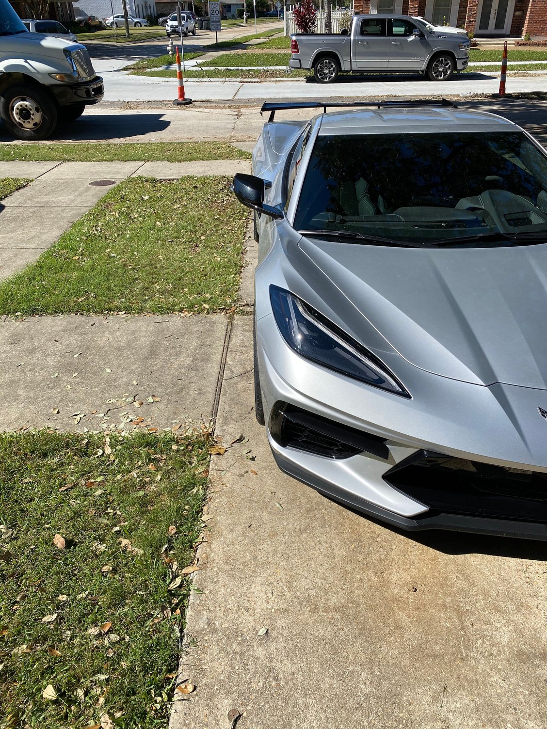

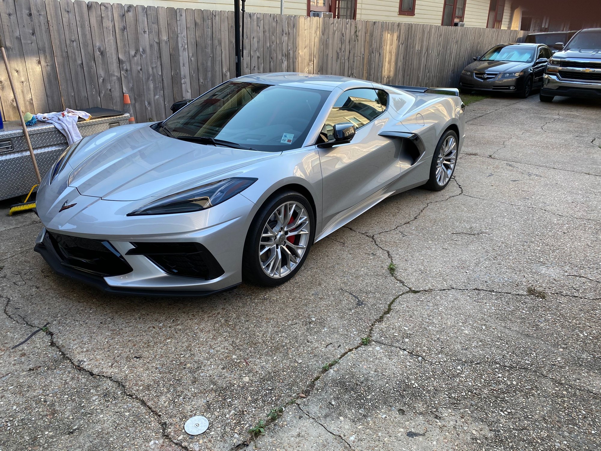

Technically the lug pattern is different 120.0 x 5 for the c8, 120.65 x 5 for the c5-c7. As far as the lugs go, there are plenty options for the 14mm with a 19 conical seat, the stock lugs will not work. The c7z front tires stick out about 3mm but they will bolt up. The .65 difference is not a issue, the tolerance between wheel studs is more than that. The fronts due rub on full lock. If you had a good machine shop they could mill 3-4 mm off the the lug face, and re align the holes so you could be perfect 120.0 but it’s a lot of trouble for a wheel known to have problems. I did however use a set of C6z wheels for my track wheels, much better fit. And a 275/325 tire

As measured with a caliper they were all off by 0.13, couldn’t tell by eye but they all tightened down to 140ftlbs and had no vibration. The other issue was the difference in the hub size. The c5-c7 were lug centric. The c8 seems to be both lug and hub centric. If I was Going to continue to use them I would have ordered a centric ring to fit the c6 wheel. Still may do that....
