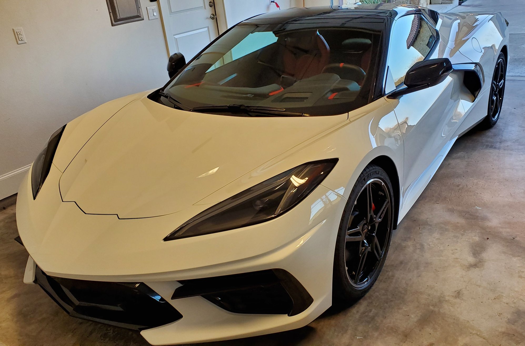

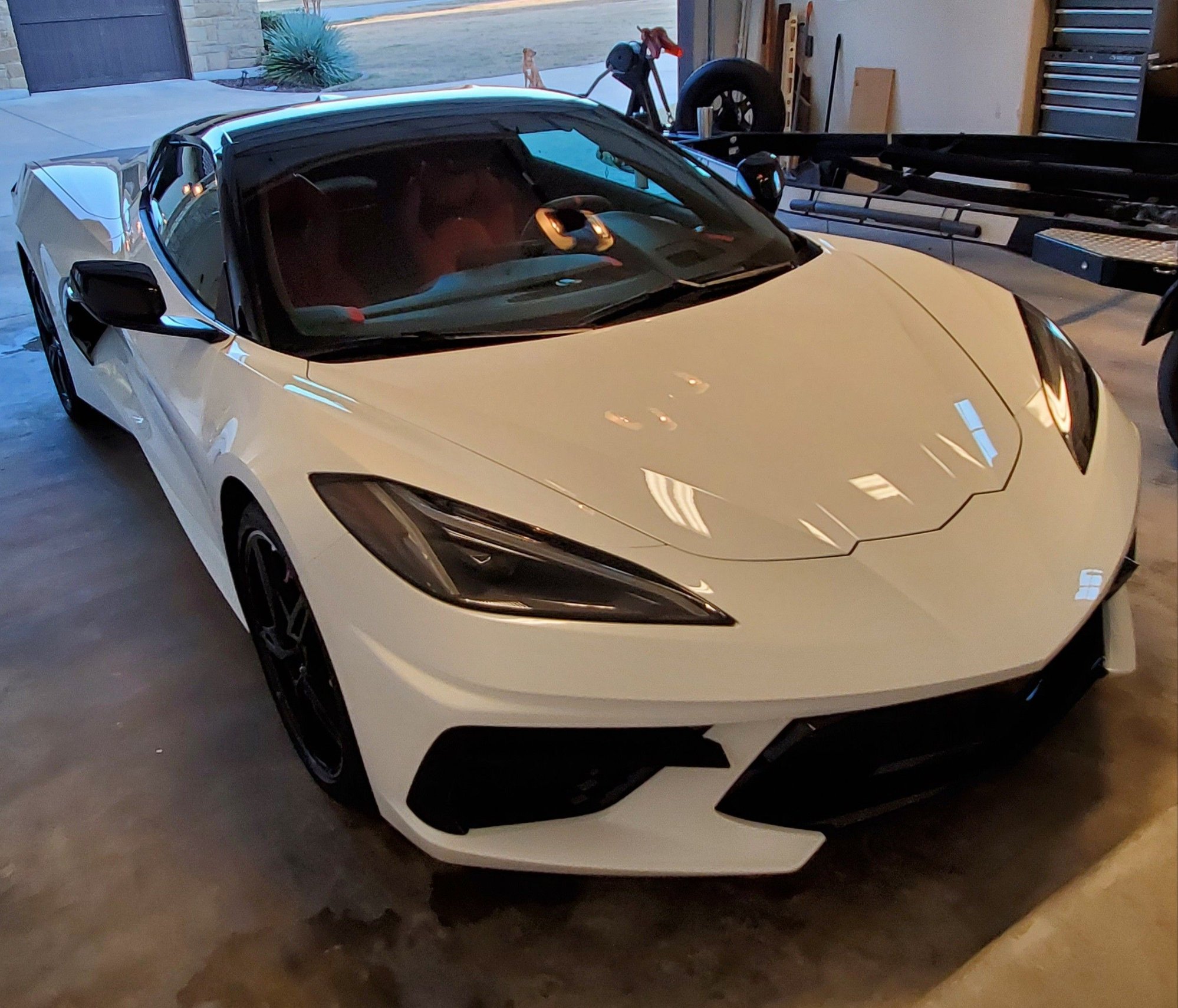

Just finished using Adams graphene ceramic coating. I did the car, windows and wheels.
I thought it came out pretty good.
