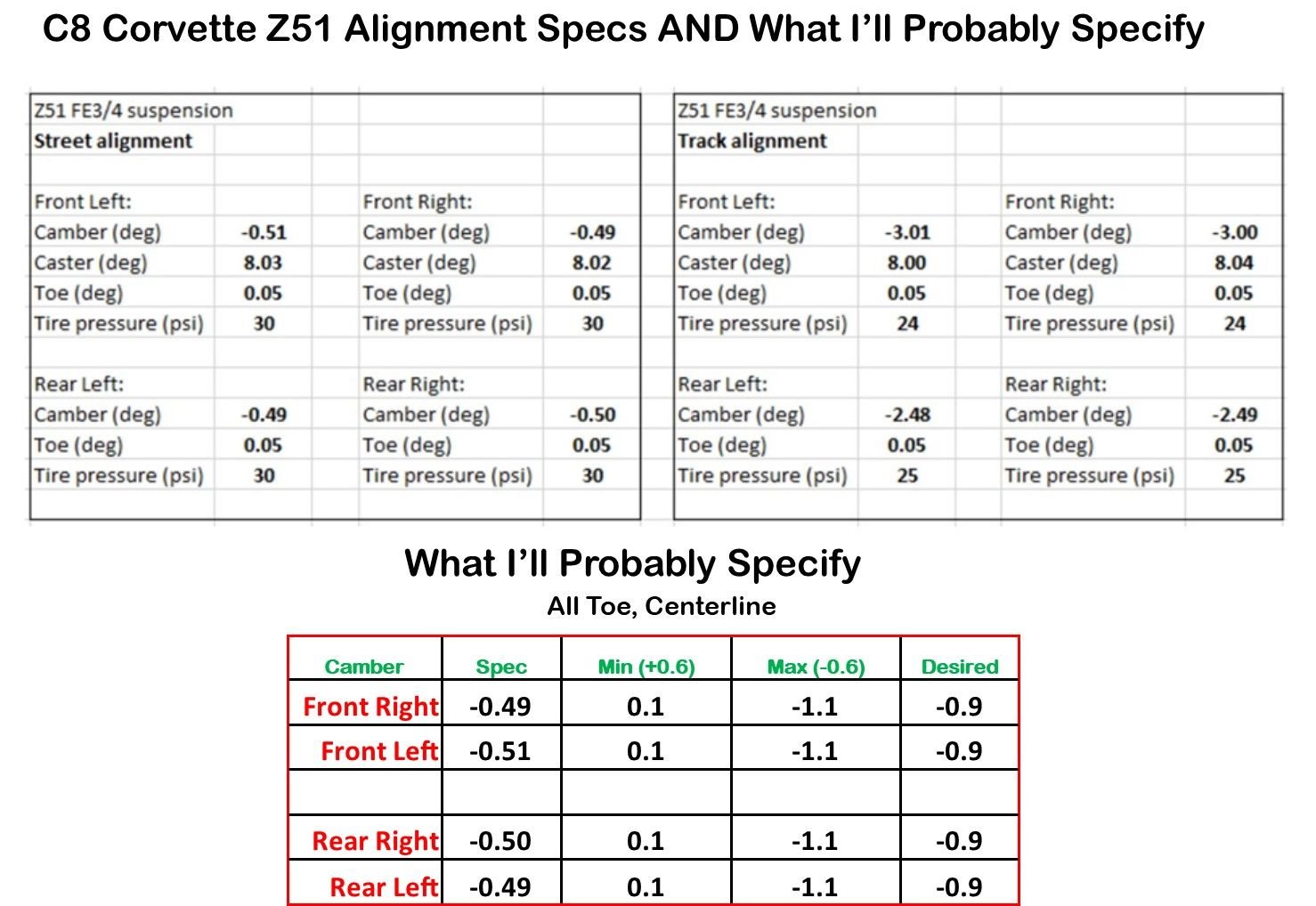

On the C6's the primary reason for tire wear was not so much the negative camber, but too much toe causing the tires to scrub. I run a track alignment on my C6Z with 1.8* negative camber front and 1.2* negative in the rear and still get 20K miles out of the performance tires because the toe settings are near 0, just slightly toe-in to give good tracking down the road.
For those of you that don't track and really don't pull near 1G in your cars, you should get an alignment that is tire friendly, with 0.5-0.8* negative camber and the recommended minimum toe-in settings. The C8 track recommended alignment for the front is ~3.0* negative which is likely to wear the tires more heavily but also improves grip and overall car balance at the edge of the performance envelope.

My issue with "Within Spec" is you can drive a truck through the GM allowed camber spec! That's all Vettes not just the C8. C8 camber is "acceptable" and will show Green on a Hunter Alignment Machine if it's between about +0.1 and -1.1. Was the same range for my 2017 Grand Sport where the rear camber spec was -0.5 to -1.7 degrees. Had mine checked at 450 miles and the rears were about -1.6, close to max. With those wide 335 section width tires thought excessive as I don't Track. Had adjusted to my desired value of -0.8.
Brought my C8 in at about 450 miles and provided the tech with the bottom Table as to my desire. Turned out all 4 cambers were just slightly above the spec centerline and I said leave it. One rear toe was out (in red) and that was adjusted. BTW if you want a "free alignment check" at between 400 and 500 miles after the suspension bushings etc have settled- DON'T ASK FOR THE FREE CHECK! They is no such thing! Just say car feels like it's pulling slightly to the right! Fact is a narrow 2 lane road has built-in road camber to shed water and all cars will pull slightly to the right. The dealer must put on the warranty slip submitted to GM, "Customer says car pulling slightly to the right!" If you want it adjusted to closer to centerline or wherever with the GM standard (NOT TRACKING) alignment spec offer the tech a $20 tip!!

The need for C8 Track alignment was not doubt driven by the suspension as well as the mild ~0.5 camber alignment set to offset the small amount of understeer built into the car near the limit.
As Tadge said, his "biggest fear" when designing the C8 was the oversteer issues with a 60% rear weight car. He said his dad drove his Porsche aggressively and he (Tadge) was well aware of the oversteer issues it had. Considering Tadge age, his dad's Porsche was no doubt of the same era as my 1967 modified Corvair with Plus 1 performance tires, headers etc. Even with parallelogram type rear suspension (changed from swing axle in 1965) you had to learn how to deal with oversteer. If exceeding the corning speed and going off the road both Corvairs and Porsches racing in SCCA had to counter steer like Tony Stewart is in the pic below in his dirt car. Had a fraction of a second to get it right or you were off the road, rear first!
Most drivers, even skilled racing FE Corvettes had to learn the difference and react accordingly. The average driver never did! As Tadge said, it took Porsche decades to get a 60+% rear weight car to be a good handler. They had to get it right the first time! They did.
Yep the aggressive Track setting of negative ~ 3 degrees front and ~ 2.5 degrees rear is no doubt needed to offset the "safe" handling built into the C8 for the average driver and create some oversteer when racing.
