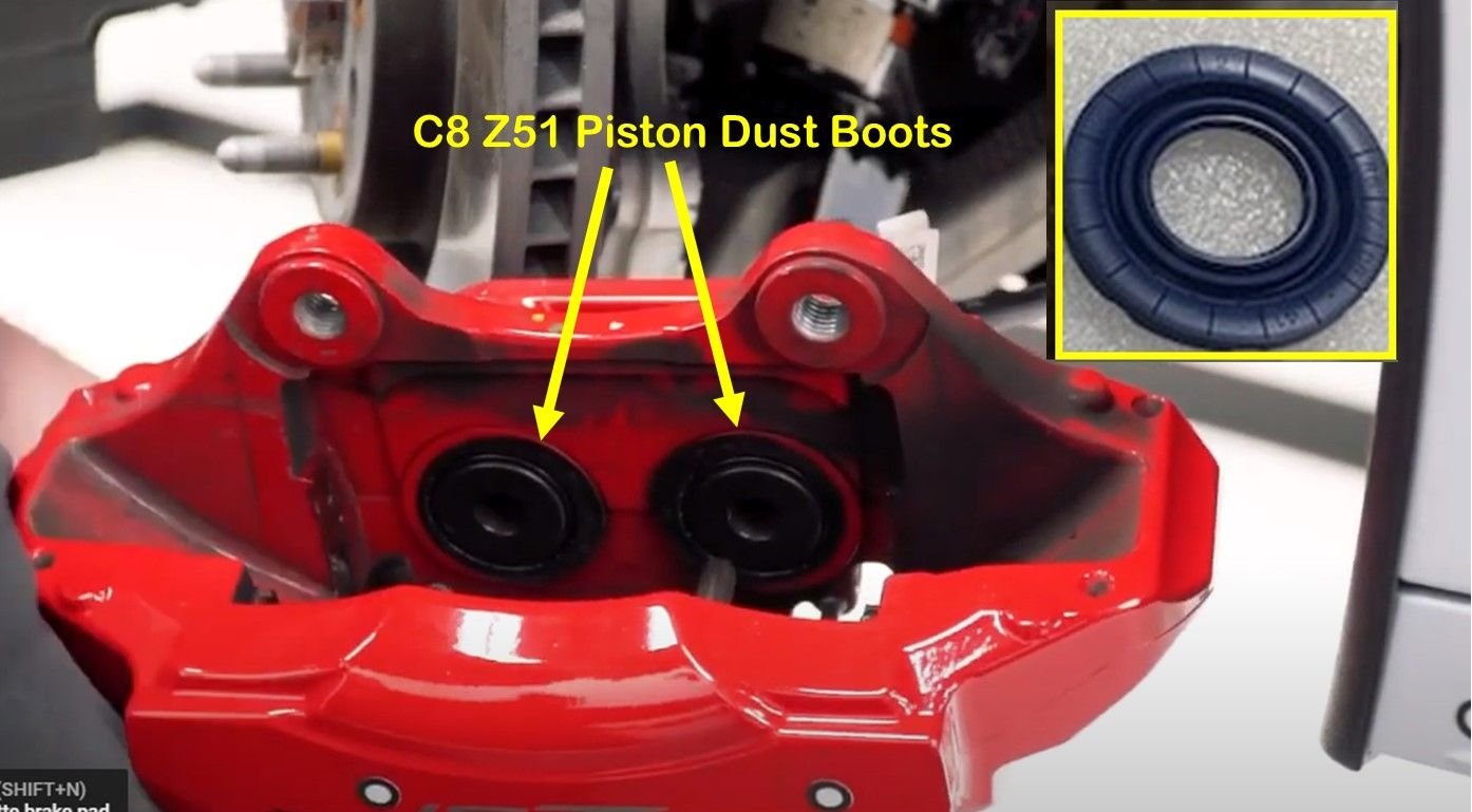

Yep, feel the same, had on my 2014 Z51, 2017 Grand Sport and now my C8. This is my detailed install Pic/Long Caption PDF: http://netwelding.com/Ceramic_Pads.pdf
It covers the first big decision with the C8, jack up very high to remove the caliper or as I did and show installing pads with calipers in place. But that risks damaging the piston dust boots when removing the front pads held on to the pistons with very strong two sided "brake tape."
PS: PDF also includes why after trying cheap Chinese pads on my GS I tossed them after 900 miles because of inferior performance compared to OEM and Carbotech, made in US pads. BTW they sell pads for many cars and 6+ race pad compounds for race cars etc for the same or a higher price. It's a $75,000+ car worth more than ~$100 for the best stopping performance than cheap, made in China pads, IMO. I show technically why they are better and quote posts from 5+ forum members who found the same.
