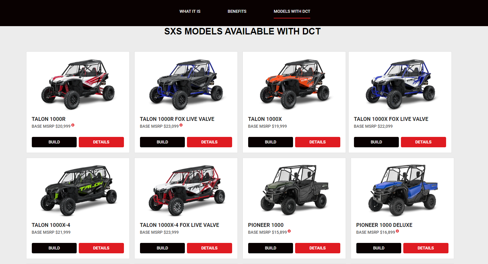

I just purchased a 2021 Honda Pioneer 520 w/ a 5-speed DCT. It's also a true ME with engine under the passenger seat. I was surprised to learn Honda uses a DCT, while every other UTV seems to be a belt-driven CVT.
Like DCTs in cars, it shifts with paddles and you can select manual-only or automatic modes. It doesn't creep at all when in gear. Shifts are very firm and lightning fast. I wish it had been available with a manual (kidding), but it'll do it's job on my property.

Originally Posted by Foosh
Interesting on the DCT creep.
That's funny, all the Honda press and brochure say the Pioneer 520 comes with an automatic transmission, not one place does it say it's a DCT. The Pioneer 1000 comes with a DCT, not the 520.

I want to hear more about the DCT that you don't have that you think you do.
