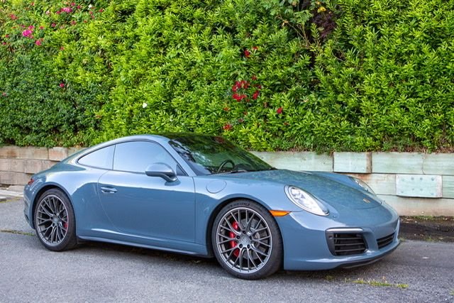

I run those tires (Michelin Pilot Sport 4S) on my 911. Recommended pressures on the door plate for the 2017 C4S are 35 front and 45 rear for all tires. I have about 8,000 miles on those tires with no indication of uneven tread wear.
