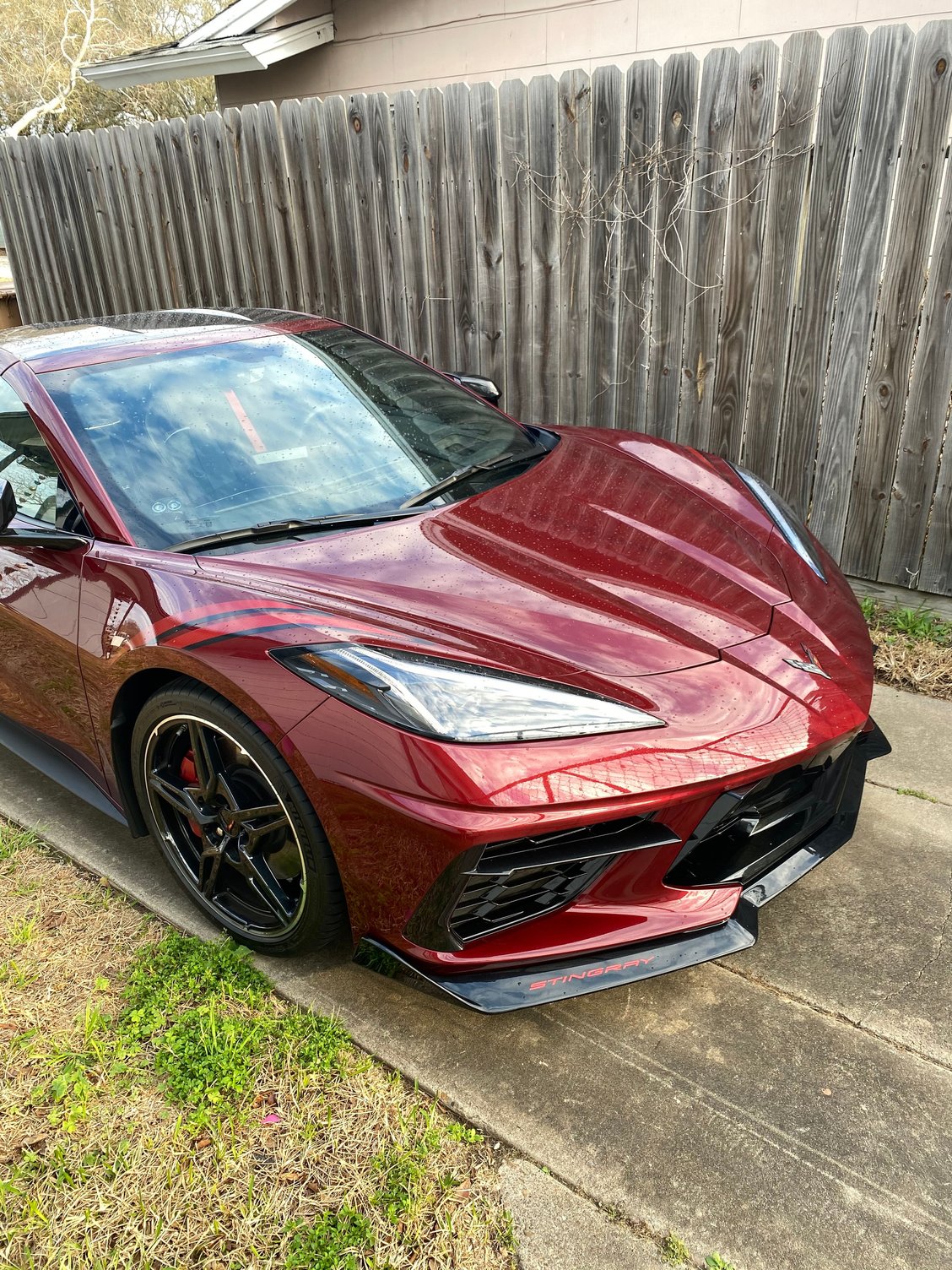

I got my C8 a few weeks ago and it was ordered it with hash marks. The more i look at them on this car the less i like them. I want to remove them. Does anyone know if they are just stickers and i can use a heat gun on very low and get the off or have they been clear coated over. Any help with this would be great.

I didn't like my color of hash marks either. Nothing like the pictures. The red did not come close to matching my calipers.
Really easy to remove. Heat gun or hair dryer and they peel right off.

^ What he said. There is no clear coat over them as they are applied long after that panel is painted.
A hair dryer and gently warming them up should peel them off with little or no residue. Good choice BTW, I've never cared for them on any of the gens.

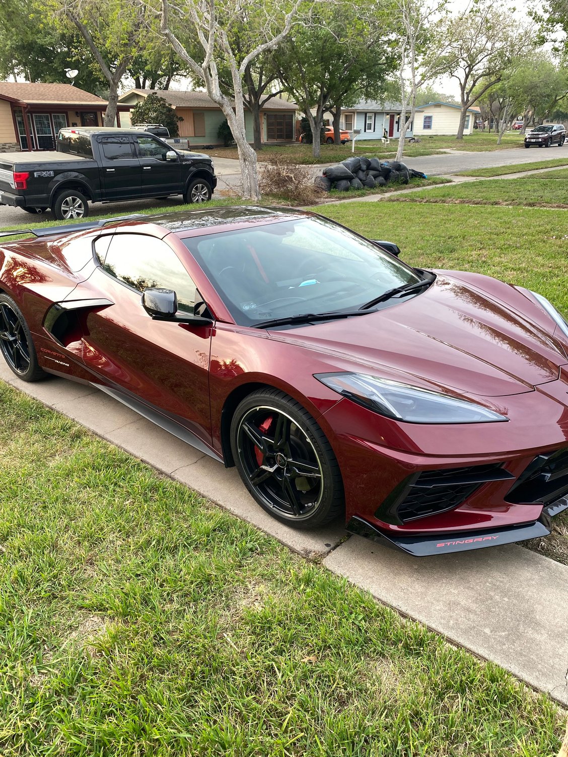

Wow that was easy. A hair dryer and 5 min and done. looks so much better.

Any before and after pics?

Originally Posted by Parrfive
Beautiful color!!! That is Red Mist Metallic correct?
