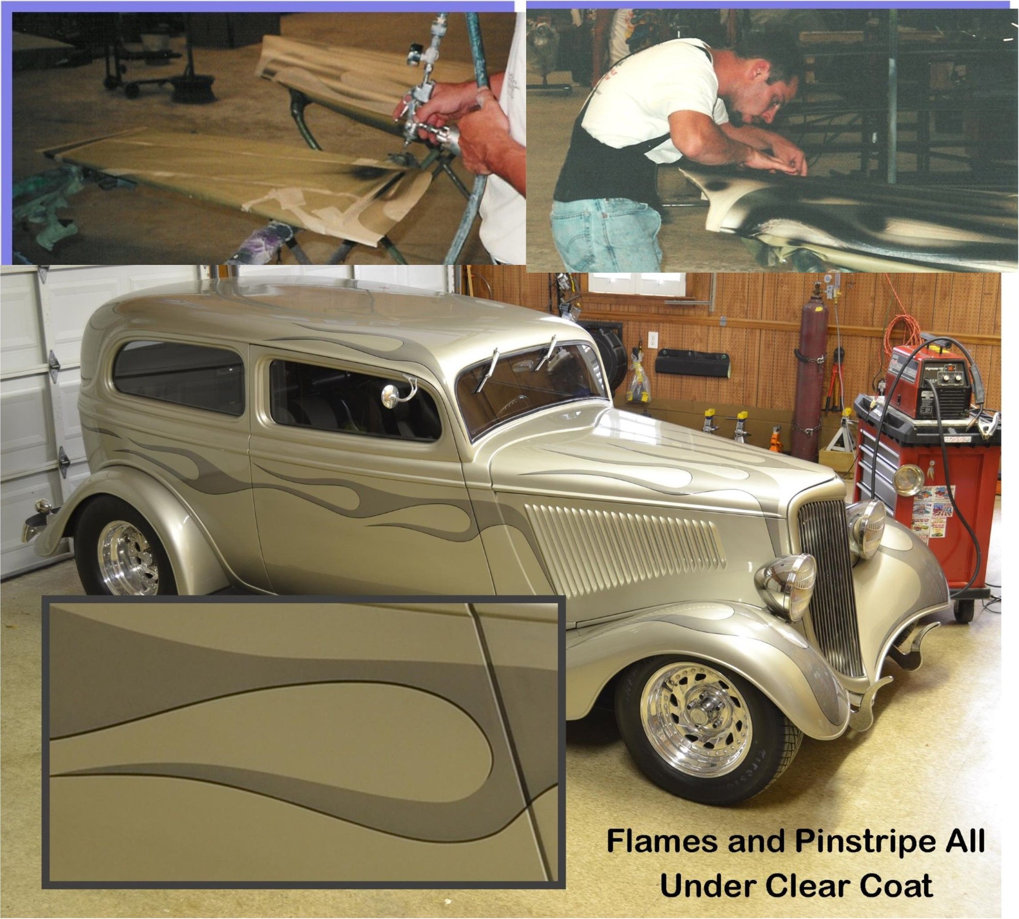

Hmm, this goes back ~20 years from when I had my Street Rod painted and wanted a small amount of each color. Just like when you go to Lowes etc to buy paint, they can match any color, so did the shop the painter sent me to who sells automotive paint. They don't BUY the manufacturers paint, they mix it from specs supplied by the paint company and GM! I'm sure it's the same today.
In my case, it was a special Silver color with two sizes of metalic aluminum flake as part of the mix. Minimum they could make was a quart, which I bought. Not cheap! Nope a body shop doesn't get paint from GM etc. They get it mixed locally!
Perhaps of interest. The "artist painter" who did my street rod masked the flames by hand. He added pin strips on some edges all done under the clear coat. Clear coat had to be put on within 24 hours of the base coat. Pic shows after masking the flames, the "pin strips" were made by spraying the flames black, applying 1/8 inch masking tape for pin strips. As soon as it was sufficiently dry (<hr) the Darker Silver flame color was sprayed! Myself with 3 others helped remove all the masking before the clear costs were applied!
