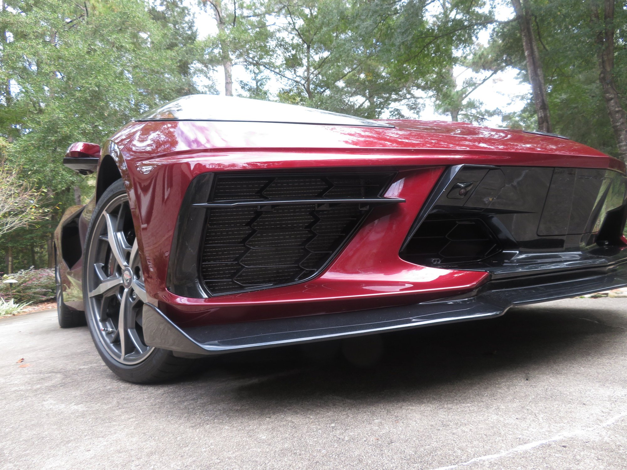

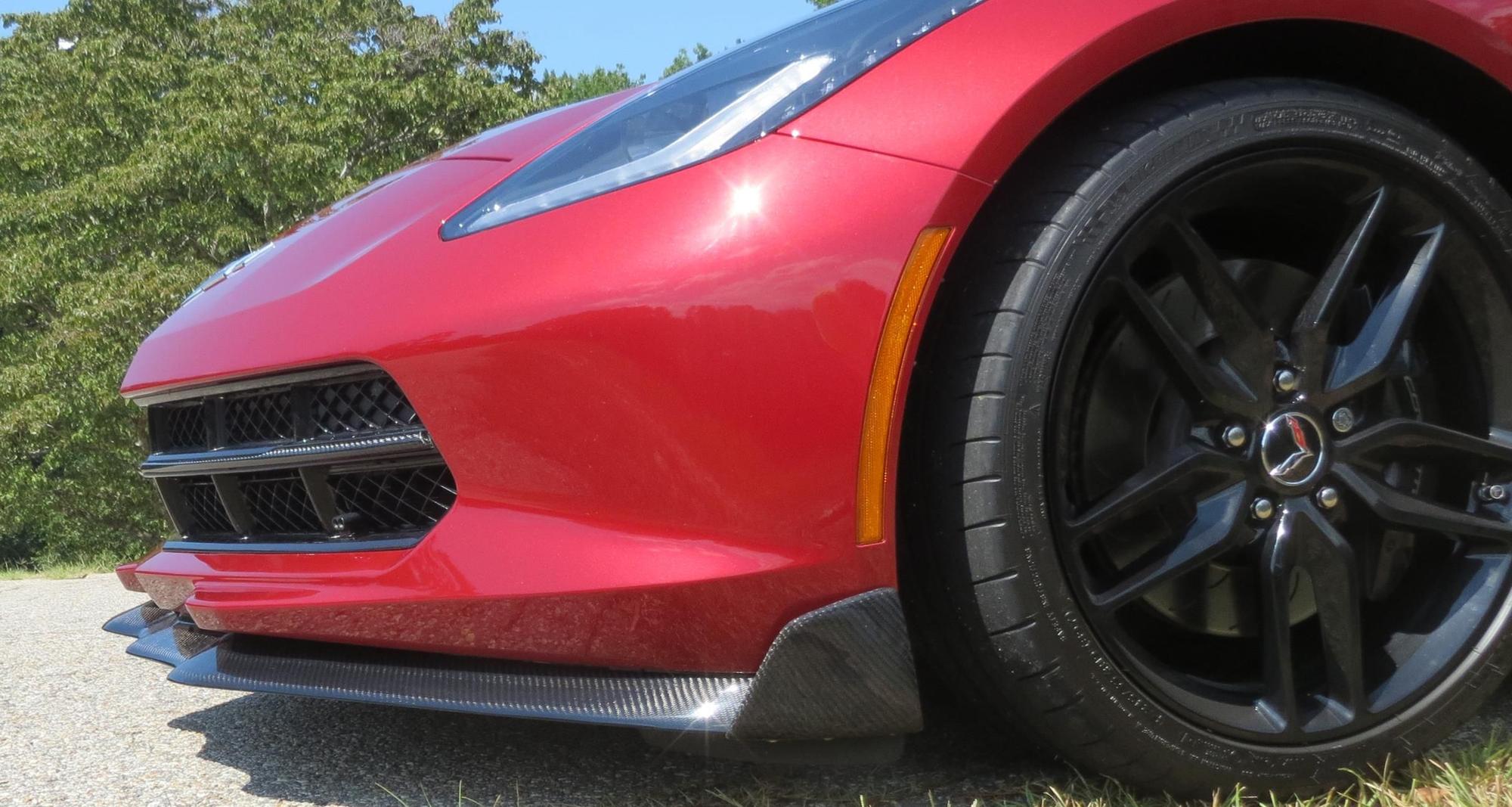

FWIW, I have the C7 Carbon equivalent to the splitter that comes with the GM 5VM Areo Splitter and Side skirts. Mine is painted carbon flash, although for $~100 more you can get the top layer as real visible carbon fiber cloth (had similar from them on my 2014 Z51.)
Only the OEM screws holding it, can't see where double sided tape would help as lots of screws! And they are not very tight nor should they be reinstalled tight. I used a hand ratchet, quicker than a battery powered wrench. Takes little room so could install without lifting.
Can be done without lifting the front, if desired
C7 Carbon (Platinum Forum Vendor) Splitter with real visible carbon cloth outer layer on my 2014 Z51.
