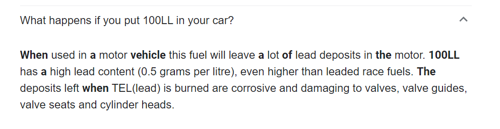

Based on this 3 second Google search, I suspect it would a mistake of paramount proportion, but it's your car.

I believe that the lead used in motor fuel ruins your catalytic converter as well. I wouldn't risk it.

Agreed, it would trash the cats.

Do. Not. Use. Leaded. Fuel.
You can get 100+ octane no-lead fuel from VP Racing Fuels. That's the way to go if you want to self-blend for higher octane.
