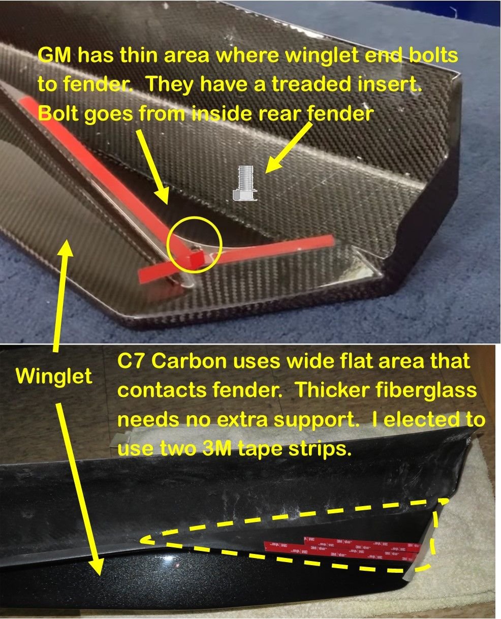

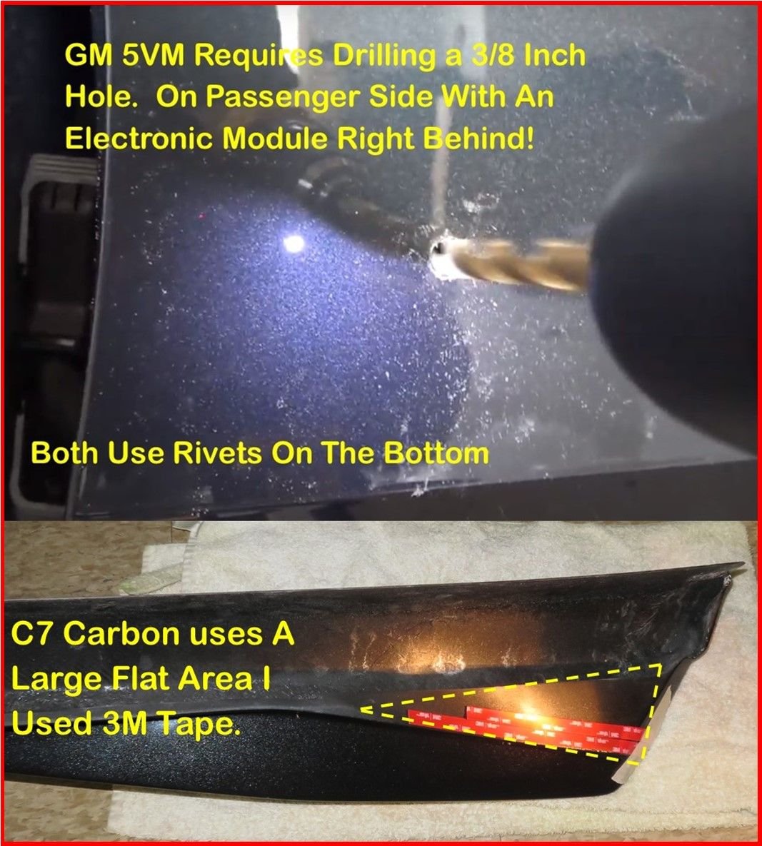

Your choice BUT C7 Carbon (a platinum vendor) does not use any 3M tape. In fact unless instructions changed they don't suggest that it's use at all! They like the GM product use 7 rivets in holes drilled under the rocker panels.
However the GM product is made from thin carbon fiber. It is more flexible than the C7 Carbon made from thicker fiberglass. It not only requires drilling a 3/8 inch hole in the rear fenders for a bolt, it specifics a very strong 3M adhesive along the edge of the long side skirts. In fact the GM product comes with 3M tape that I was told is to hold while the 3M adhesive cures. Since I used a similar product to install my street rear windows I had to support those in place overnight as that adhesive cured.
BTW If you want carbon fiber finish, C7 Carbon offers for a few hundred dollars more real carbon fiber cloth on the surface. It's not faux carbon fiber look-a-like.

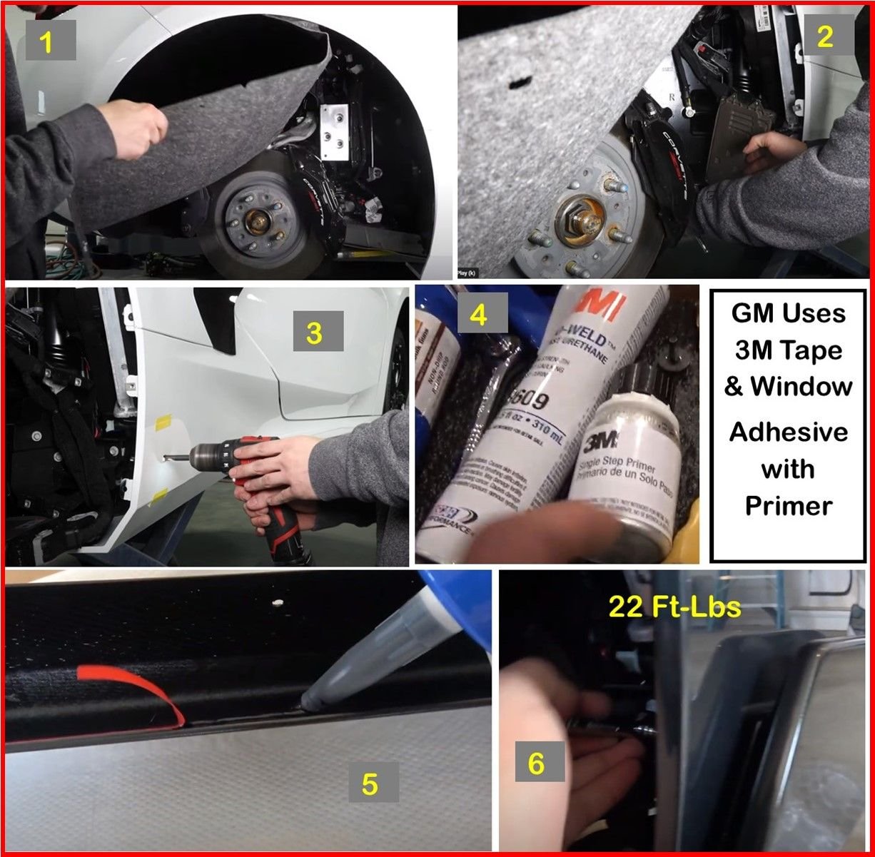

Here are some pics of my very detailed install that includes (because I investigated) details of installing the GM 5VM. This is an 11 page Pics/Long Caption How To that includes pics of the install of the more complex GM's carbon fiber 5VM is that PDF: Side_Skirts.pdf (netwelding.com)
GM requires drilling a hole in the fender for a bolt. C7 Carbon does not as it's less flexible thicker fiberglass. Note I added the small amount of 3M tape as probably belt and suspenders. I've had installed 4 months and there is zero movement. The majority of the strength holding both are the 3/16 inch rivets and a factory bolt under the rocker panels.
Good pic showing why GM product requires a bolt and the very strong 3M adhesive (which comes in a tube like caulking.) Note how tin the GM carbon fiber edge is. Some of those areas are where GM required a strong adhesive be applied.
This is a pic from my PDF outlining the steps to install the GM carbon fiber product. The text of each step is in the PDF.
Pic of my 2014 where I installed a C7 carbon splitter with a top layer of real carbon fiber cloth over fiberglass. Matched my OEM CF roof and other CF I added.

Joe,
Perhas you did not read my PDF or look at the pictures of the backside of both products. In fact the PDF discusses a conversation I had with a company who makes a copy of the GM product as that was my initial plan installing the carbon fiber GM product. Discussed that the reason for the bolt was the method of manufacture of the thin carbon fiber. It’s very flexible because it’s so thin a section. I posted that pic again . The C7 Carbon has a large flat fiberglass area that is ridged, not thin flexible carbon fiber. In fact the difference is NOT just in that area where frankly even the 3M tape I added is probably not needed. IMO the real issue with thin carbon fiber sections on the long edges.
You MUST use the GM recommend 3M adhesive that you buy separately in a caulking type tube. . That is a PIA if it's anything like the window adhesive I used to install my rear street rod windows. There is a YouTube video of a fellow installing the GM 5VM and he properly warned you must open the doors as it cautions it's toxic! May be why we have forum posts from GM 5VM installs by dealer who didn't use the 3M adhesive (it's NOT SUPPLIED with the product but is clearly indicated in the GM instructions) and they had movement. Mine have been installed for >4 months and you can't budge their thicker ridged side skirts!
I calledC7 Carbon! The young lady who answer was very surprised. She said not just for the C8 BUT for all their products they DO NOT EVERY recommend using only 3M Tape. I was very impressed about her knowledge of the installation! She said they do not supply the 3M tape but if folks want to use it in that flat area they can. Their Technical fellow, who was out that I have communicated with since 2014 is also a great guy and very knowledgeable.
As noted in my post with a pic, I bought their splitter in carbon fiber for my 2014 C7. I also bought their Rear Diffuser for my 2017 Grand Sport. Great knowledgeable folks and great products from my experience!
Install of GM 5VM carbon fiber side skirts from my PDF. Details of each step are outlined in the PDF from the GM instructions. The thin carbon fiber is flexible and GM supplies 3M tape along the sides. They require a very strong 3M window adhesive along those sections. The 3M tape holds them in place while the adhesive cures.

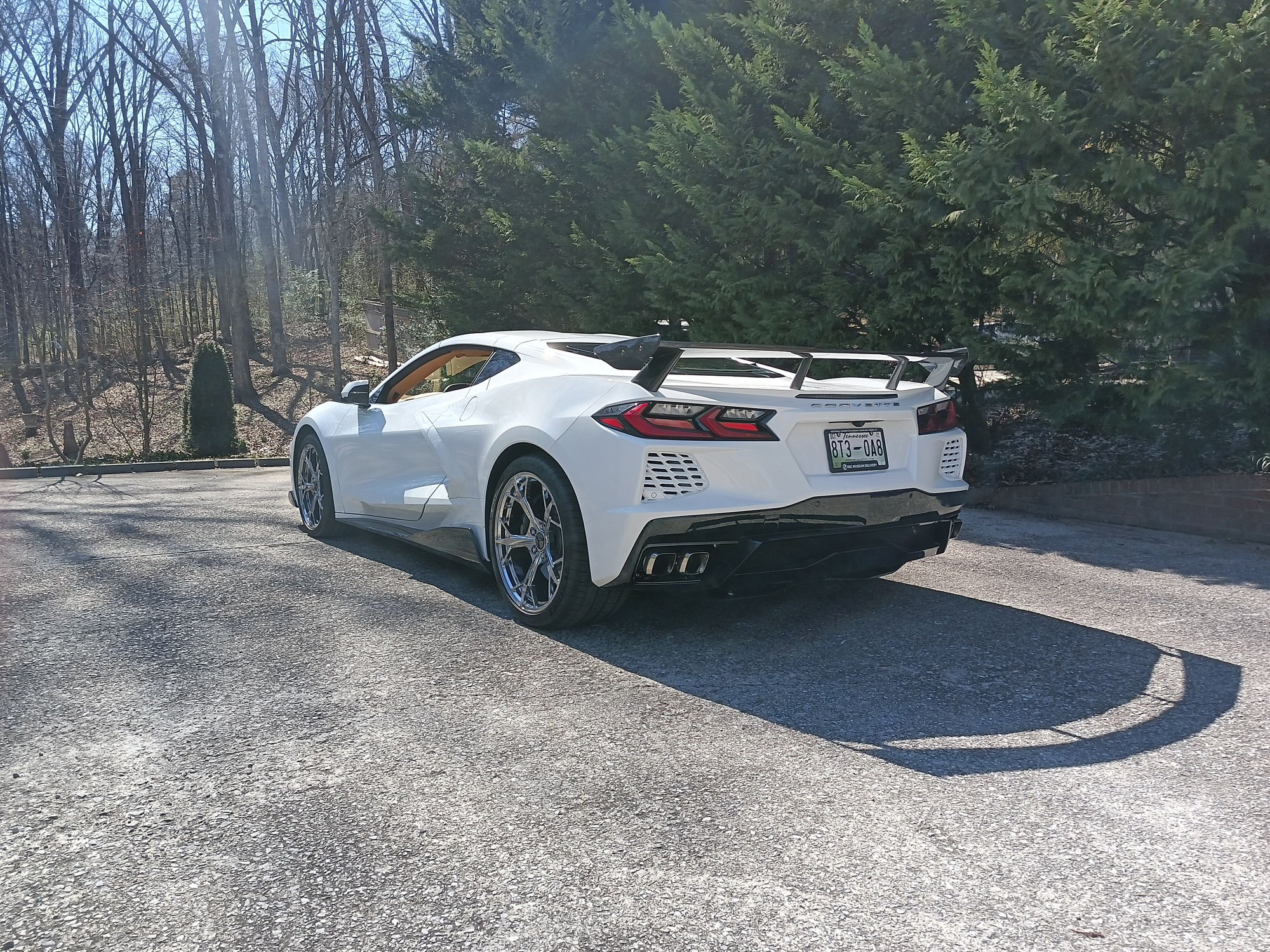

It's up to you if you want to Drill/Bolt or use Double sided Tape.
If you want all layer Carbon Fiber, them AGMotorsports is to my knowledge the only MFG doing this. It's mid priced between GM's Original 5VM kits, and Single Layer CF or Composite. No comparison strength wise. In some cases no comparison looks wise, compared to GM 5VM top layer CF 'V" shape CF layup on splitter Vs one direction on some most of the Single layer CF offerings.
I was around CF parts on A/C for 20 years. I went with AGMotorsports all layer CF for it better strength and V CF layup. Those parts were the 1st Aftermarket parts to be installed by NCM. Had to take them up prior to my build being completed to show them the quality of parts before they agreed to install them.
Also have their all Layer CF HigWwing/spoiler that has 'V" shape center layer also, along with CF Tips.
