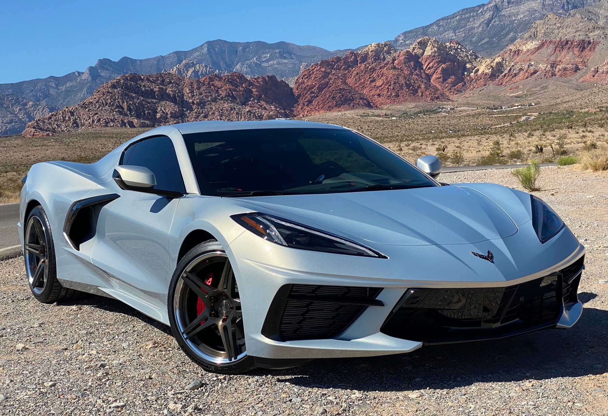

No issues on my lowered C8 with 20/21. Not once has it rubbed or acted differently than stock.
Wow that looks good! I assume you went wider in back - do you feel like you are getting better traction/ launches? Thanks 👍

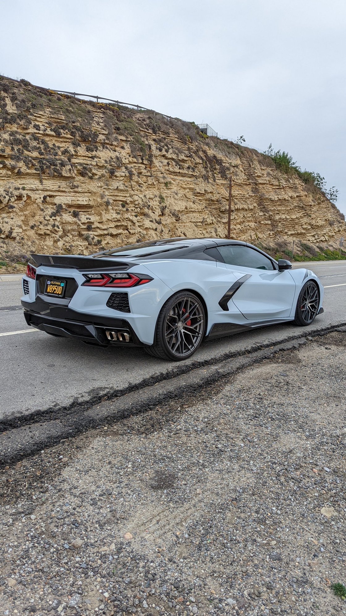

Originally Posted by Walt White Coupe
Just from an asthetic standpoint, I think that the combination looks ugly. Too much wheel and not enough tire. And there is the issue of tire availability and the problem of increased risk to tire/wheel damage from pot holes and a rougher ride.
So I went a different route. I have 20x9 fronts and 21x12 rears, however, I have 255/35/20 fronts and 325/30/21 rears. I have the FE1 suspension so no ability to lower unless I purchase aftermarket lowering springs, which I didn't want to do. I did the math and the higher profile tires fill the gap perfectly and take care of the issue you mention, too much wheel and not enough tire. No issues at all.......there is a small difference in actual speed compared to indicated speed, but the ratio is essentially the same as stock so no issues with traction control or anything like that.
To 20"/21" Wheel Setup

Here's another angle to show the gap better......
I think it looks good, and if you're happy I'm happy. But that's an extra 1.2" diameter up front and 1.5" diameter in the rear. The rear tires are going to have 38 fewer revolutions per mile than stock (+5.5% circumference). I ran a 1" smaller tire in the past and my speedo was off by 4-5 mph at around 70 (based on GPS speed). But like you, no other noticable changes (besides being lower).
Old Oct 12, 2023 | 04:47 PM
  #40
winders's Avatar
winders
Joined: Sep 2023
Posts: 1,520
Likes: 1,604
From: Franklin, TN
SemiFighter18's car is .6" taller in the front and .75" taller in the rear. Talking about going the wrong direction!
