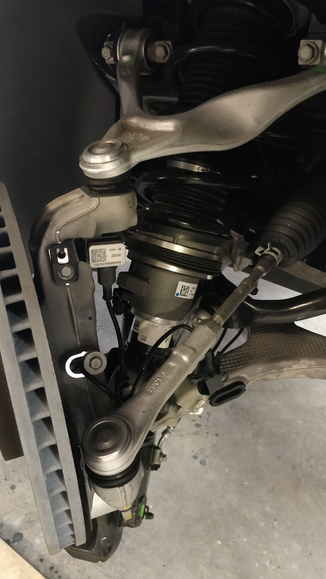

1) The rear coil overs were NOT easy to turn as others have said they should be. I had to use a spring compressor tool. (they are cheap, buy one). Once compressed, I was able to get the collar adjusted and I used a marking on the strut to measure off 0.5". By far, the rear was easiest.
2) I have a Z51 with front end lift and MSRC. The front was a bitch. You have to entirely remove the front struts. I used the paragon lowering collar (0.75" drop) and depinning tool. The instructions on the depinning tool were non-existent and there is a little trick to it, would have been NICE to have a blown up illustration of how it works. I have a lesson learned too for re-installing the pins into the MSRC connector! My struts wouldn't come out after removing the bottom bolt and putting as much downward force on the rotor as we could produce. Might have been able to make it work had we attached something to a wheel stud and then put a board on that and stood on it or something. We just gave up after elbow grease wasn't working at all, and removed the upper control arm. Be careful, there are washers behind it and in front of it that have to go back precisely in the same locations OR you will mess up your alignment. Once struts are out, you have to disassemble them and will also require a spring compressor.
3) The banjos for the hydraulics are pretty tight as far as the hose/line is concerned once the car is up on a lift and lowered. I have a little concern over it potentially cracking the metal tubing fitting/transition area because of the tension on it. It made it hard to re-attach the banjo fitting bolt which has a fine pitch thread when installing the modified struts. Had to lift up on the rotor a little. Was quite a bit concerned about possibly cross threading that strut. BE CAREFULL HERE, haste makes waste. I think you said no front end lift, so your procedure would be different.
4) I might have been able to get more downward force on the front control arms if we had the vehicle raised higher on the lift. I chose to keep it LOW and low enough to support the rear with some additional jack stands. I don't see any way you could accomplish this with the vehicle only lifted one wheel at a time because you would be fighting the sway bar. You need the entire vehicle on a lift.

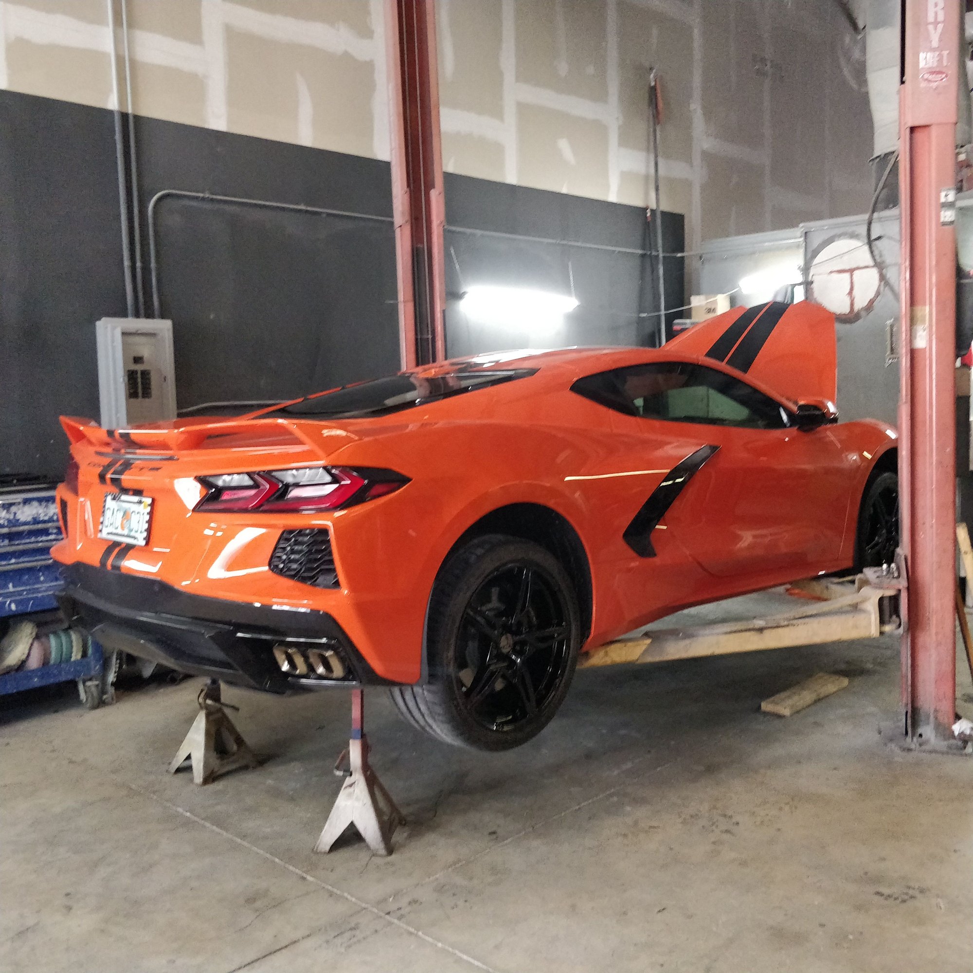

I bought the Paragon kit and lowered my 2021 z51 convertible. I had it done (Aikman Performance just outside Austin) and they were cool about me hanging around in the garage and watching the operation. It was a significant effort, I applaud anyone who got this done without a lift, I'm amazed you could do it.
I love the look, super happy with it, but unless you are a skilled technician I recommend taking it in to someone, hopefully that has done one already! (Aikman had just finished one up!)

The hard part was fighting with the strut trying to get it out. Not sure why, but in my vehicle instance two relatively heavy men couldn't put enough force to get the strut lower control arm low enough for the strut to clear. I think if we had a wheel mounted on the other side it might have helped put some extra downward force on the sway bar. All my wheels were off getting powedercoated at the time however.
