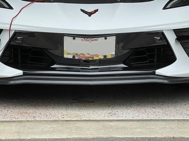

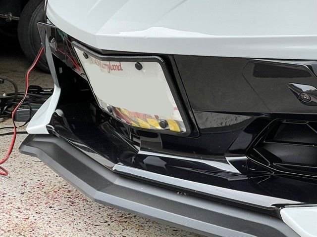

I posted one recently, using a bracket that I made. This is another ,using a replacement Aero Plate. This is for folks ( I am one of them) that for whatever reason want to mount a front license plate, and are considering their option. To summarize, there are other methods posted here and shown in videos on the web. Options I have seen posted include 1) remove the Aero Plate, drill holes in the bumper where the four rectangular bosses are, and mount the plate there. Many do this, but some don't like it because they don't want to drill any holes in the bumper even if they are covered. 2) use the gm supplied mounting bracket which in the opinion of many (including me) is not attractive and can be better done other ways, 3) remove the aero plate and replace it with a new custom bracket (my previous post was an example of that), 4) dont mount a plate, take the calculated risk of being stopped and possibly a fine (accepted as a corvette tax for the benefit of running with the Aero Plate in place, 5) dont mount a plate but carry a copy of a bill that was proposed but never passed to allow deletion of the front plate in states that normally requires it and claim you are out of state (I never fully understood that one since you have a rear plate), and hope the officer buys it, 6) drill holes in the Aero Plate and mount it there (which is the subject of this thread). Some also offered the idea of a wrap like thing that is a picture or replica of your tag.
So, to implement this solution I obtained a spare Aero Plate - and kept the one that came with the car originally, untouched. The Aero Plates are marked differently on the back. I show the difference in the photos. The replacement was made in 2019. The original with the car was made in 2021. I drilled holes in the Aero Plate for the license plate mounting screws - and inserted stainless 10-24 rivnuts. I also drilled holes to secure the Aero Plate in place using the existing mounting holes for the GM supplied bracket. After some experimentation it did not seem that the plate was secure enough with just the existing tabs that hold the Aero Plate in place, for the purpose of mounting a license plate. I also wanted a clear cover for the plate (and some have pointed out that in Maryland, even a clear cover is disallowed, but I did it anyway. I cut one out from a piece of thin clear plastic. The license plate and the clear cover are held together with vinyl door edge trim. The plate was not pre-bent, It just curves when its mounted in place. I used nylon screws, and hinged screw caps for #10 screws. Someone mentioned that my previous solution sounded like a lot of work. This does take a little time - maybe a couple of hours. I consider it a hobby.
original on the left
markings are different on the back
stainless rivnuts inserted. Its not the plate that came with the car. They may look like they are not lined up right, but they are.
clear plastic cover for the plate. edges are a little rough but they are covered by the edge trim.
Final product - front view
final product, side view
