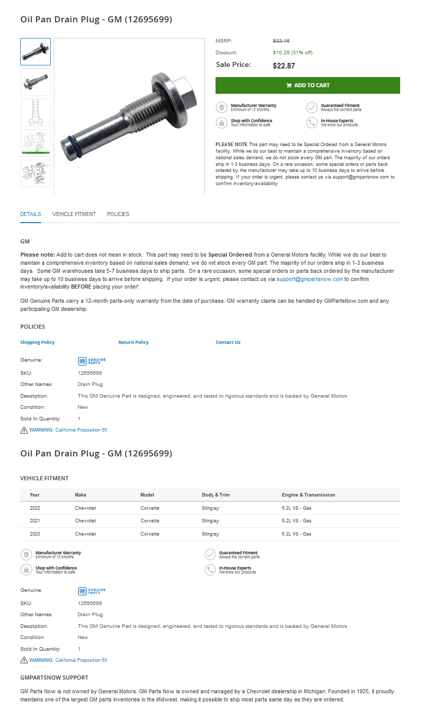

Here it is, from another post on this forum.

$10 for an O ring. Wow!
In looking at the pictures, I believe the O ring on the drain plug shaft is $2.24, still not cheap, but better than the $10 sealing gasket at the bottom of the shaft.

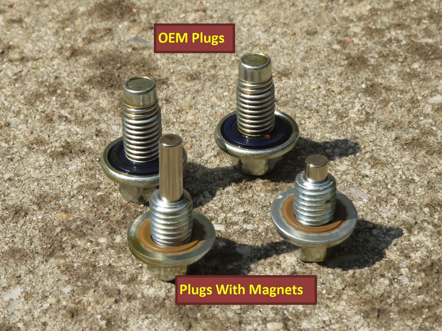

FWIW, the one on the bottom is a sealing gasket as you note, not an "O" ring. Same as GM has used for years. Pic below is for my C7s. They don't usually leak. The high strength magnet drain plugs I used for my C7 dry sumps also used a similar gasket that was more easily replaced. I still have a package!
Not doubt the GM "O" ring at the end is adequate but if you wanted to buy a better material, Viton would be the choice. Used that material on my Corvair pushrod tubes as the cheap OEM "O" rings would harden and leak! Measure carefully and buy several. However not worth messing around as $2.47 pretty cheap! Shipping will cost far more!
