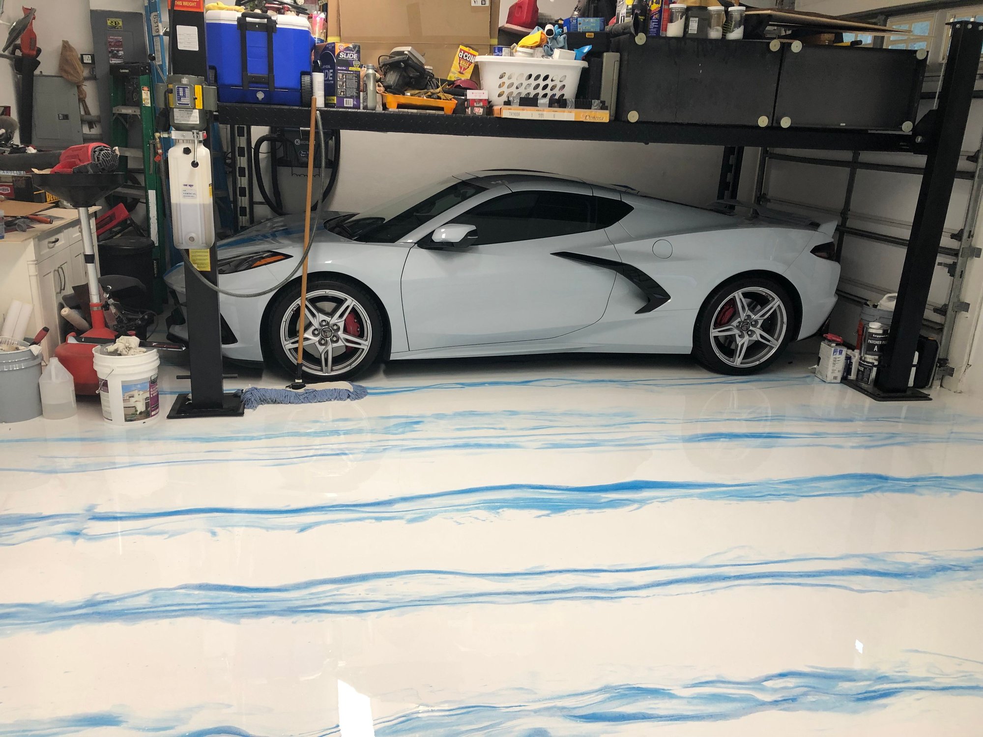

The first half of the garage make over is finished. Next Friday, cabinets go in and I get to put away the mess. The color choices were to mimic the C8.

That’s gorgeous. What product was used and did you put additives in it for the design?

Epoxy primer. White epoxy base coat. The blue is a blue metallic powder in an epoxy with alcohol mix that is spread with a squeegee to make the desired pattern (the installer walks on the wet epoxy floor with spiked shoe platforms). That dries for > 24 hours and then a clear epoxy top coat is applied. The base coat and accent comes in a lot of colors. The installer starts the process with a large diamond grinder to rough up the surface. My garage had to be done in two stages since I was not going to store the work cabinets and lift outside the garage. The C8 side was done first. After it cured, the stuff was moved back to the C8 side and the other side was done. That has a drawback in that there is a demarcation between the two epoxy coats. But you don't notice it unless you are looking.

Lol. I thought that was the first step and the blue was some kind or glue or primer!

LOL The second half is the cabinet installation

I have that same lift. Mine always looks that way. It's become a junkpile.

Floor looks great! Only C8 I have seen with blue stripes, are those factory or after market?

I had those done by my detail shop, Sage Auto Spa in Lakewood Ranch. They are my school colors - UNC. The material is by Avery
