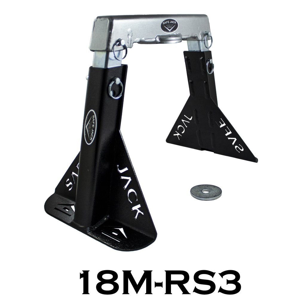

RennStands by SafeJack do exactly what you want. Check them out. The jack stand goes right where you jack it as part of the jack stand goes on top of the floor jack.
I just sold my pair today, as I have a QuickJack now. Google them. I can't post a link to them as they are not a vendor.
You pick the correct adaptor lift plate that sits on the top bar and has a pin on both sides. It goes into the same hole on the car that you would put your lifting puck, but this goes there instead as part of the top, hormonal bar. Once jacked up, you assemble the two side plates with pins and lower your floor jack down and remove it. SIMPLE, great design.

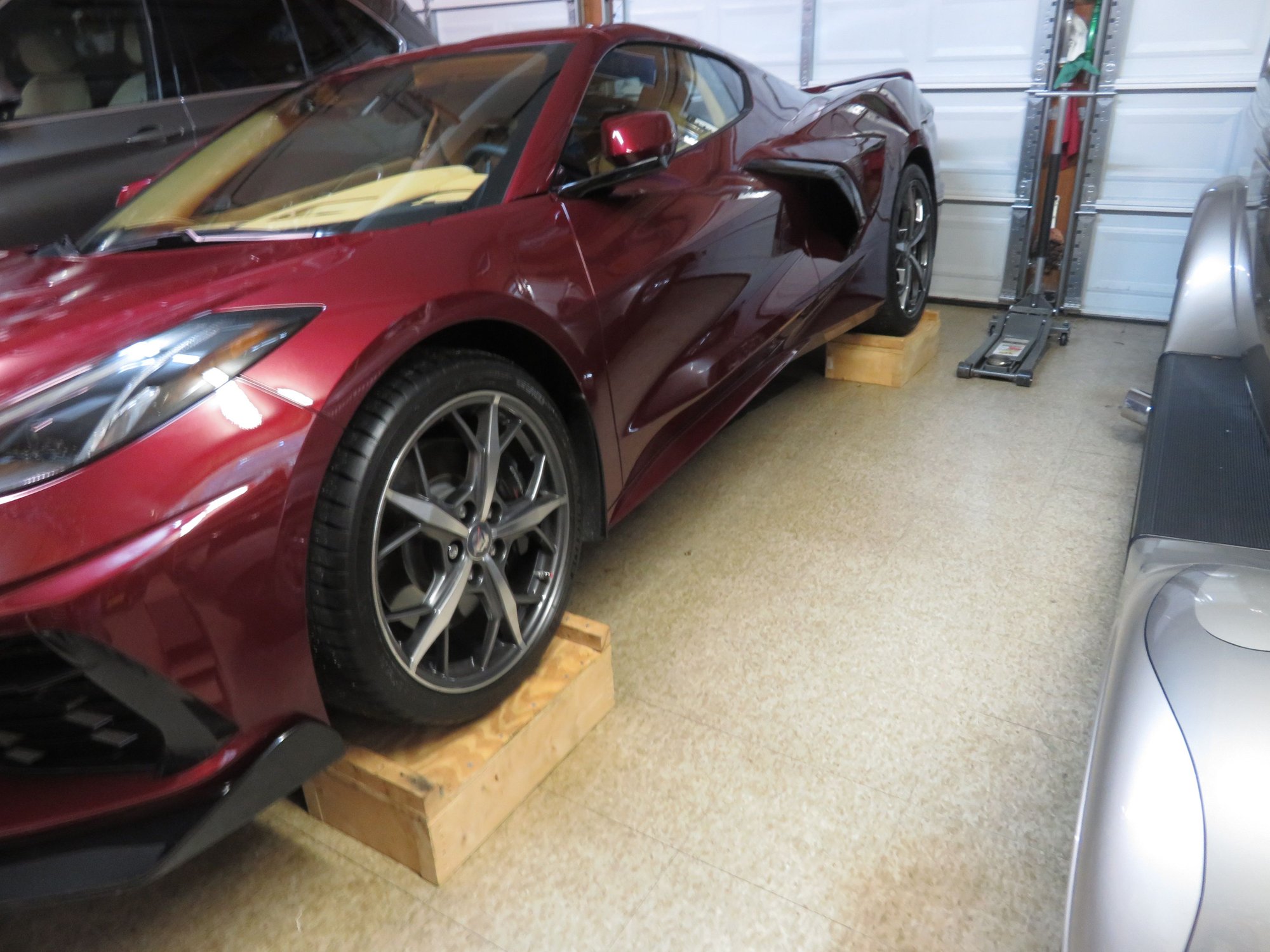

Cheaper than the fancy special jack combo jack stand is a bit more time consuming but works using GM designated jack stand support locations:
However you need to safely remove the aero panel bolts which I would not do using 2 jacks and jack pads. So would use stanchions. Can buy a pair for ~$150 or make them as I did for my 2014 Z51 and have used for 8 years. Made from a 12 foot 2X6 and plywood but could use a 2X8 if you want to have it higher. Mine, about 7 inches high, are enough for changing oil etc. At the time I built mine for ~$10 and some 3/4 inch plywood I had. Today wood prices have increased! Would use wheel stanchions to safely remove aero panel bolts. Then jack as high as needed (I would use 2 jacks and progressively lift each side) and install Jack Stands on the GM specified frame supports.
I also used them to install my side skirts. Needed access to the bottom of the rocker panels so a lift etc would not have been useful to get the drill clearence needed. Wheel stanchions were perfect.

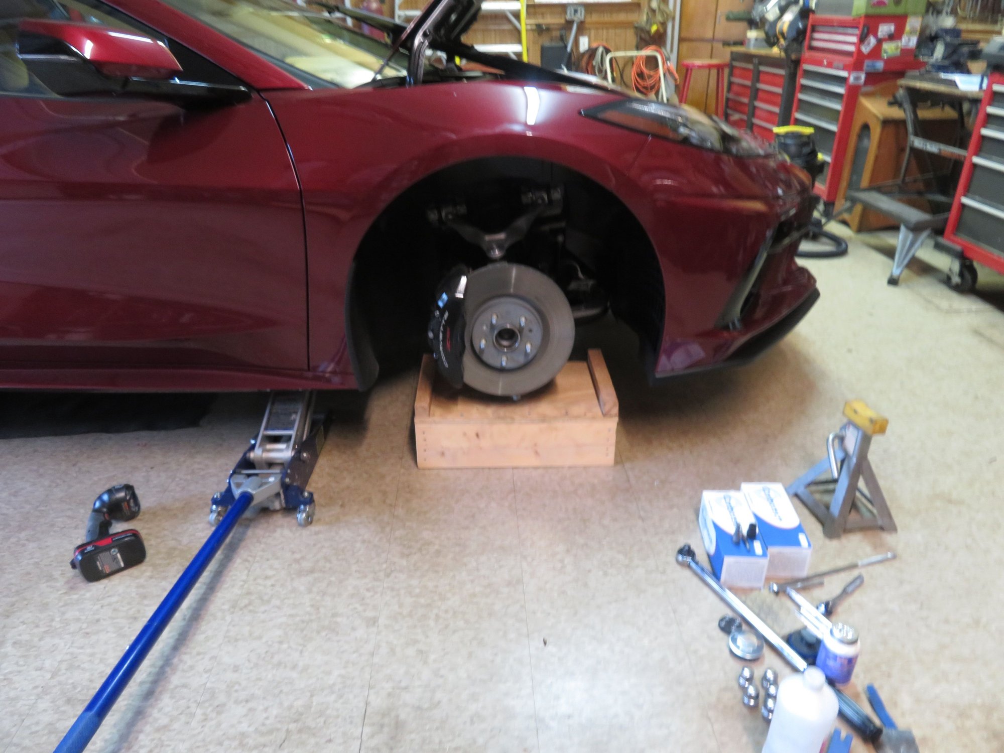

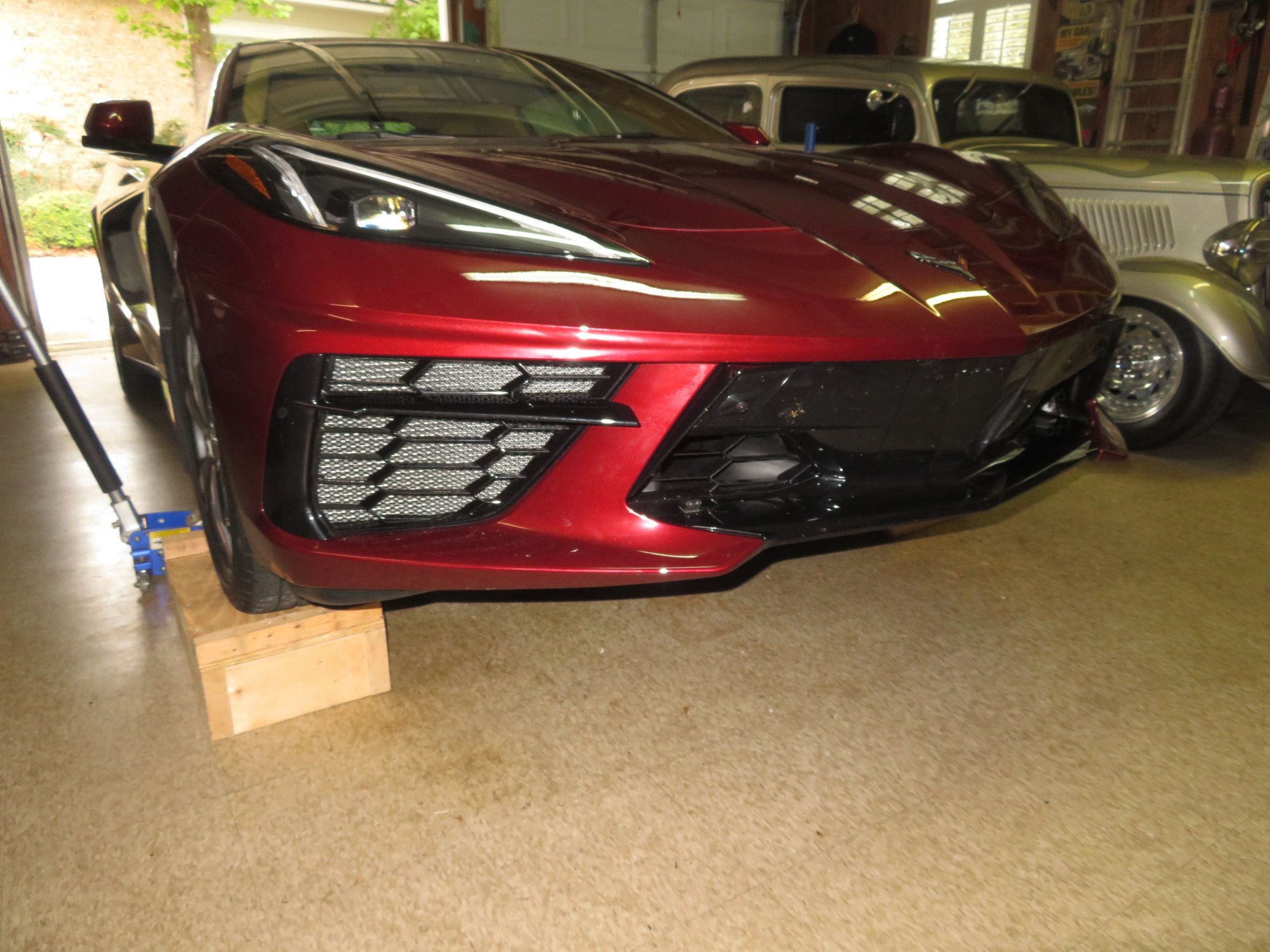

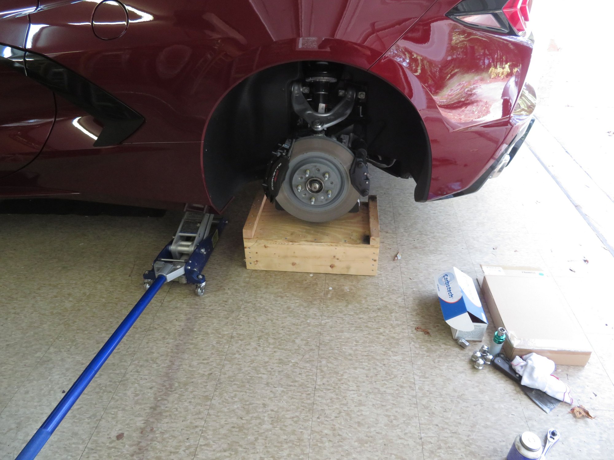

Just a couple of other options that don't require a significant investment and provide the clearance needed in a number of situations. Shown in pics below:
Changed the brake pads in the rear as well as the front by placing my stanchions under the lower "A" arm. Note: Although I changed my front pads, as I did my early 2014 Z51 that also had strong double side brake tape- I suggest it's safer removing the caliper that can be done by lifting higher to remove the 155 ft-lb bolts that hold it. Would use the two step process I outlined above to place jack stands under the GM defined "support" locations.
Have used jack stands under the lower a "A Arm" over my safely jacking cars in the past 65 years! As I often have done with my 6 Vette, will frequently leave the jack(s) (and jack pads) with some tension when using a lower "A Arm" or even jack stands on frame members for extra safety. I typically use two jacks and lift progressively on each side.
Recently bought this short Jack Stand for ~$10
