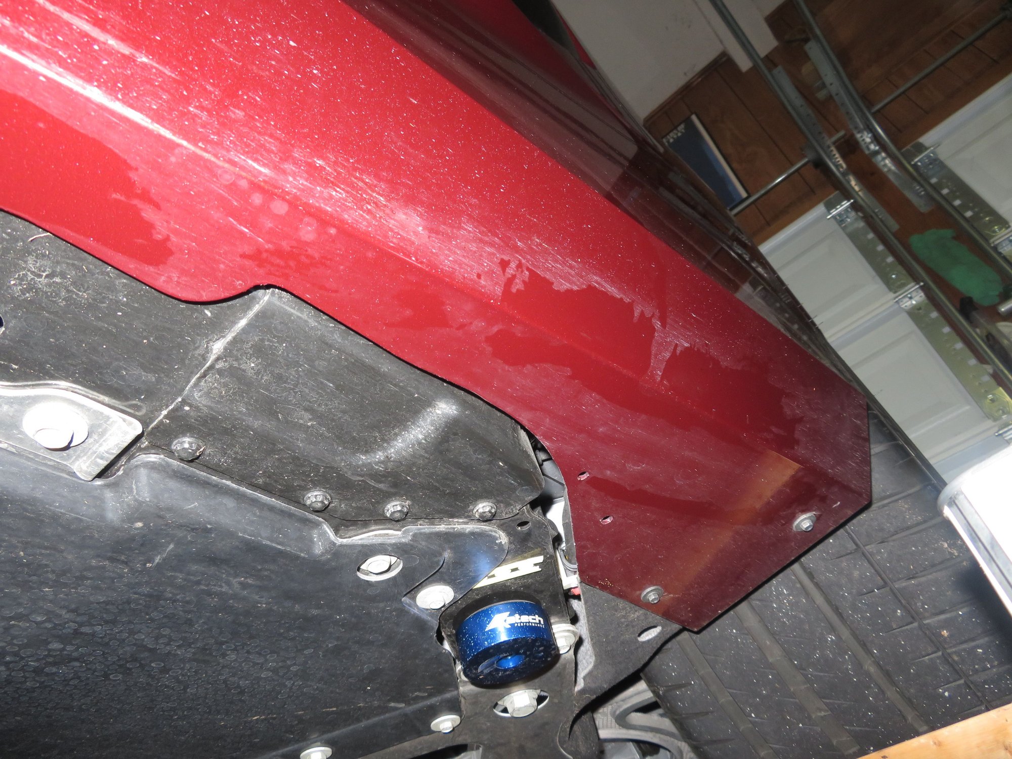

I have side skirts and was surprised when someone said the 9/16 inch permanent pads work with the GM Side Skirts. My C7 Carbon are slightly thicker and I thought min one inch would be needed.
Here are some pics of what I have used and what the dealer used that I keep in the tool bag in the Frunk.
Dealer tech used my Reverse Logic pads that allowed him to access the panel bolts close to the jack pad location.
With my short arm light jack used my 2 inch high pads and thought 1 inch would just have sufficient clearence.
When I installed my side skirts my 1 inch pads just cleared my 90 lb long reach, long arm jack.
