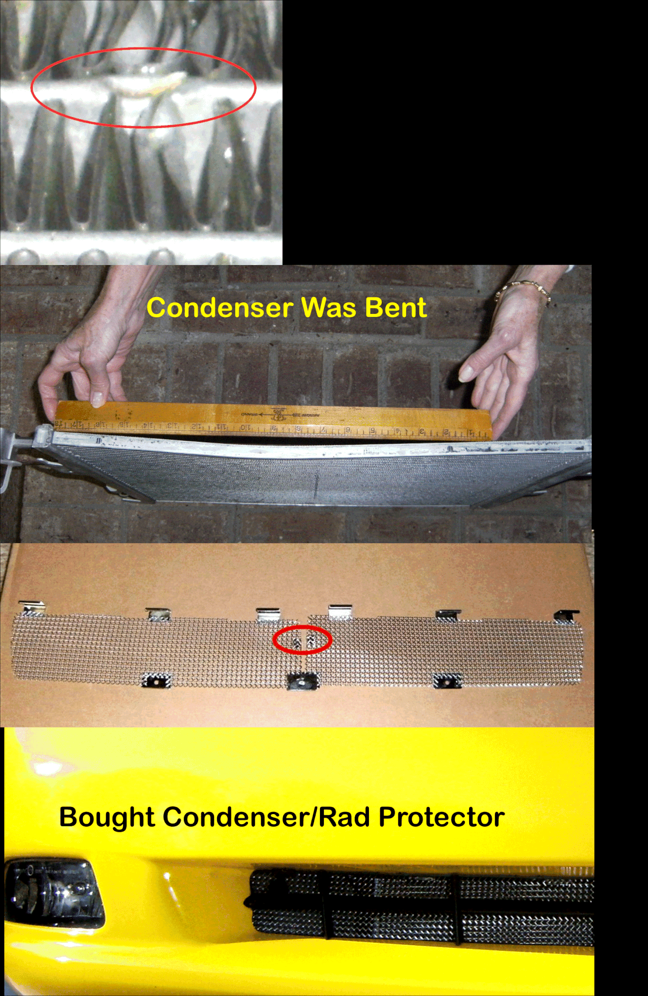

Yep! The experience I had with my C6 reinforces one need. When about 6 months old was in town driving slowly and a hole occurred in the AC Condenser. The gas and oil came out. Brought it to the Chevy Dealer and they looked and said yep there is a hole and GM won't cover as it was probably caused by a rock. Like a paint chip, not covered on warrantee. Paid $800 for a new condenser and install. Bought an aftermarket protector for the new condenser. Yep been an issue forever and "Protectors" have been available.
Fortunately when I got the failed condenser home proved it was a defect from when the rad was install and got the full $800 refunded.

After a hole was found in my C6 Condenser, not covered by GM because it was "probably" caused by a rock I installed an aftermarket condenser rad protector. Fortunately was able to prove it was dropped by the GM condenser vendor or at BG and that is what cased a dent that ultimately failed! Was refunded the $800 paid for the new one.
