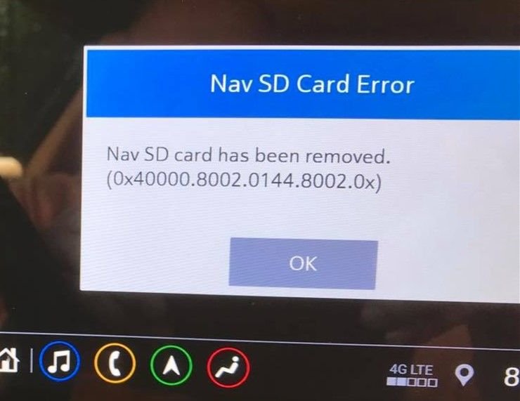

Originally Posted by NextOne
I continue to have this problem on my 2020 using high bit-rate FLAC files. It works fine, but then sometimes isn't recognized after certain engine re-starts. Using the navigation system (and therefore the NAV SD card) seems to trigger it also. I don't think it's a format or formatting issue. It's just got glitches.
Another issue is that my PDR is not over-writing old files even when set to do so. I've had to manually delete files to make more room.
There are several Threads on the subject of the NAV SD card sending a message of SD Card Removed (when it's not!) Lots of attempted fixes, dealer's replacing car reader, even some of my own- did not work! Z06DevilCar found and tested a solution. I found it 99% effective. Basically the USB and NAV Card are using the same buss. When initiating, if the USB has songs >160 kbs there can be a conflict. Turns out about a 1/3 of my 1000 songs on my Thumb Drive where above 160 kbs! I was getting that NAV Card Removed message on the center screen about 1/3 the time!
I had zero issue for about a year as I was NOT using my Thumb Drive only the free XM. When I started to use my Thumb Drive from my C7s the issue started.
This is a summary of what was found and my solution to change all songs over 160 kps to that level very easily; http://netwelding.com/NAV_SD_Card_Error.pdf
Daughter suggested I could change the kbs rate with a free open office program Audacity! Turns our you can also safely rip any YouTube song with the program!
What's funny, there is a quirk with the program that avoided having to go and change songs individually (which would be a PIA!) When I loaded my ~1000 sounds into Audacity noticed all over 160 kbs were reduced to that level automatically! Those lower stayed lower. So I just copied that file and put it back on the Thumb Drive! I have my sound system starting in shuffle mode when I start the car. It will often say no USB detected for 15 seconds or so then it starts playing!

Since you pulled up this old Thread, I'll comment as although I mostly solved the issue outlined with a PDF Link solution I still have both issues.
For the NAV SD Card Error, I was getting that about every 1/3 the time I started once I began to use my USB for music. It never happened when I was using Sires XM for the 1st year and did not have the USB plugged in! I now get that message (post #6) about 5% of the time. Was solved by reducing the max bit rate for my 1000+ songs on the USB.
Occasionally I do get a delay in the music starting. Usually it stats paying in shuffle mode when I start the car. About 15 % of the time I get no USB connected. But 99% of the time that 15% will start in a few minutes all by itself. A few times I did have to remove the USB and reinsert.
It, like the NAV SC Card is probably due to the buss being used for both.
