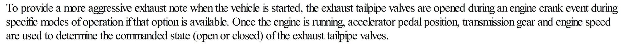

Others have also asked this - I have not seen anyone post a way to do that. While I do not want to do that myself, the question prompted me to experiment to see if I could get the car exhaust sound to be in stealth mode by setting the exhaust sound to stealth while in the accessory mode, and then starting the car. That did not work for me. Below is what the shop manual says about the start-up "bark". It does say something about "during specific modes of operation" - but there is no other detail that would suggest a way to cause the valves to be closed at start up. That is, assuming you want the valves to function normally at all other times.

Others have suggested that. And in another thread, debated the point. But the shop manual specifically says the purpose is to achieve a more aggressive exhaust note on start up. There is also quite a bit in the manual about control of emissions on start up, and heating of the cats, including adjusting the timing, and the air fuel mixture that I posted in another thread. It never says that having the valves full open at start up is for emissions. Having said that, what you say could still be true - I just could not find any evidence. I must admit I was actually surprised to find in the shop manual that the open valves at start up was to produce a more aggressive exhaust note. I was expecting it to say it was for emissions - but it didn't.

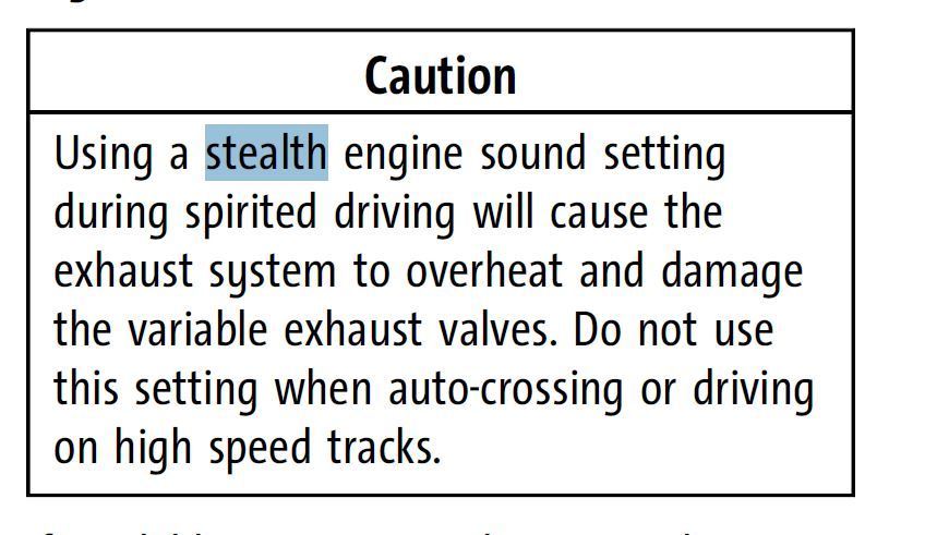

There are two cautions for stealth mode in the 2021 Owners Manual. The first is in the section specifically about "Track and Competitive Events". And it says don't use it at all. The second is more general and says don't use it for spirited driving, auto-cross driving, or driving on high speed tracks. I attached them below. There is nothing about "extended periods of time" in the manual other than under those specific conditions mentioned in the caution statements. Also, the exhaust is in stealth mode when using the Weather Mode - and there is no caution about using Weather Mode for extended periods of time, as long as you are not doing any of those things mentioned in the caution statements. I don't know anything about what might have been true for the C7.
This is in the section on competitive track events - and specific to that condition.
This is a more general caution, but again its specific to spirited driving, auto-crossing, or high speed tracks. Nothing about extended use under normal street driving.
