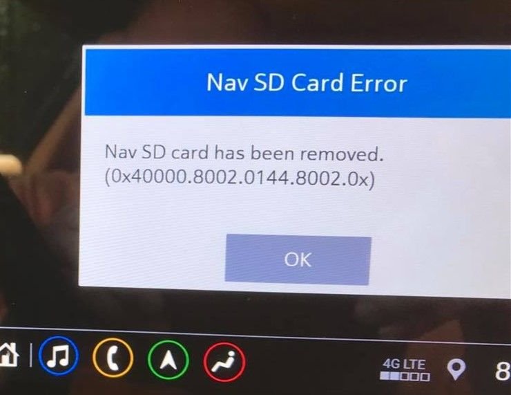

Yep, unless you get a message like I and others have received IF using USB for music! See pic.
Someone found a partial solution I'm using. GM has only acknowledged it occurs periodically for a number of GM cars.
It's caused by NAV and USB using the same Buss and they can conflict on start up. You'll first get a message on the center screen that says SD Card removed. You have to press OK to get past that message. Then when you press NAV on the center screen (I did because I was not getting speed limit in HUD) you'll get the message shown in pic!
Since the above is an old post and I had not solved the problem that others have also reported, I finally have about 3 months ago!
The solution was found from a note the C8 Corvette Tech found on a GM Service program after he had downloaded that latest infotainment software that was NO HELP! It said if a SanDisk flash drive is being used this could be the issue! Now all those with the most popular SanDisk flash drives don't get your shorts in a knot!
That message on the GM site gave no reason for the statement. The Tech said they are put in by other Techs who found an issue. But as the Tech saw my Flash Drive was a SanDisk. So I decided to buy a Verbatim flush mount flash drive, and all has worked for now 4 months!
I searched the Net to see what my one-year issue could have been with the SanDisk flash drive. Several posts discussed the problem with Bootlegged SanDisk Drives! In fact they warned about buying the cheapest as I did on Amazon! Logical as my industrial experience with our leading brand Heliarc TIG Torches and parts make it obvious. Parts copiers pick the leading brand to make and sell! When our patents were up we were the one copied!
It's less likely with less known brands, like what I bought! Bought it also on Amazon but had I know the issue would have bought from a reliable source. They are no doubt also selling on Amazon BUT tough to define who is legit.
The issue is related to both NAV and the USB initializing over the same Buss and a conflict occurs. Perhaps it's a read speed issue? Don't know BUT the SanDisk flash drive I used was working on my two C7s. Perhaps the C8 system requires faster read speed. Of interest, this is not only an issue with Vettes. The same error is noted with other GM vehicles using the same infotainment system. There is a Technical Service Bulletin 19-NA-279 BUT the bottom line simply stated it's a software anomaly! No help!!
