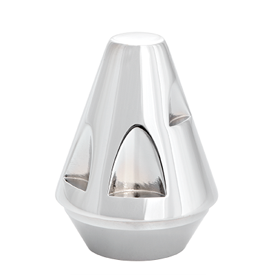

I couldn't find them with a 30 second search, but there are these cone shaped ones which supposedly prevent all the usual methods from working (unless you keep the key in the car)
Update: Found them
https://advancedwheellocks.com/#features

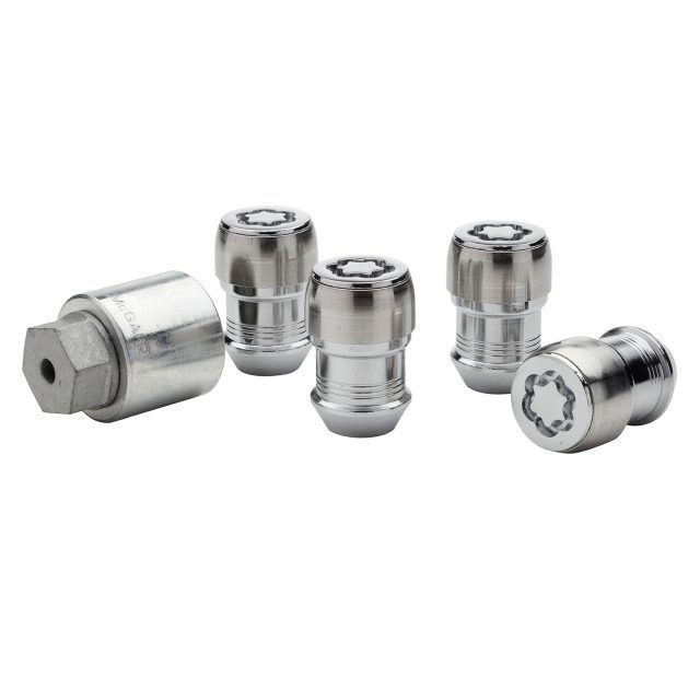

McGards are high quality, and won't rust. There have been lots of reports about Gorilla locks rusting. The one's with rotating collars are definitely more secure. McGard makes them, but last time I looked you could only get them through Chevy dealers or GM parts suppliers. As for smashing the window, don't leave the lug key in the interior.
Will wheel locks deter a determined thief who's willing to make noise smashing a window or hammering a socket over the lock? Probably not. But they will probably make an amateur looking for a quick buck move on to easier targets.

GM's Hi -Security wheel locks are worth the extra $20 or so. They will spin if someone hammers a socket over them. I perfer having some extra deterent, rather than find my disc rotors sitting on the pavement.

Every wheel lock set I owned, I had an extra key made and kept it at home. Once you register your wheel locks, McGuard has record of your key number for future needs.
