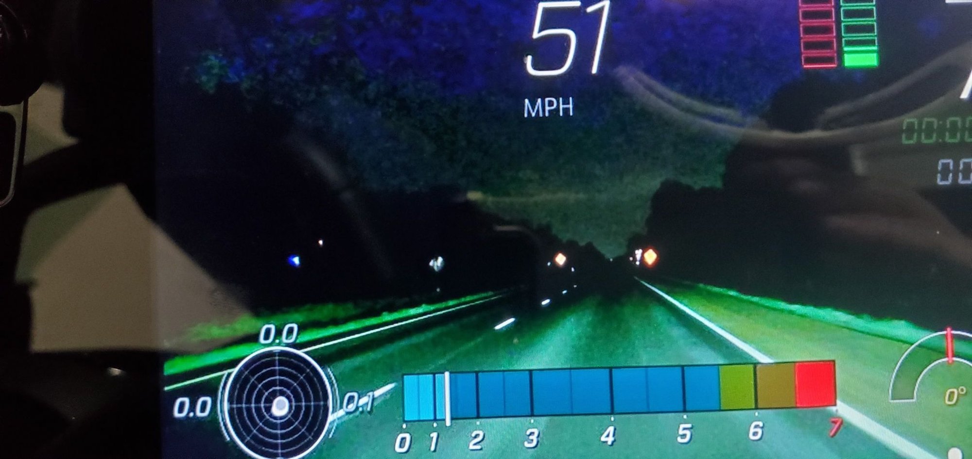

issue was too low. on something like the natchez trace where there are no street lights etc i would feel i would need to catch up to another vehicle and stay back a few car lengths so I could see the sides of the road better via their lights. basically what was directly in front of me was fine, but wanted a little more light further down the road to have a better reaction time to slow down.

you won't dislike the car but wait till you drive one at night with vehicles coming at you having an astigmatism. you sit low and i didn't even mention the glare the windshield has from both external lights at night and from the dash during the day (mainly i hear complaints from those with the lighter color dash) but hey, my 74 year pops every time I give it to him for a week, goes everywhere and makes excuses to drive it so he's not complaining. i'm pretty sure he can't see, he tailgates everybody due to depth perception issues and i know for a fact he is deaf but too hard headed to get hearing aids, and.....with that said, if he didn't have one already, mine, he'd buy his own.
i specifically didn't mention these things because it really is just to be expected if you are sitting at everybody else's bumper level.
