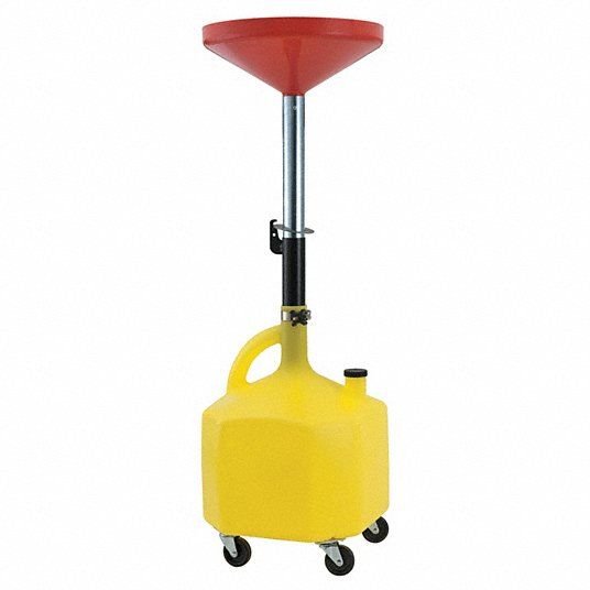

I just use this with my C8 on my lift.

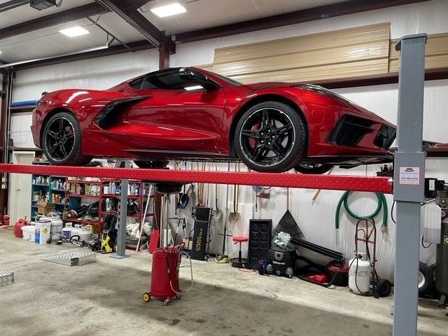

Just bought this for my work garage because I change oil and service all 5 of my vehicles, and getting on and off a creeper was getting old (like me). 11k lb lift big enought to put my dually pickup on but with front lift the Vette goes on with an inch clearence to spare.

That’s what I have but due to the force it splashed everywhere
It does splatter. Never had this on other Vettes or other vehicle. A 5 gal bucket may not fit ,but I could always cut the bucket , which should help.
