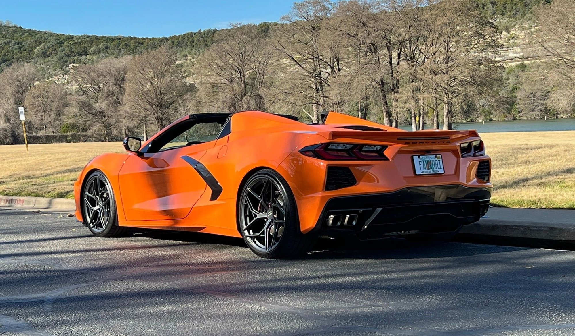

I have Aerolarri’s in 20x9.5/21x12. I originally went with 255/30/20 and 325/25/21. I felt that the fronts were too stretched out, the tires weren’t quite wide enough, so I switched them to 265/30/20. The rears are fine. I had a tiny amount of rubbing on the front optional splash guards but it was very minimal and Aerolarri has since changed the offset 1mm to stop that on new sets of wheels. If the car is lowered, the old offset will not rub either. If I were to do it all over again, I would go with 20x9 with 265/30/20 and 21x12 with 325/25/21.

Thanks for the info. I was originally only going to 20/9s in the front too. I do take it to the track on occasion so if there's even a chance of it rubbing I'll error to the size of caution. I want performance & drive ability before looks. If I do go to 9s, you still recommend 266s vs 255s?
Do you notice more road noise or harsher ride with the lower profile?
Nice ride by the way!

Nicely done! The spacing is spot on and 20/21"s look great. Nice ride

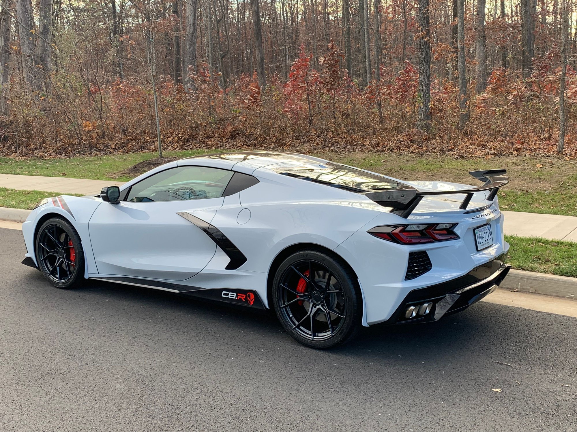

I ended up sticking with stock sizes, 8.5” & 11”.

Oh okay. Any pics?

You too…Had to kick me out at 30.
Stock ride height.

Thanks for your help. I just put an order in for the stock size.

if you’re planning on tracking the car, I’d swap back to the stock sizes or at least some 19/20 or 18/19. For the street, 20/21 has been great for me. Road noise is about the same and ride is very close. Feels a little more planted, but that’s probably a mental thing.

I’m really happy with the low profile spoiler. I had a 21 htc, ordered it without z51 mainly because I didn’t want a spoiler. When the low spoiler became available on the 22, I decided to try it. I don’t think there are many negatives to going 20/21 except for being a little more careful driving, avoiding potholes, etc. also there aren’t any run flats in the correct sizes, but I’ve never really like runflats anyways.
