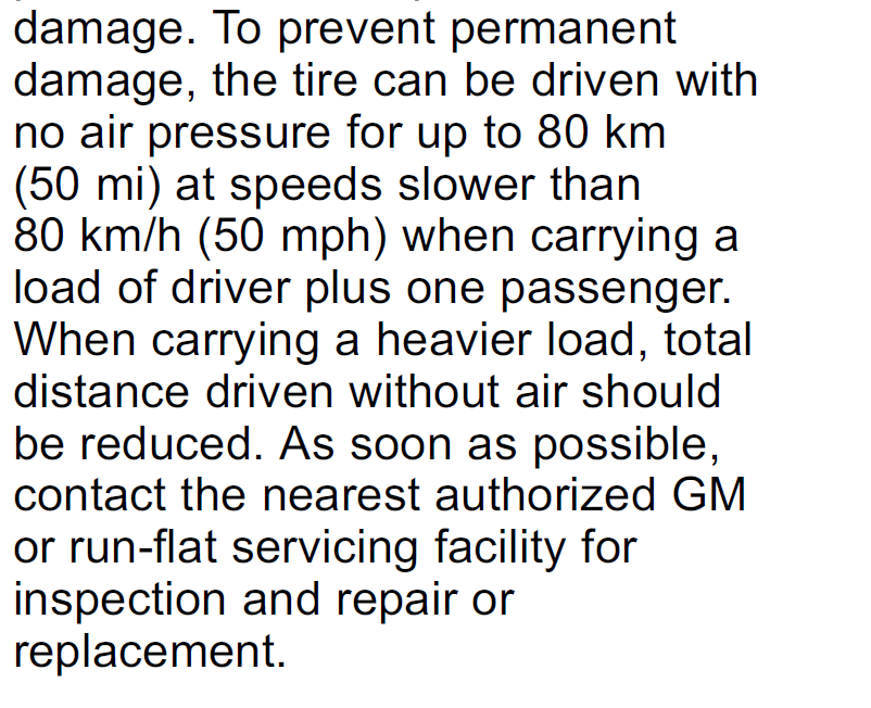

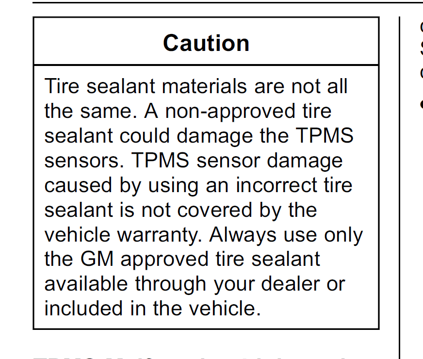

Originally Posted by DMcD
Is is OK to use Fix-A-Flat or Spare Tire In a Can, or some other tire leak sealer in run flat tires? Just long enough to get to a tire store? The C8 has no spare, and I'm just wondering if it would be good to carry something like that in the trunk.
Apparently, yes, but only GM approved sealant material. And you can drive up to 50 miles, and 50 mph, with no pressure, in accordance with the owners manual. Below are the snips from the 2021 owners manual that address your question.
I know that I can drive on a deflated run flat tire, but I was told that if you drive too far on a flat tire that the tire will be ruined and need to be replaced instead of just repaired. Is that incorrect? Sometimes when traveling I drive where it is a long way to a tire store. Those tires are expensive.
Most run flat tires cannot be repaired, so keep that in mind. They're meant to be replaced, not repaired. I know my Pirelli P-ZERO RF tires have a 1-year replacement period that is tread wear pro-rated to help offset the cost, but it's the price of having no spare tire.

Originally Posted by LANZ06
Never use fix a flat on a car with tire sensors. It will ruin them. You have run flats. No need for any of that stuff, just drive it normal to a tire shop.
This is no longer true with current fix a flat compounds. In fact you have a choice. A run flat is only good for 50 miles then has to be replaced. So even if the tire sensor did go bad what is cheaper? Most cars today do not come with run flats, but a repair kit.

I use non run flats (to soften the ride for my wife's bad back). Some sealants are fine to use with TPMS valves, but using them in conjunction with a pump works much better than using the ones in cans. I carry the following system (see attached), which I can use without the sealant to just inflate the tires or with the sealant to seal a leak.

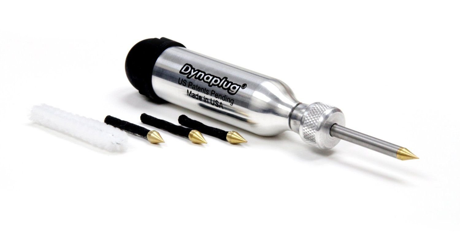

I carry this device in my tool bag, just in case, as well as a small compressor. Their video is impressive. "Parts" fit in handle.

To summarize, if you need to drive more than 50 miles to get the tire repaired, carry and use a gm approved sealant, in the event of a flat. If less than 50 miles, just drive there. Michelin only approves one repair for runflats.
