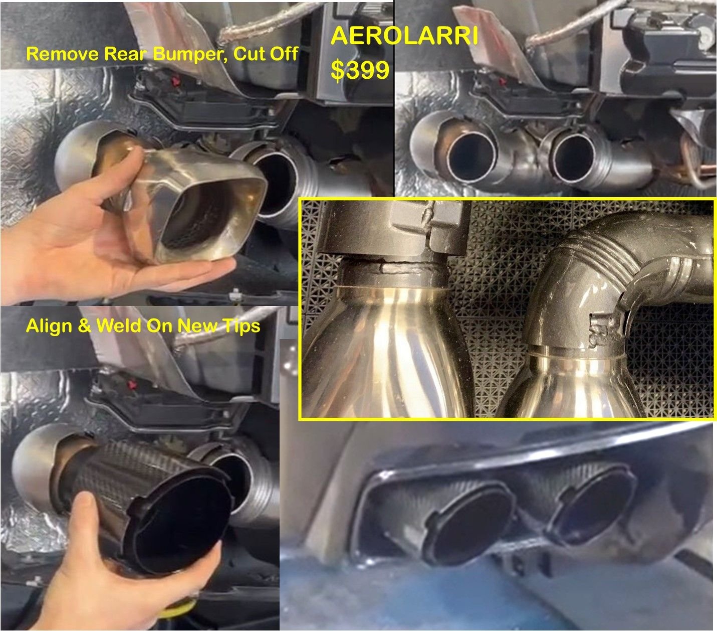

https://www.aerolarri.com/tips.html

Originally Posted by C21ban
Any idea how they're attached? The stock tips are welded, and will need to be cut off. Do these need to be welded onto what's left of the stock pipes? Their 10 second video doesn't show that part.
from the site - “Ask your muffler shop to cut off the old and weld on these new ones“
Yes, the original tips will have to be cut off and the new ones welded on.

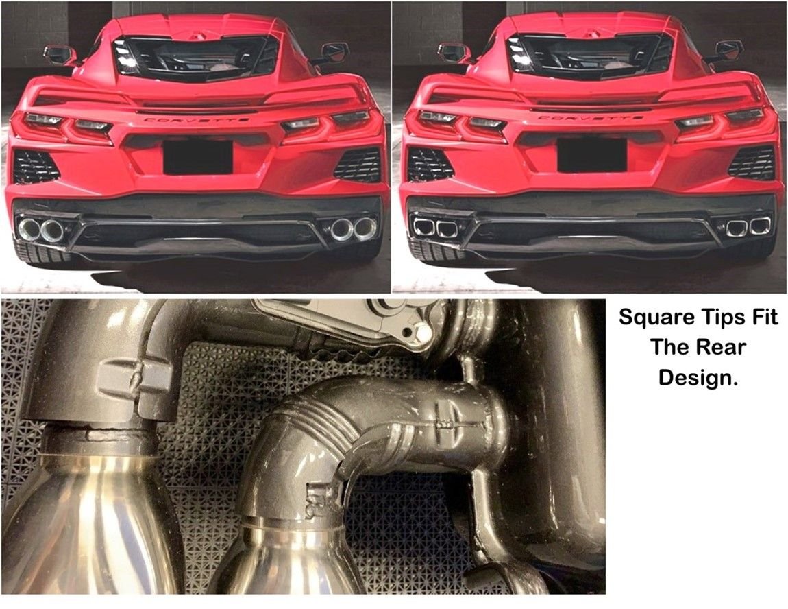

Yep, only way. Getting all aligned properly not easy, whatever you pick. Need a good shop who will tack weld first and assure perfect alignment.
Some thought round might be better. I think the GM stylist looked at many options and current design fits the rear shapes.
you will have to remove the rear facia as well
Correct
Good info on their website.
Made a composite pic. The tips look similar to what Borla offers on their ~$5000 C8 exhaust system. It's a ~$500 premium over straight metal tips.
Tenneco welds the assembly in fixtures (with MIG welding robots, some of their locations are my customers) that assure alignment. Must have a quality shop carefully align as small deviations would be visible.
