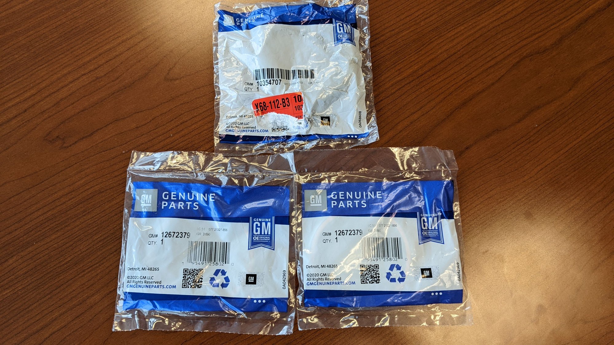

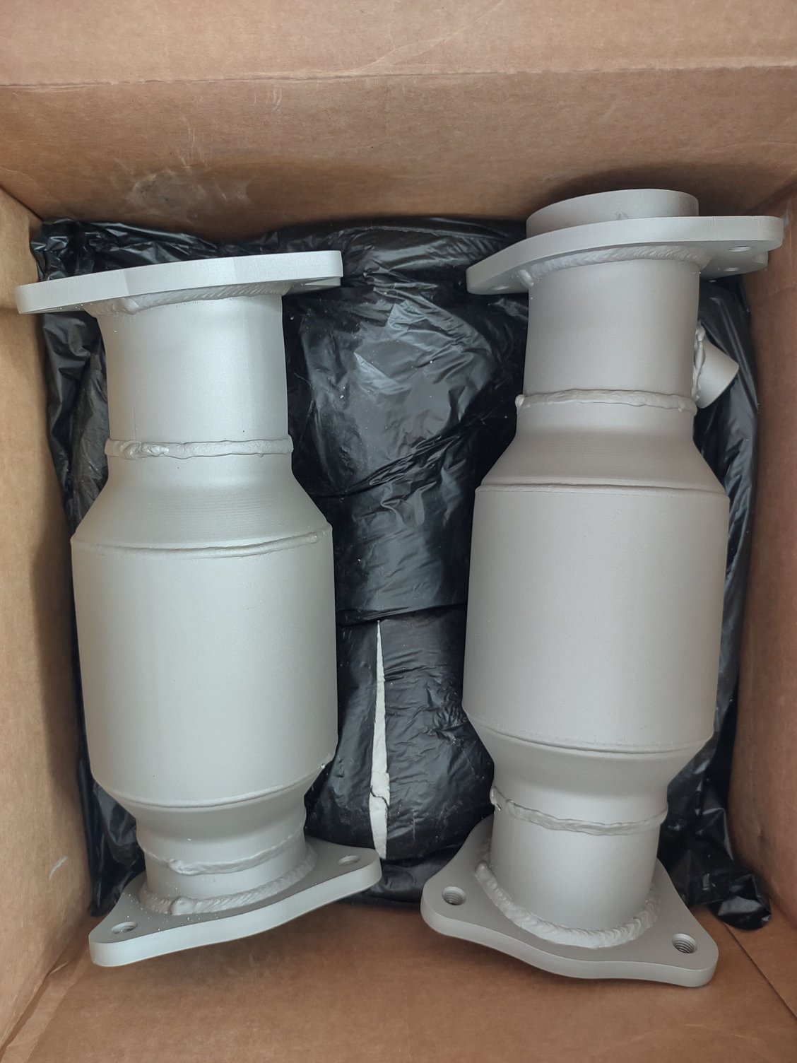

They are a really good choice and use GESi G-Sport GEN2 S-Wound 400-cell cores, which are basically the North American latest & greatest. They flow like a 300-cell but are emissions legal in 49 states. I just got mine back from the ceramic coater, but based on the technology they should provide for the least amount of smell from any aftermarket high-flow cats. No CEL per Corsa and a perfect 2.75" inlet to match stock, AFE, & other aftermarket headers. All flanges utilize OEM gaskets; 1 is included and you can reuse the other 3 or do like I did and order the remaining 3 for a complete install with all new gaskets (cost me about $24 total).
