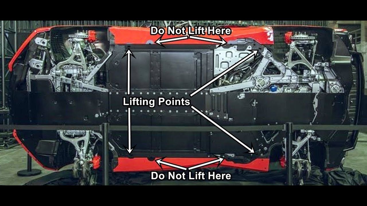

Default Discount Tire
Never a question.
Save this picture and take it with you.

Better yet, just get the red jacking pucks with the "LIFT HERE" text on them, and locktite them in place. Then just tell the service guy to look for them.
