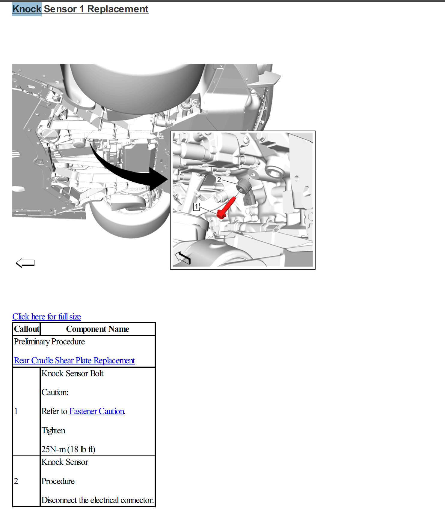

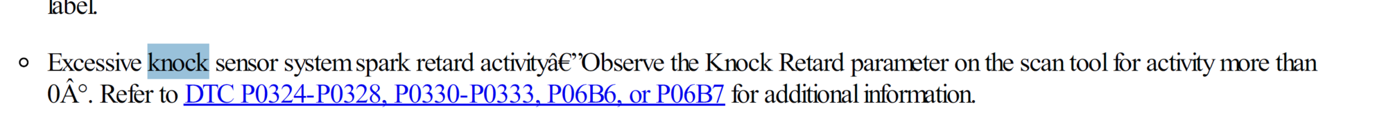

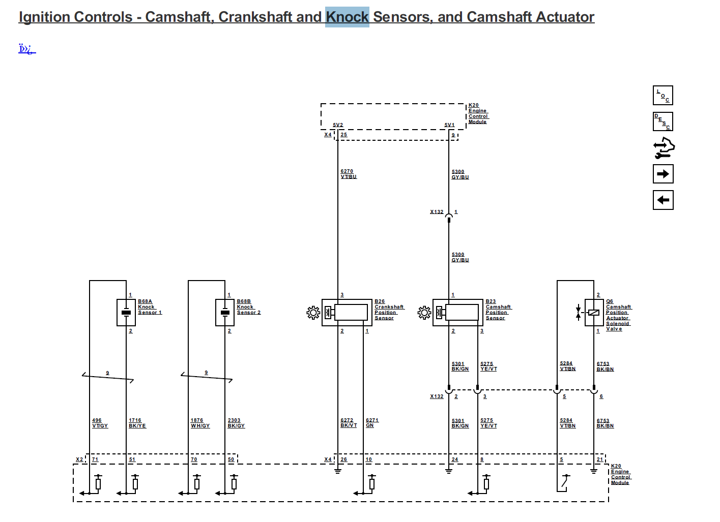

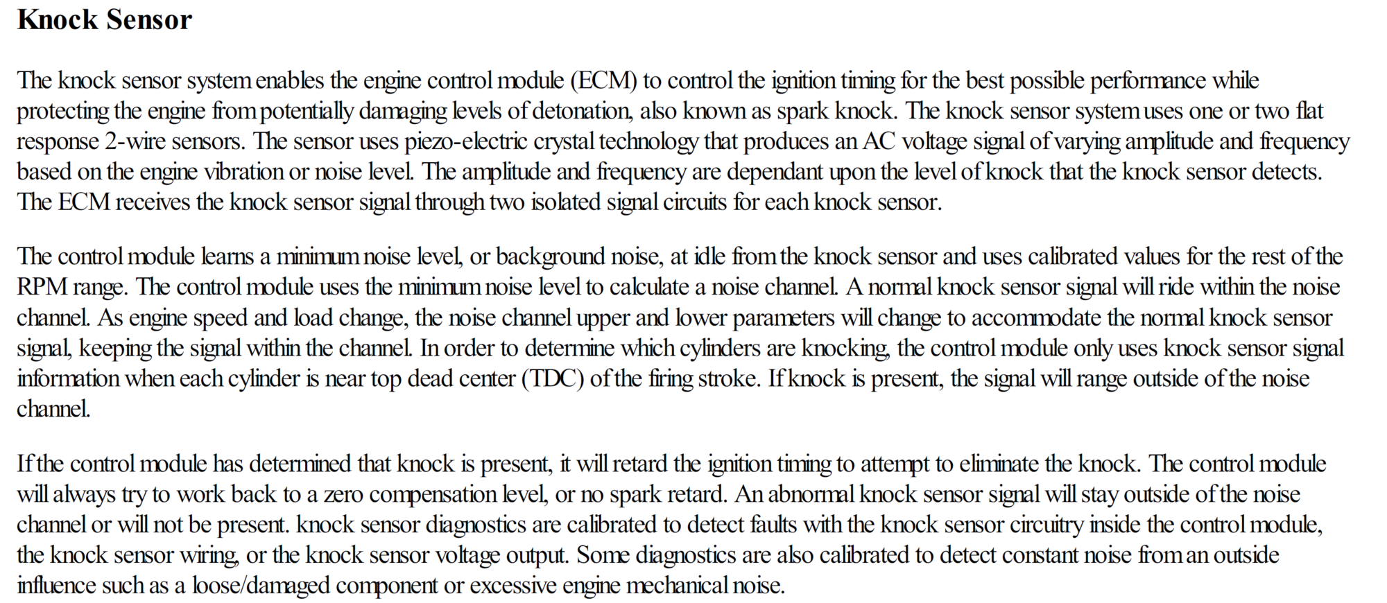

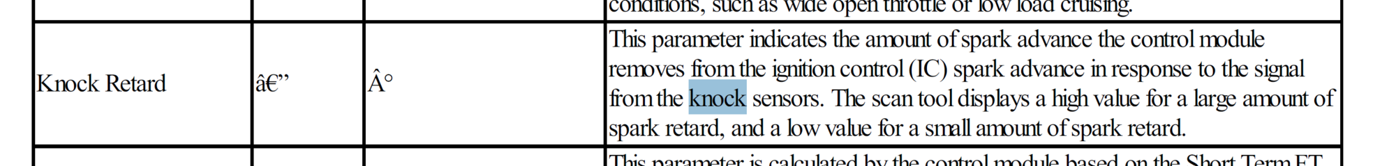

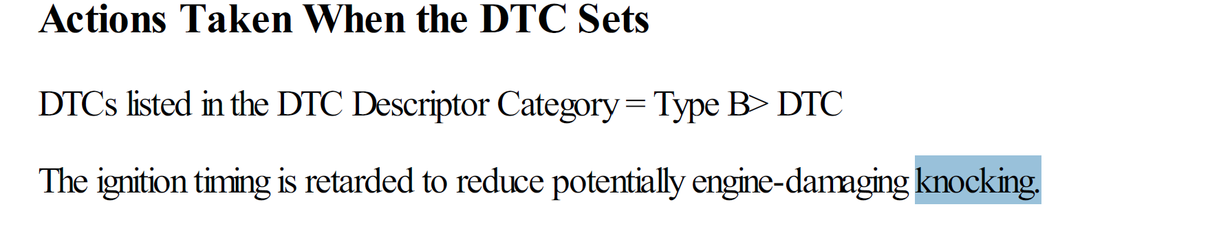

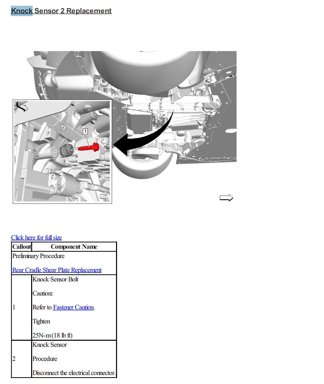

Here is some information from the 2020 Service Manual regarding the operation of the knock sensors. Apparently there are two, and apparently they are piezoelectric vibration sensors.

Actually, no you can't. Your "tried and proven" method was only marginally useful before the days of knock sensors. Today, if the knock sensors are working correctly, you'll never hear the sound of the engine knocking, and you'll have no way of knowing if the ECU is retarding timing, limiting performance and economy.
Exactly. But there might be a way to tell - I am not sure. The 2020 Service Manual talks about DTCs and I think one of them may be for excessive retarding of the timing. And it looks like with a tool there are parameters regarding min and max retardation, for knock alone, and another for overall adjustment (temp etc). I did not include that last one, but below are the other excerpts from the manual about this. Someone more familiar with the DTCs and the diagnostic tools can better determine if this is right.
