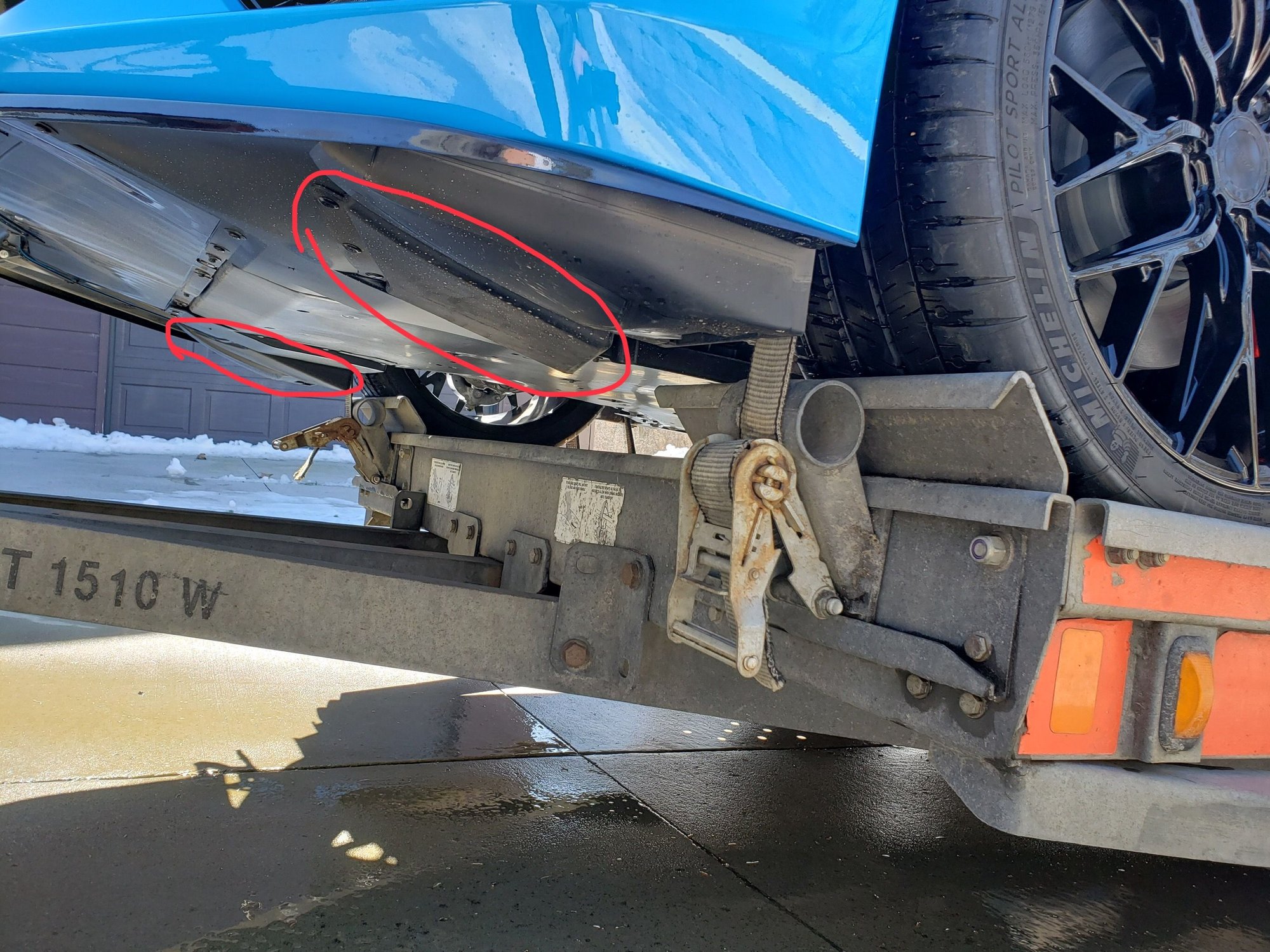

Loaded my C8 on a U-Haul car hauler trailer yesterday, to bring it in for PPF and ceramic. When I backed off the trailer, the front lip of the trailer ripped off these rubber covers from underneath the car. Do you guys know if these are covering anything in particular, or are these just to redirect the wind away from the underside of the car?
I just happened to have snapped this picture before I unloaded the car. The covers that ripped off are the small triangular shaped ones on the inside, not near the edge of the car.

Part of the underneath covers to control air and direct air thru the radiators. If they are destroyed, order a whole new panel. Easily replaced.

Looks like you are pointing to the the z51 brake ducts behind the front wheels that that are needed for track use.

I don’t think it’s the brake ducts. It’s a non-Z51 car, and the two pieces that came off do not direct air toward the brakes at all.

Those are definitely not brake ducts. I've installed the front brake ducts on my Z51 and the brake ducts are located much higher and take air thru the middle area of the grill. That is simply a belly cover and can easily be replaced.

Those are just an aerodynamic item under the car. People remove them. Useless they don't hurt anything.
People need to learn where their ducts are. Hint not in front of the tire.

As for what they are, just aero bits to deflect air around the front wheels, I think. Some people have removed them on purpose, so if you can't get them back on it's not likely to really hurt amything.

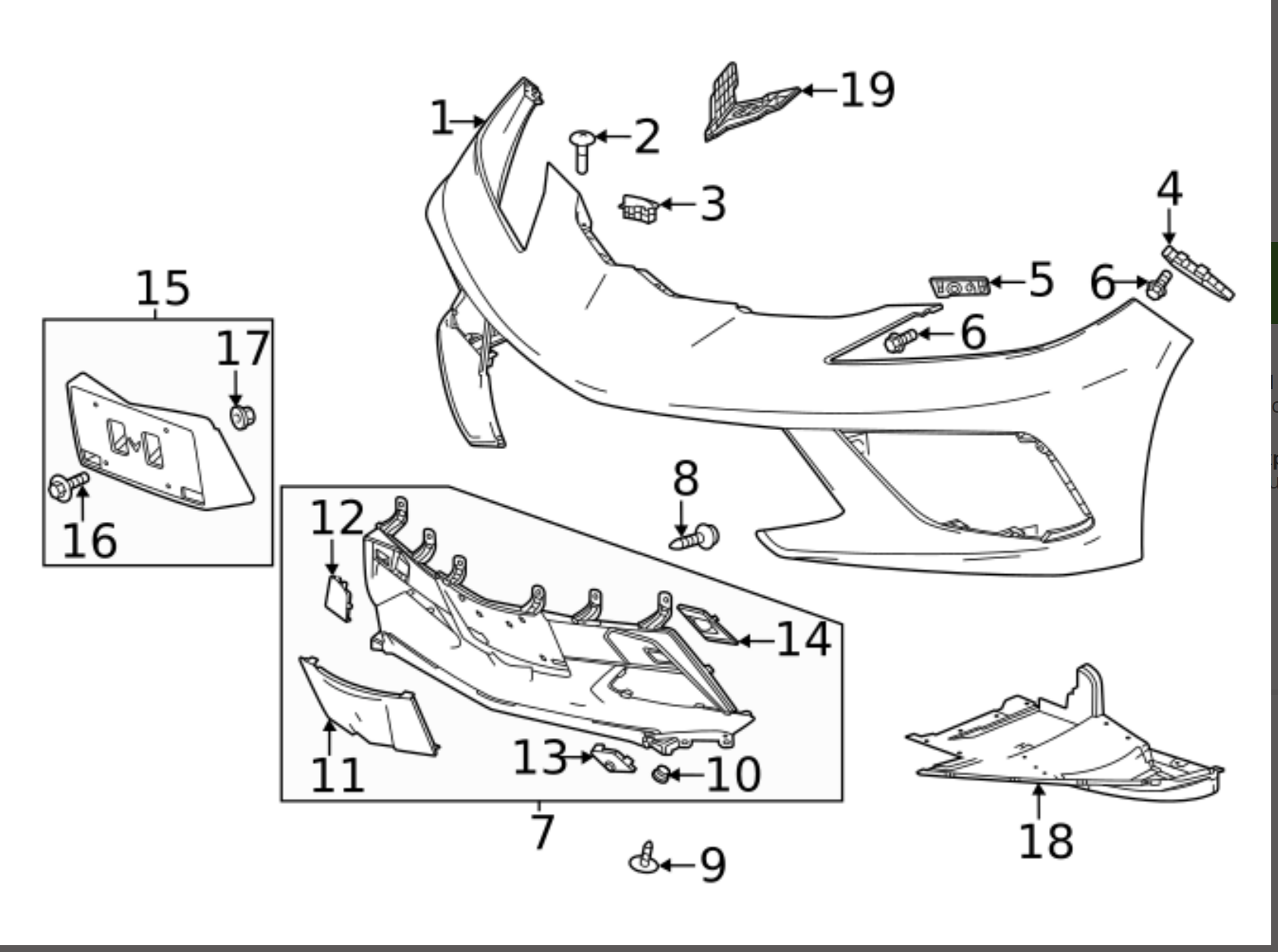

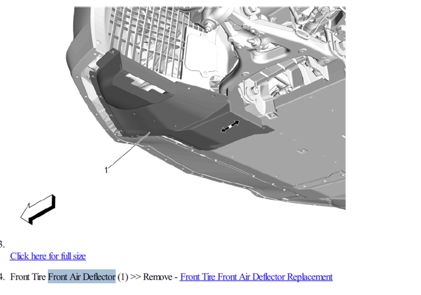

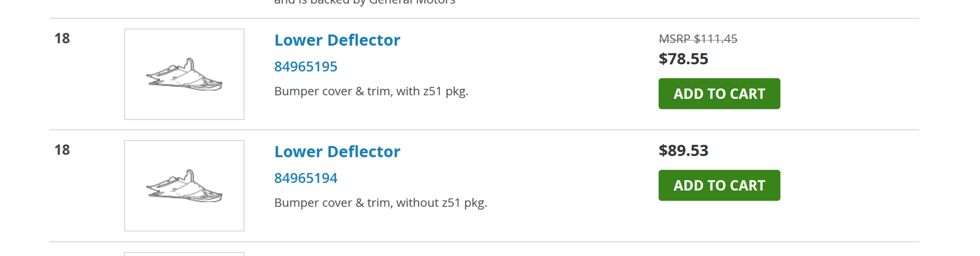

This is an old-ish thread, but since it got revived: It is called a lower deflector in the on line parts catalogs. It is called a front tire air deflector in the 2020 Service Manual. It is on both Z51 and non-Z51 but the part numbers are different. See all below.

The front lift would have definitely prevented that. My car doesn't have that option. It ended up being the front deflector, $130 and a simple DIY replacement.
