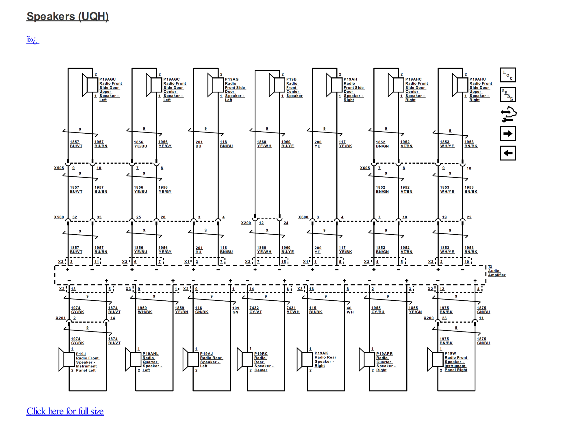

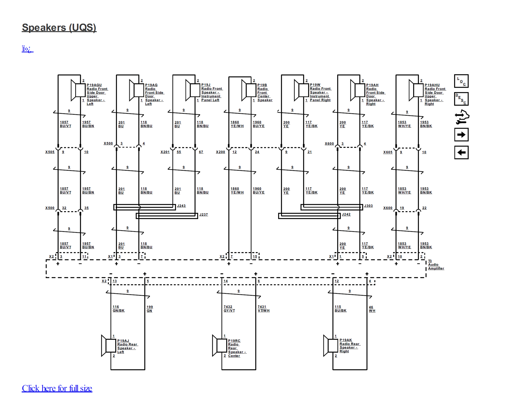

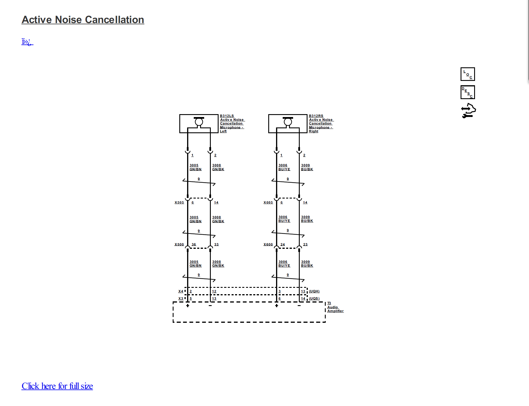

The amplifier for the 10 or 14 speaker system includes extensive digital signal processing. And from what I can tell from the service manual, the audio inputs to the amplifier are mostly, digital inputs via the internal Ethernet (there are some lines going to something called "active noise cancellation schematics" that appear to be analog from microphones in the doors.) It will not be easy to intercept the digital audio signals at the input to the amplifier. They are very likely encoded. However, it appears that the outputs to the speakers are analog, but they are now already processed. The schematic for the 14 speaker system appears to show 14 separate channels. You could intercept those already processed signals and further process them in a downstream DSP, but to what end? Would you attempt to recover the unprocessed signal, then re-process, then recreate 14 channel? Or, if you did figure out how to intercept the amplifier inputs, would you then create a new DSP with 14 channels of output?
The 10 speaker system appears to show 8 channels, as some speakers appear to be driven by the same channel. But the same technical hurtles would need to be jumped.
I have included below the schematics for the amplifier power, ground, and serial data, the schematic for the "active noise cancellation" that is referenced in the first schematic, and the schematics for the 10 and 14 speaker systems.
