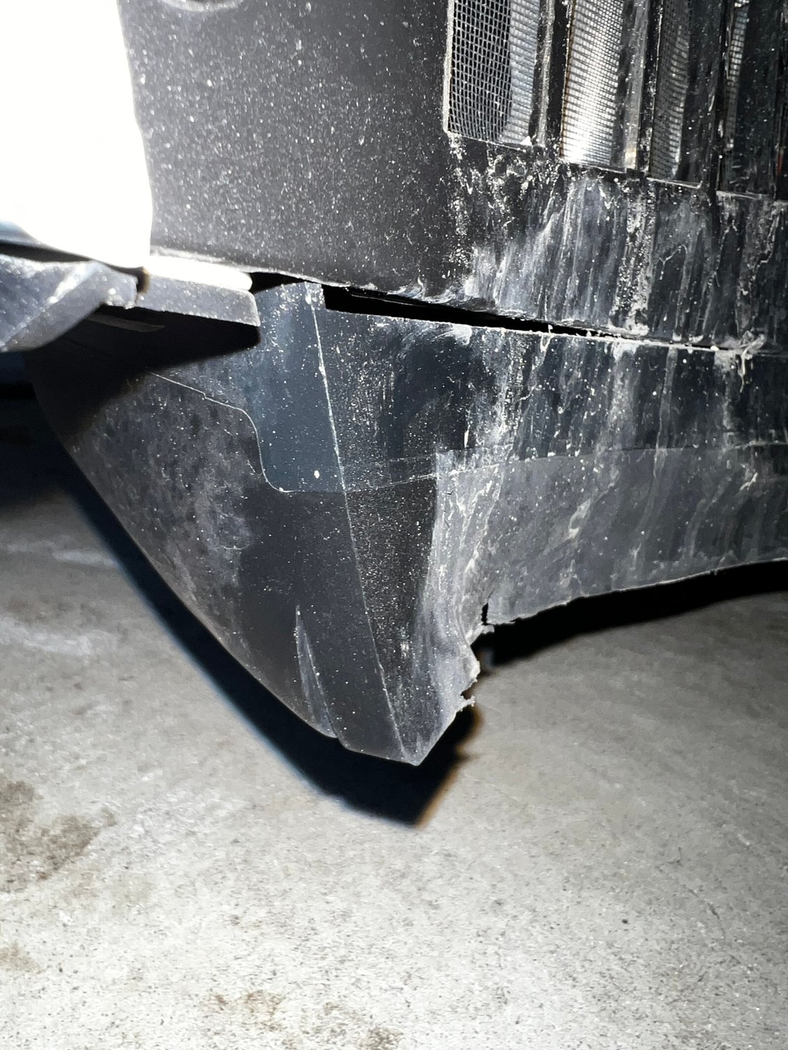

I just noticed the rubber air damn in front of the front wheels and behind the splitter is scuffed up and slightly ripped.
see pic:
Can this piece be replaced and is it expensive?
I’m pissed because I haven’t scraped anything.

I don't think that individual piece that hangs low can be replaced. It's part of a full width piece that includes both of the air dams, is is only available as an entire piece.

Look at item 18 in the second diagram.
This may be it. Different part number with/without Z51.

That kind of thing has been "expendable" since at least C5s. Don't sweat it. Replace it when you can find the part in stock somewhere.

This is NOT the Flexible Rubber type "air dam" on the C6 and C7 Vette! Those are designed to bend and no big deal scaping. Recall on my C6 and C7 just sandpapered the bottom edge occasionally. My C6 Z51 had three pieces one in the center and the two sides. Like many cars with air dams they help reduce drag and improve mpg at highway speeds. At very high speeds they also provide front downforce.
My two C7's (a Z51 and Grand Sport with Stage 2 Aero Option) did not have the center air dam only on the sides BUT were still soft bendable rubber versus this harder plastic. Did the research to see why no center air dam on my C7s where is was on the base C7 AND some Grand Sports without the Stage 2 & 3 Optional Aero. Was related to the center air dam downforce inducing Oversteer high very speeds.
These for the C8 are hard plastic and as I have a Lift a none issue re scraping. Splitter is lower!
They come in pairs, discounted to ~$80 by many. This pic is for Z51. Other looks the same but different part # probably due to mounting holes.

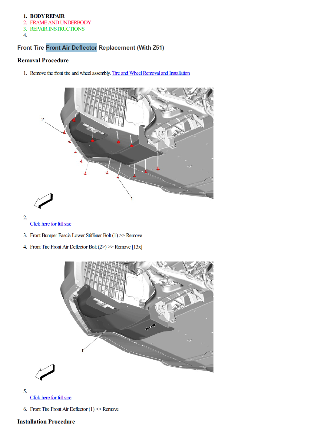

Its called a "Deflector, Frt Tire Frt Air" in the 2020 Service Manual that I have. I have not been able to find that part in the on line GM parts suppliers yet. Looks like Jerry found it while I was entering this post, and the name is different from what is in the version of the Service Manual that I have. I have attached some images of it from the service manual.

Its called a "Deflector, Frt Tire Frt Air" in the 2020 Service Manual that I have. I have not been able to find that part in the on line GM parts suppliers yet. I have attached some images of it from the service manual.

Jerry, I was posting that info from the manual while you were posting what you found. I did not see yours before I posted mine. I think it is interesting that there some discrepancies in the version of the manual I have. The manual purports to be a 2020 manual. Apparently they continue to update the manuals and mine is a snapshot of some version. The discussion of the Hydraulic System Flush is another example. My manual does not include that step as part of the Transmission Fluid Filter and Seal replacement. But another version, posted by someone in a another thread, clearly labeled 2020 Service Manual, show that added step.

I scraped mine up pretty bad also, they appear to be sold in pairs

Surprised none of the aftermarket company's have made Flat panel replacements. Us lowered guys want them gone ha.
