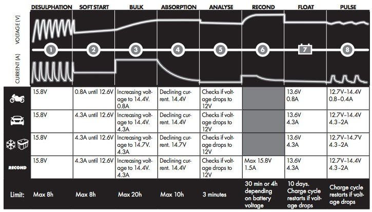

Took my brand new C8 to dealership to ask questions about the temperature rising to 217 degrees while idling in traffic. Their comment was, "was the red light on?" Not much of an answer. Anyway, at that same visit, I was told that my battery was low and they charged it before my departure. at their advice, I purchased Corvette's battery maintainer and plug it in religiously every time we return from trip. My question is, when I first plug in, the battery indicator on the maintainer is on the second to lowest light. According to the instructions, I should not start the vehicle until the charge level indicates higher.
Is this normal, or do I have a faulty battery? TIA

Normal. The C8 battery maintainer is a CTEK and they go through the different stages every time they are used. Here's the stages of the CTEK MUS 4.3:

What Zymurgy said. The lights do not indicate state of charge.

Ditto again....Zymurgy's response. Mine always starts at two lights, even after a long drive but ramps up in several hours....if not longer. Normally I note the next day that all lights are illuminated on the trickle charger.

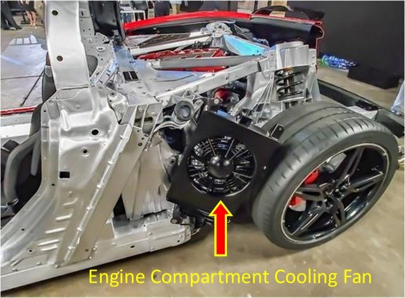

Would think so. BUT mine seldom gets past 185F. Even on 100F days. Granted I don't sit at idle very long and we don't have bumper to bumper traffic. Now after driving aggressively it's still at ~185 BUT when I park in the garage both engine compartment fans are on for 5 to 7 minutes. NOT the front rad electric fans only the engine compartment fans blowing air out the hatch vents.

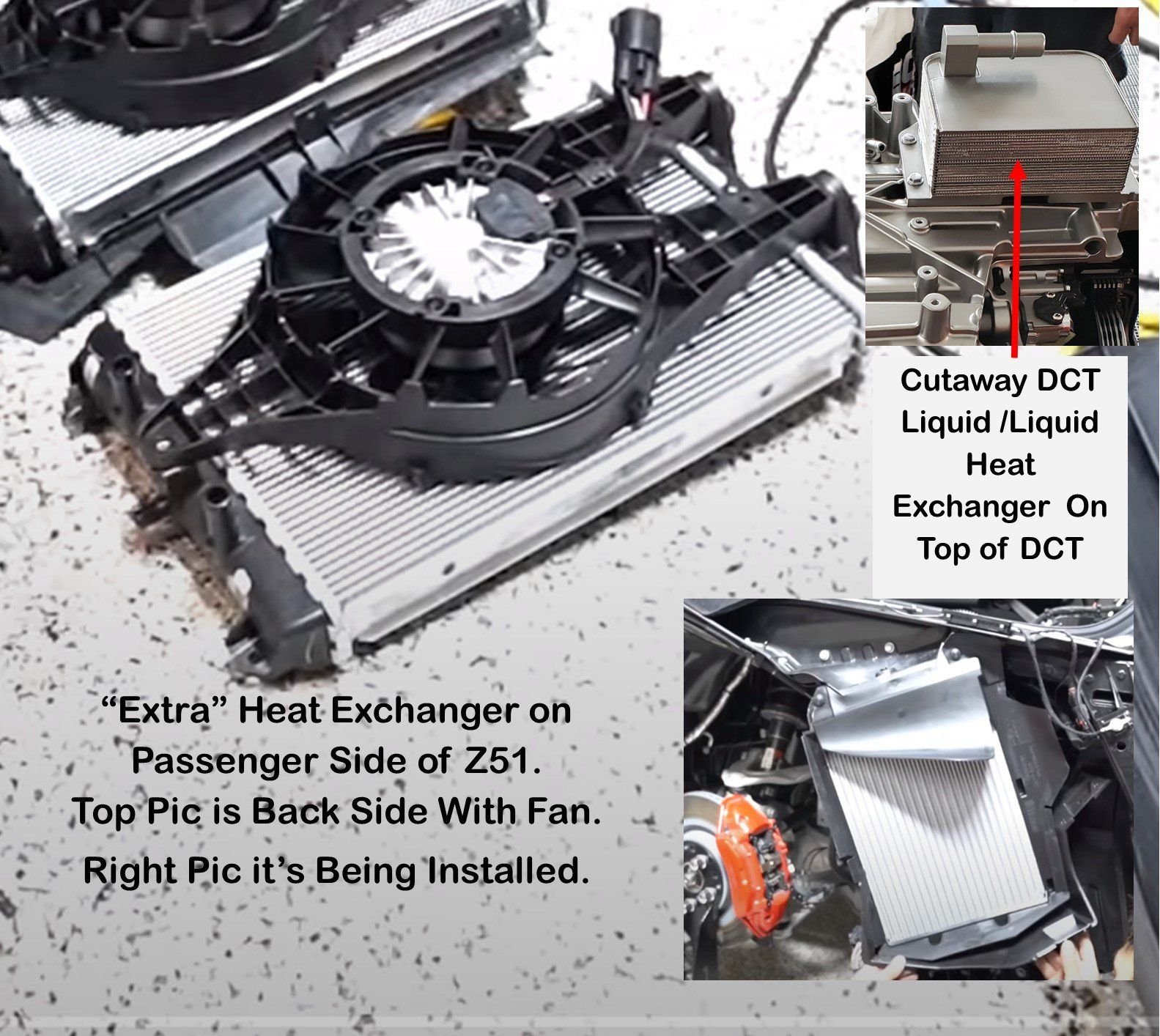

My Z51 had an extra rad in the passenger side rear fender scoop. It has an electric puller fan that also comes on blowing air our the hatch vents.
