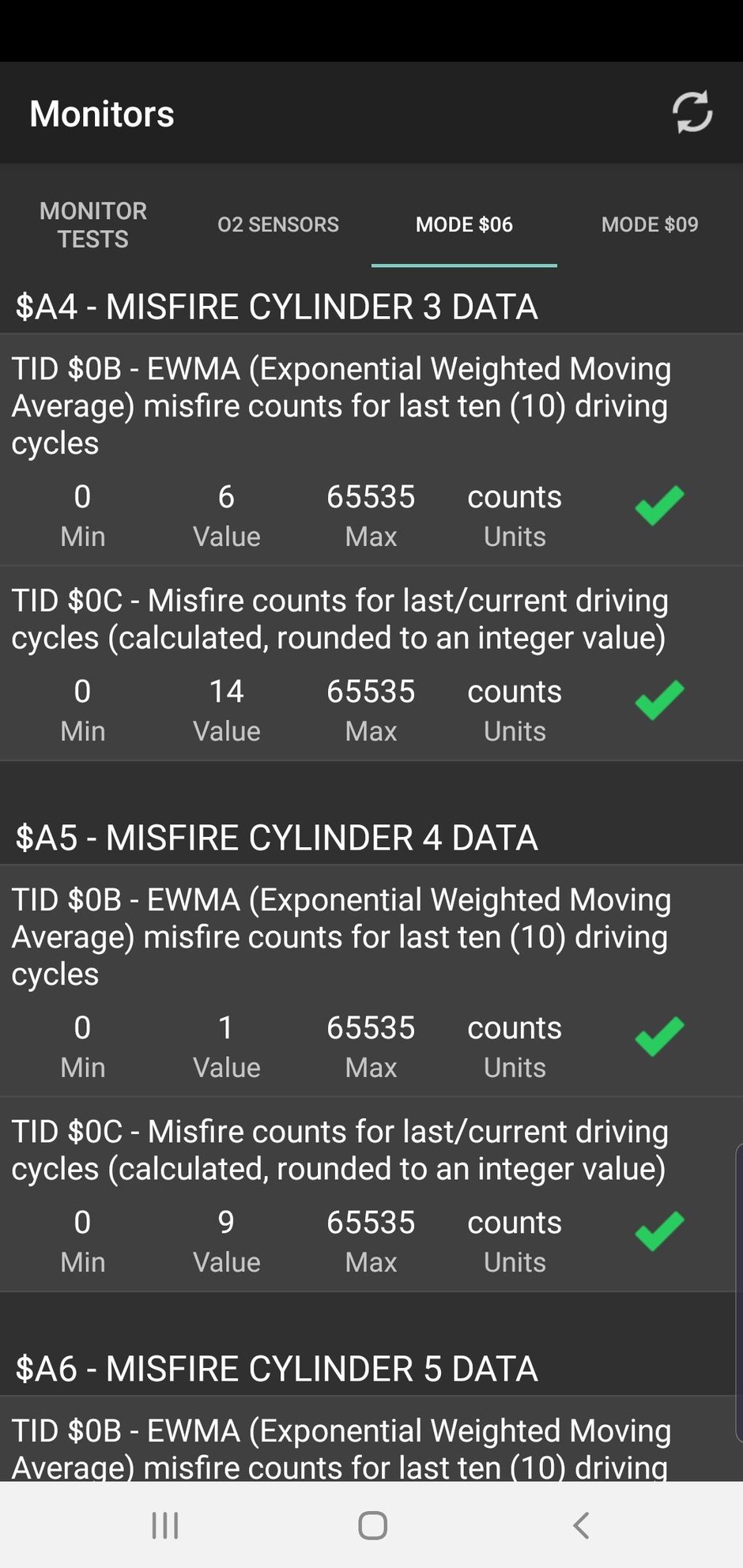

dohabandit's Avatar
dohabandit
Joined: May 2021
Posts: 2,562
Likes: 1,579
Originally Posted by vettebyassociation
Sorry, everyone, when I posted I messed up. I shift at 2200-2500rpm for regular driving. It's then when I get the occasional bog. And the pop that happens is not the normal pop. It's very loud, like a backfire, and not the regular pops the car typically makes
Ok, that sounds better. So less likely to be issue with lugging the engine.
Have you tried just driving in D(auto)? (Z mode or otherwise) does it still bog?
I am starting to wonder if you have a misfire problem related to a plug/coil. If this is occuring around the time the timing is retarded during those normal "pops" on shifting between 1,2 and 3rd gears then perhaps this is leading to some unburnt fuel igniting in the header/s?
Do you have an OBD2 scanner? I have seen misfire problems reported by my scanner where there is NO CEL, and NO CODES.

It's on my list to pick up a scanner this weekend so I'll see if anything comes up. Thanks
