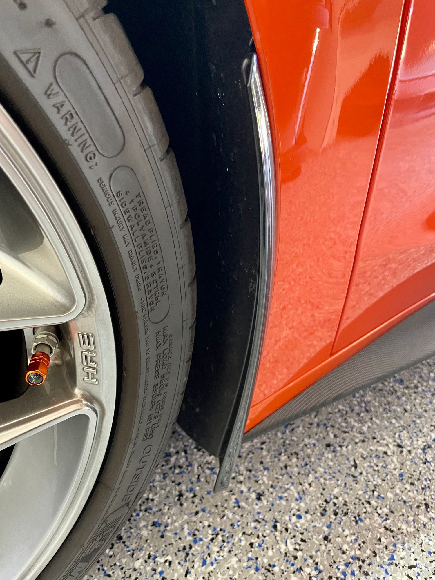

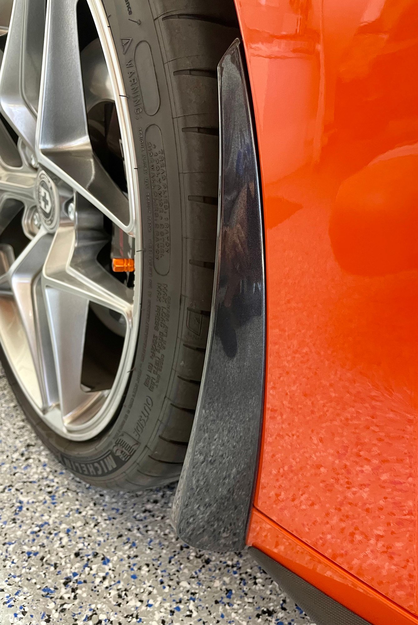

Can anyone confirm if the EOS XL splash guards fit with a 20/21 wheel setup? Or any other guards that work with 20/21 minimal rubbing.
EDIT: For anybody searching this in the future- I’m confirming the splash guards do not rub with the following specs. 20x9, 255/30/20 pilot sport 4s, lowered 1 inch

Yes, obviously tire diameter is what matters- just asking anybody with 20s up front. Some people run 245/30 and others 255/30 or even 265s. The 255/30/20 PS4S up front are .3 inch larger in diameter than the stock all seasons and are what I plan to run.
Somebody must have tried this and have info.

Here are the gaps on the front wheels with the EOS XL guards….I’m running HRE FF11s so the wheels are flush with the fenders.
