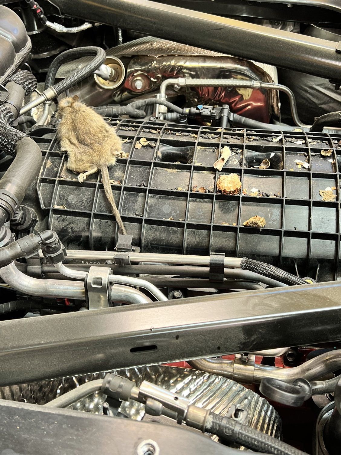

Any body have a rat problem? Engine has to be removed account rat chewed wires. Check engine light came on. Discovered rat chewed wires. C6 ZR1 sitting next to it. It wasn't touched. It like it only likes C8 model

In an another thread on this forum, someone posted a photo of what was found when the engine cover was removed on the HTC. The wires were not chewed in that case, or at least there was not immediate evidence of that. But that is what they do.

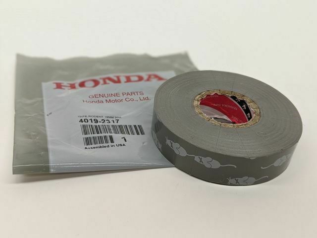

Same thing happened to my Jeep. Rodents made a nest under hood and chewed through some of the wiring. My C7, and later my C8 weren’t touched. I think the rodents just go for what seems like an easier target for them. After I got the Jeep fixed, I wrapped the wiring bundles with Honda Rodent Tape (around $40 on eBay or at your local Honda dealer). It’s infused with Cayenne Pepper and burns their little mouths. After wrapping the wires, the rodents never came back.
Honda 4019-2317
Rodent Tape 19MM X 20M

OP - sucks that the critters feasted on the wires in your C8. I have heard about the Honda rodent tape - and from what has been reported it seems to work well.

Sounds like a good plan except that getting to the wires to wrap them may be a bit of a bother.
