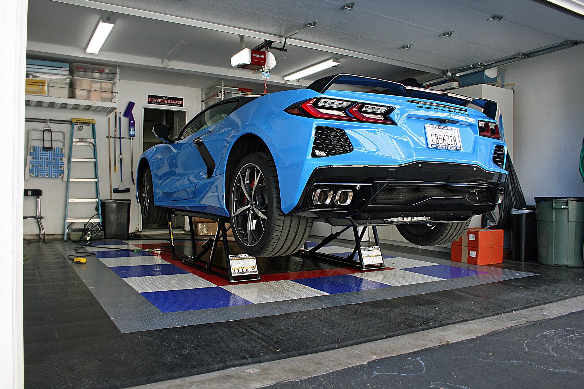

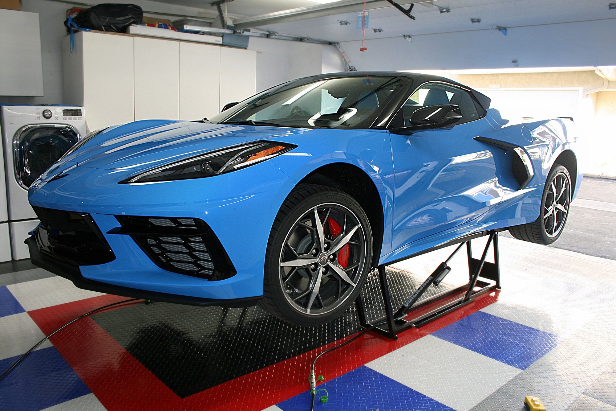

I have SwissTrax flooring, so it's very easy for me to align the frames both at the tops, but more importantly, be sure they are PARALLEL to each other. Again, my flooring makes it easy for something to use as a reference point.
I have " leave in pucks" in the car, so it's super easy to use the smaller height rubber blocks on both ends of the lift to totally cover the leave in pucks, and they are very stable. Although they give you plenty of rubber lifting blocks, I've never gone more than 1 block high. Hadn't had the need.
Lastly, I leave my QuickJack lift flat on the floor when not used. I just push the two frames together at the center of the garage floor and either our C8, or our SUV easily clear the flat frames without issue. I then store the power unit under my roll away tool chest side cabinet, and the two coiled up hydraulic hoses which hang off the end of the tool chest along side my compressor.
As stated above, be sure to hold down the DOWN button on the controller when going to connect the hydraulic hoses to the power unit, and again, after lowering your car off of the lift..... hold it for another 5 seconds or more.... takes the pressure off the system.
DON'T forget to open the vent on the tank reservoir ...... ask me how I know .... LOL !!!! Forgot once, and it sucked the sides of the plastic tank in. Fortunately, I caught it right away.
