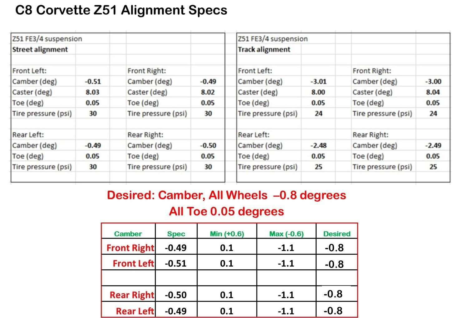

Yep, recall the large Chevy/BMW/Mercedes dealer in town (I don't use for my C8) installed a similar device that does a quick check when you pull the car in! Doubt that accurate. Frankly I recall back in 1959 when I had my first car the State inspection had a big dial meter you could read re front toe! It was pretty simple. You drove over two plates that could move sideways on bearings! The pointer showed toe-in and toe-out. If it showed toe out you failed. Would not be hard to noncontact measure top versus bottom of wheels from a fixed geometric plane and get a rough camber measure.
FREE ALIGNMENTS:
You can get a FREE Alignment, typically within 500 miles BUT DON'T ASK FOR A FREE ALIGNMENT! Recall when I posted what I do someone with a C7 said they were told when they asked, GM does NOT give a free alignment on warranty! I never ask for a free alignment. I just say after ~500 miles when the sway bar bushings etc have worn in that: "Feels Like My Car is Pulling to the Right!" That allows the dealer to put on the warranty reimbursement sheet, "Customer Says XXXX." That is how they get paid by GM!
Depends on the dealer as some posted they get one free at 7000 miles etc but don't see how the dealer can apply to GM for warranty reimbursement at that mileage. Hit a few potholes and alignment's out! Also some dealer's rightly won't lie on a GM warranty reimbursement request! Heck if they do and GM service satisfaction folks call and you say yep got a free alignment it's their *** not yours! If you don't like to say something you can't feel, suggest driving on a narrow rural road and take your hands off the steering wheel. You'll feel it go to the right!
My Experience: GM's allowed variation from alignment centerline spec is very broad. For example can drive a truck thorough their + or - 0.6 degrees camber from centerline spec. So the allowed rear camber on my 2017 Grand Sport was, as noted in the pic below, -0.5 to -1.7 degrees. I brought a spreadsheet in with GM spec, range and WHAT I DESIREED. My rear camber was close to GM max allowed, -1,7 degrees. I had asked for -0.8 and the tech took ~40 minutes to make all settings to my sheet. He did not have to do that BUT frankly I offered a nice tip for doing what I had listed! In fact only one toe was out in Red on their Hunter Alignment Machine and he could have taken 5 minutes and just corrected it!
For my C8 I did the same at ~450 miles. Turned out only one rear toe was in the Red and needed to be adjusted. All other camber and toes were close to centerline so no adjustments were made. Tech still got a nice tip!
Below my 2017 C7 Grand Sport Specs.

Tire wear is very even. With ~6500 miles decided NOT to rotate tires. Would be foolish IMO to use -3 degrees Track camber setting on the street! I push lateral "gs" in a few favorite safe places. Fine for me! Was for C7 2017 Grand Sport where max rear camber was only -1.7 degrees, but I compromised at -0.8 digress with those 335 wide rear tires.
