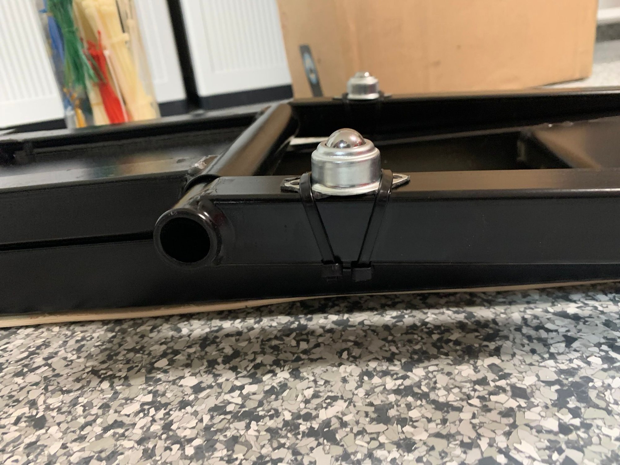

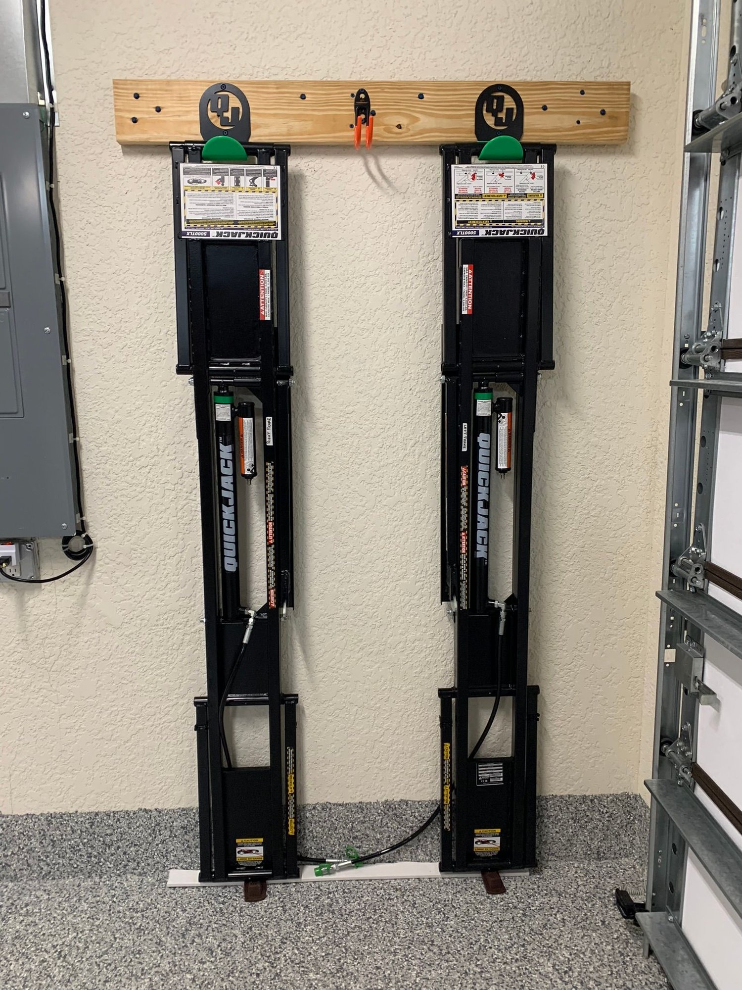

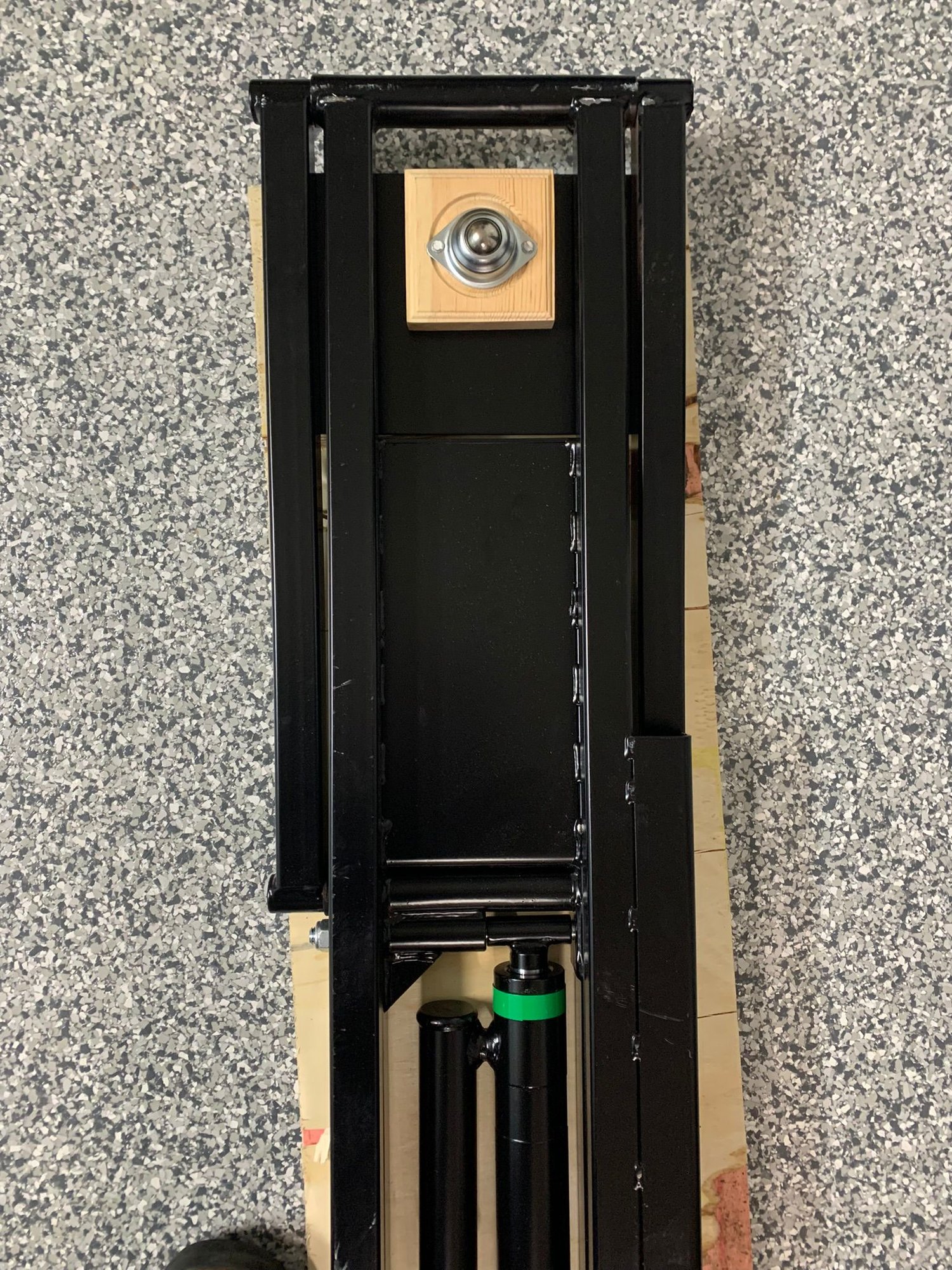

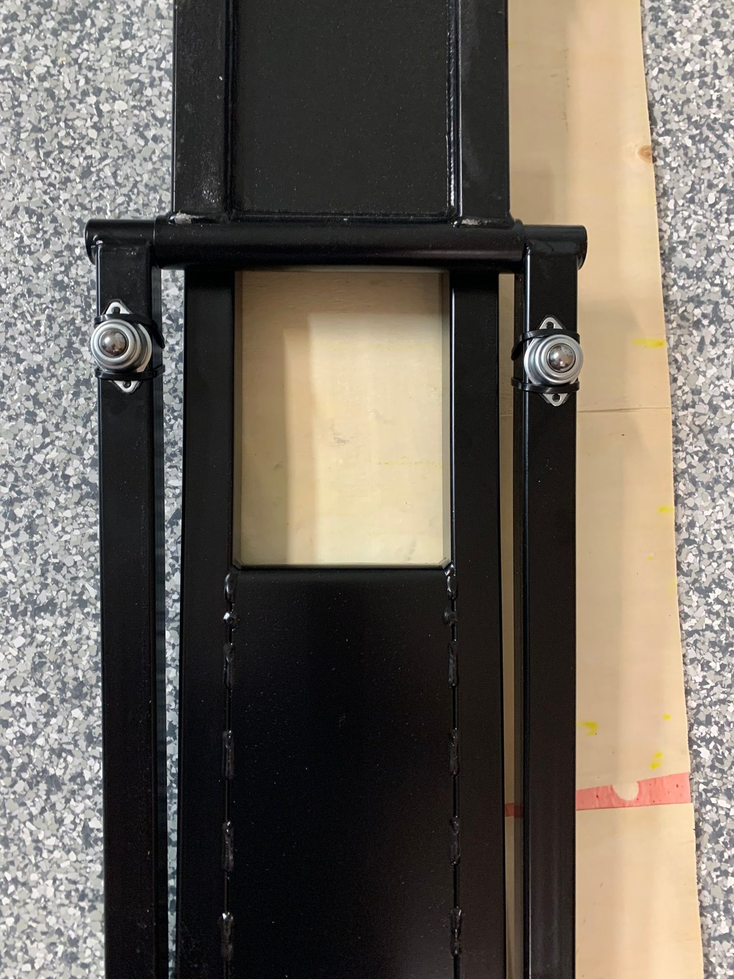

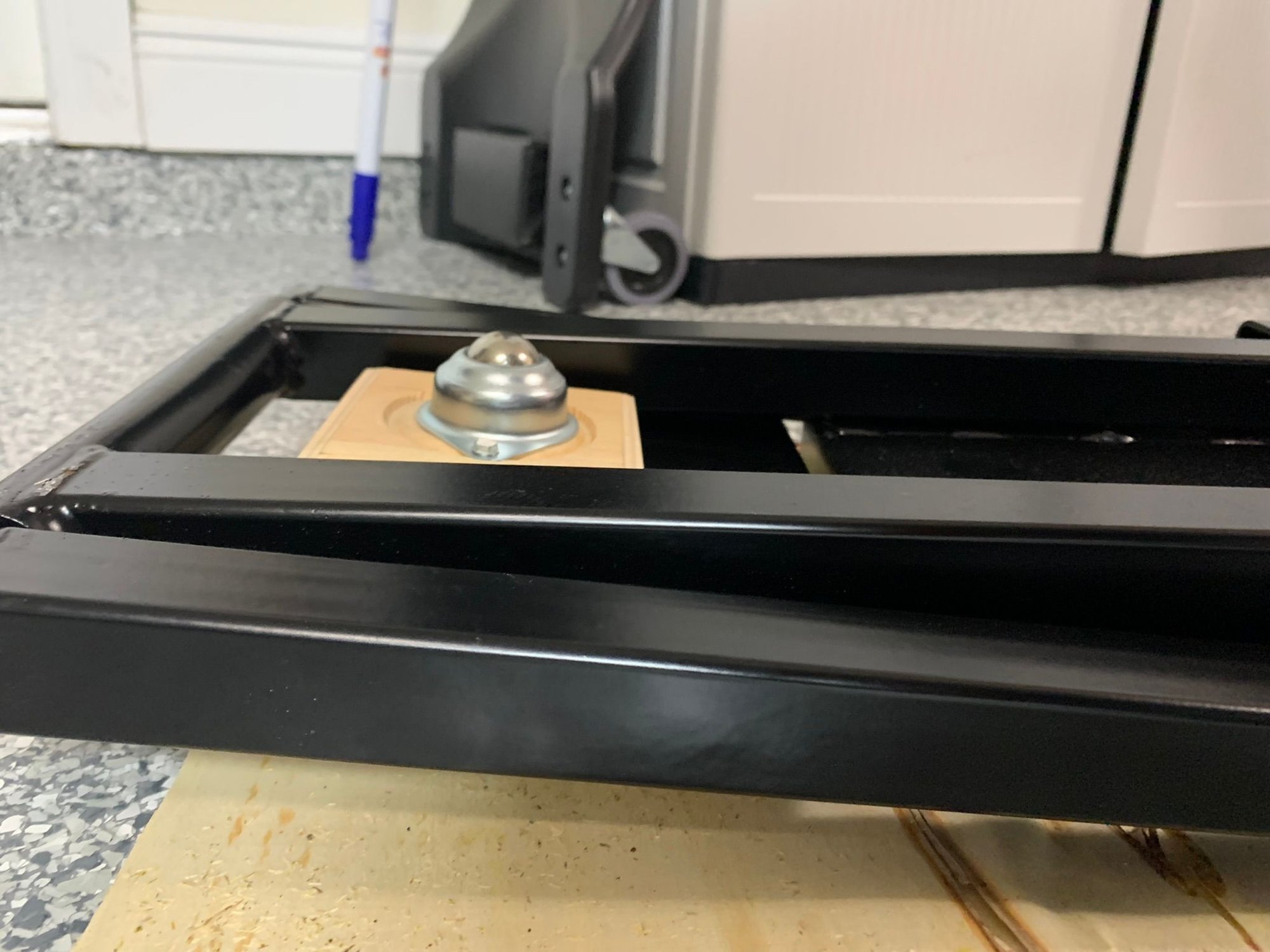

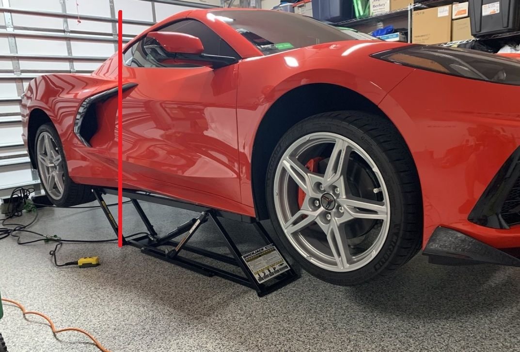

I received my QuickJack 5000TLX the other day and here are a few observations and pics.
1. Unlike others I found going through the set up process is time consuming and tedious.
2. The frames are extremely heavy…I mean really heavy and almost impossible to lift to store them out of the way.
3. The frames are difficult to move around on the floor and position under the car until I found several videos that showed how to add roller ball casters. Casters are a must have!

5. I was very surprised even though I got the extended version it was barely long enough to properly align with the C8 jacking points. There wasn’t an inch to spare.
6. I quickly learned do NOT use a wrench to tighten the reservoir cap it’s very easy to strip! My Duh moment.
7. Aligning the Quickjack frames (even with each other) is not as easy as it appears. Even though I got each side mounting points correct I quickly found out when lowering the Quickjack the Lock Bars where off. When one side reached the Lock Block the other side was still about an inch away from its locking block. This could result in one frame lowering while the other remains lock, not good.
Overall its well built but I much prefer my Jackpoint Jackstands which are far easier to use and weight a faction compared to the Quickjack system and are far less complicated to use. The only reason I got the Quickjack is I live in a flood zone.

I have a set of the original QuickJacks and they initially came with rollers at one end. Makes moving them around a breeze. I'm surprised they removed them on the newer models.

The wheels are still there. He is complaining about moving it on the floor. I just glued my rollers to the frame.

2, 3) leave them on the ground under the Vette - weight worries disappear. They are easy to slide around on the concrete
7) cycle them a few times and they get more consistent. mine are within 1/8" or so.
Suggestion: reverse the left and right sides so the *** end of your ***-heavy C8 is better supported. Right now a big piece of *** is hanging in space

I agree...... even with the extended length, there is no left over length when jacking up at the correct locations on the C8.

I installed rollers and it is eazy-peazy for this 70 year old.

I rented a hydraulic unit from some guy and used my lift frames-all work great-yes set up took a minute but definitely very solid well made lift-yes darn heavy but this 71yr old guy managed to stand them up and put them in home made wall set up-actually seems like a great product except for actually delivering a working unit of my own!!

You have your lock bars on the inside of the frame. The manufacturer says not to do that.
