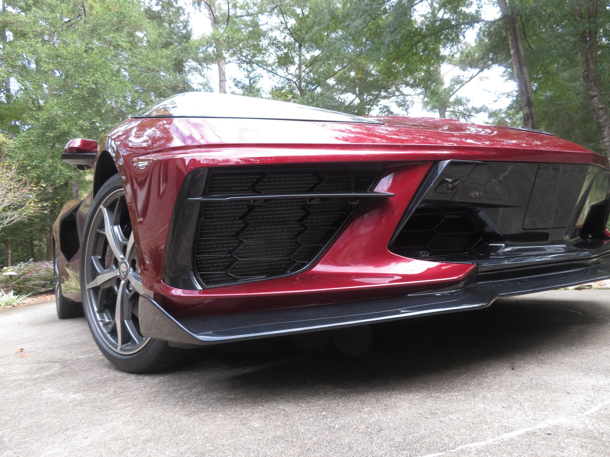

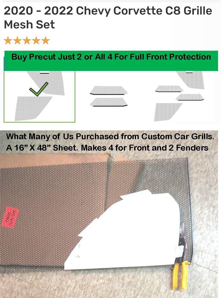

Many of us used Custom Car Grill screens with half the size holes as the GM "approved" screens. They now offer a mesh with the same size IF Tracking in a Hot Environment (but you'll let in twice the size bugs ~3.5 times the area!)
My smaller 1/4-inch mesh screens have been installed for over a year and on 100-degree NE SC days with aggressive street driving (NOT TRACK) have never had coolant more than about 185 F!
They are made from thin width aluminum that is deep so the screen is ridged. Mine are black power coated. You can buy a 16" X 48" mesh sheet and cut your own as I (and many others) did. BUT you can make all 4 required for full front protection as the AC Condenser (coolant rad behind) extends into the center grill opening. You have enough to also make grills for the rear fenders if you think needed. As noted below they also offer precut screens, $69 for the two large and $99 for the 2 large and two smaller for the center. So think you only need the two large areas covered like the $399 GM "approved" screens, precut they are only $69. Or cut your own and get a buddy and cut 4 (actually could get all 8) for $69! Think you need the double size holes- same price, just more bugs and debris getting thru!
As far as professional look, I (and many) installed by removing the center grill (as required for the "approved screen" install) so the black plastic ties are hidden. Edges are behind the grill and not visible.

Price is for Aluminum finish. I and most bought Black Power Coated now $69.
Removed Grill Bar so the black plastic wire ties used to attach are all hidden. Both install options are covered in PDF.
