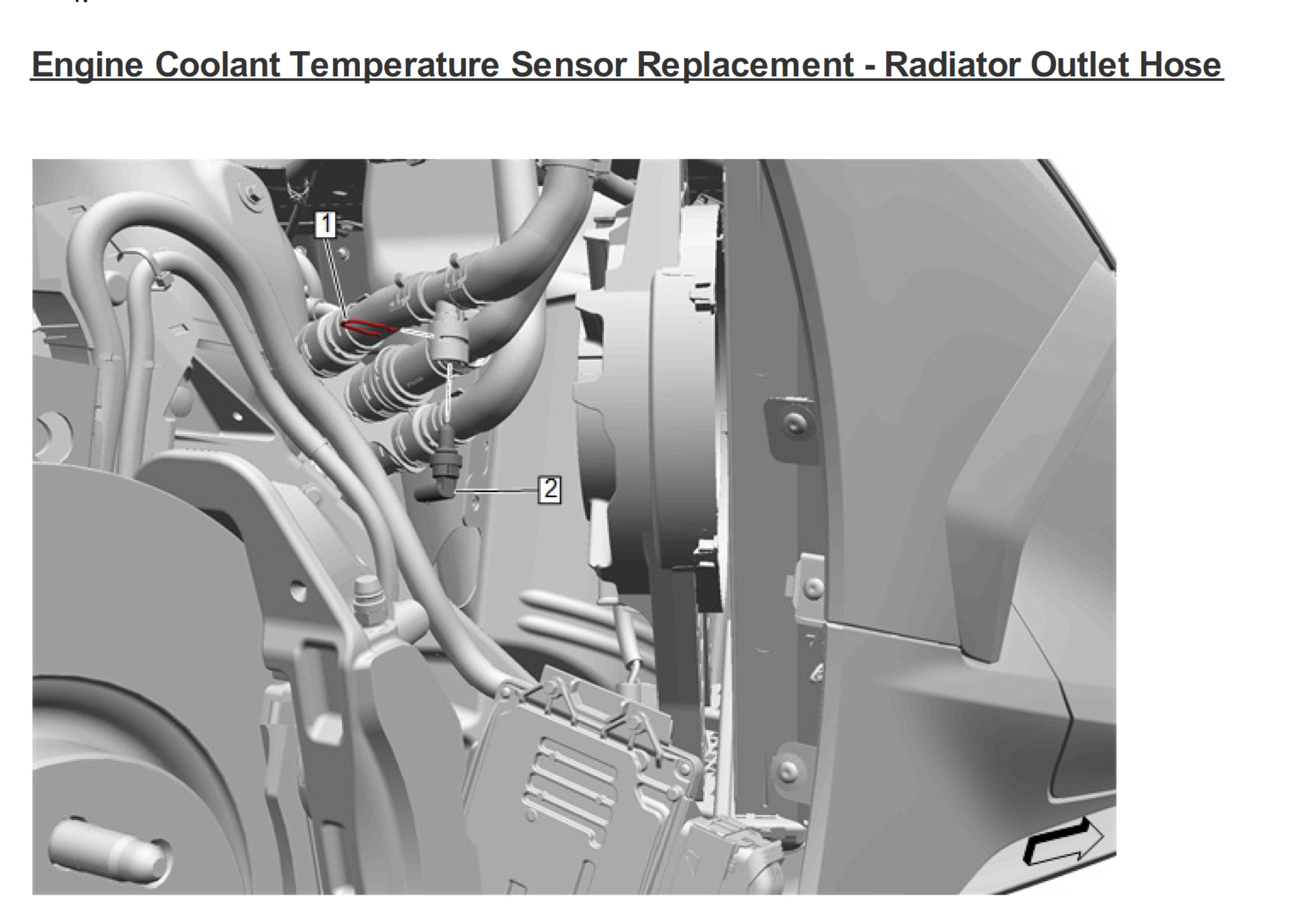

Default There are three separate thermostats in the cooling system
Originally Posted by C8J
.......How does the C8 meet the requirements with a 180F operating temperature?
I don't know the answer that (the service manual mentions a 176 degree thermostat) - but I during discussions of operating temperature, owners report numbers all over the place, which we attribute to different ambient temps and different driving conditions. Still I was kind of surprised to the the fluctuations, given that the cooling systems generally have excess capacity and so it should be possible to regulate the operating temperature and keep it near a target value. I was thinking that maybe there were computer controlled thermostats (there are not). I looked in the 2020 Service Manual, and it turns out that the car has no less than 3 different "Engine Coolant Thermostats". 1) Auxiliary Radiator Inlet Hose to Auxiliary Radiator Inlet Hose, 2) "At Engine Coolant Manifold", and 3) Radiator Inlet Hose to Auxiliary Radiator Inlet Pipe (with V09). V08 is a code for Heavy Duty Cooling System. I could not find anything for code V09. These three are self contained thermostats with no external electrical nor vacuum connections, so no computer control. The computer does control the activation of the fans - as we know. Anyway - I thought the fact that there are three thermostats might be of interest.
3) Radiator Inlet Hose to Auxiliary Radiator Inlet Pipe (with V09) (V09 is as written in the manual - cant find that code - V08 is heavy duty cooling

Ha. Actually there are at least three temperature gauges measuring engine coolant temperature in various places.. Radiator Outlet Hose, Engine Coolant Temperature Sensor, and Oil Cooler Outlet. I believe the oil cooler is a heat exchanger between the engine oil and the engine coolant, and this last one measures the temperature of the engine coolant that is exiting the oil cooler. There is wording that suggest to me that the engine coolant temperature gauge is reading only one of these (though its not entirely clear) - the one called Engine Coolant Temperature Sensor but not certain. I was just looking for anything that summarized the overall strategy for engine temperature management that might provide a clue about the target temperature and target for variations. Did not find that.
Engine Coolant Temperature Sensor Replacement - Radiator Outlet Hose
Engine Coolant Temperature Sensor - Engine Oil Cooler Coolant Outlet Hose (with V09)
Schematic
