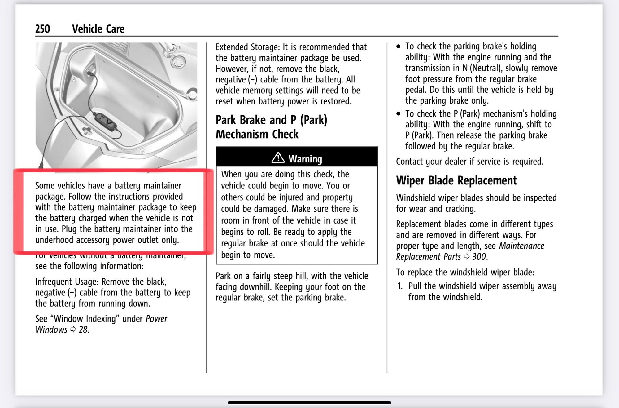

Owner’s Manual says…

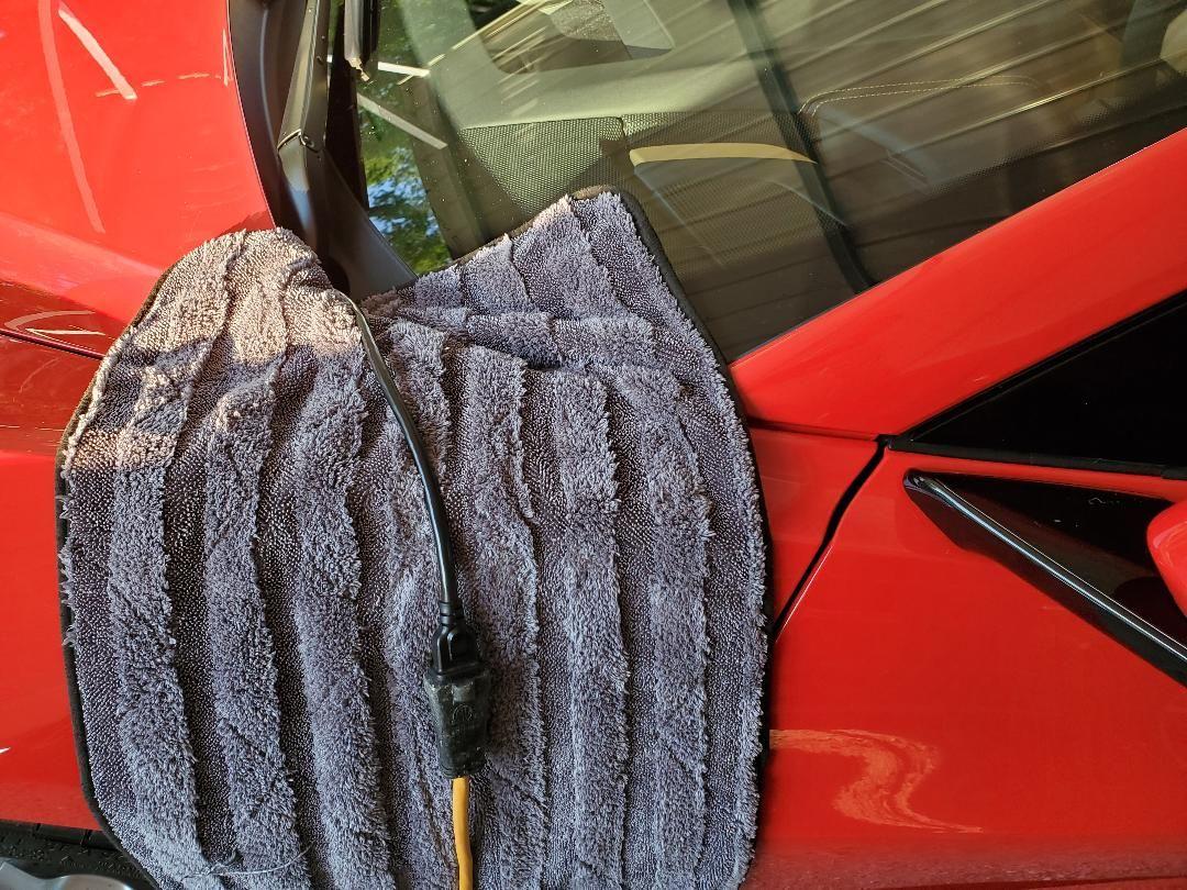

You can close the frunk with the charger plugged in if you run the cable out by the wiper base.

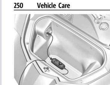

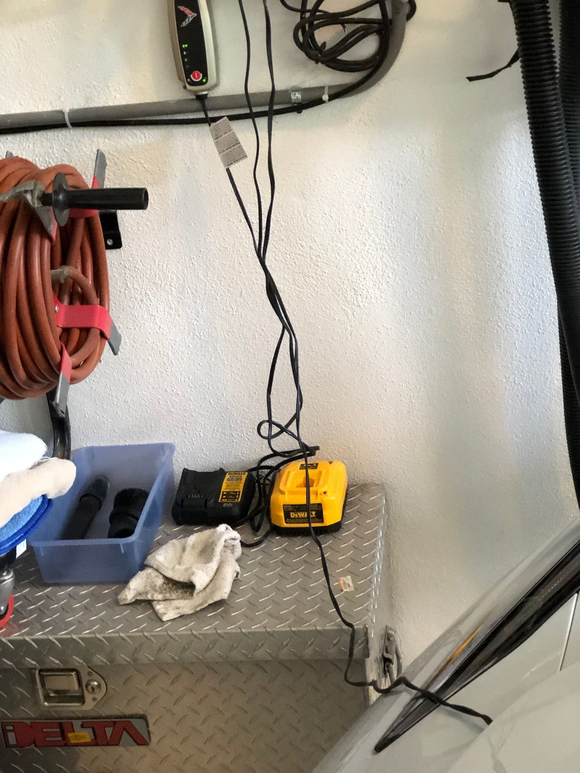

Didn't actually notice that the manual showed the maintainer in the frunk. That kind of bothers me. I've got a CTEK MUS and have always ran the lighter plug cord into the frunk with the tender and all AC cables away from the car. Am I just over cautious?

Mine sets in my frunk as shown in the picture above. It gets a little warm but by no means does it get hot.

I don't think that image appears in the earlier manuals. I use my battery maintainer in the garage. It sits on the concrete floor, away from the car. I have several for different vehicles and I generally try to keep them away from the vehicle. Are you being "over cautious"? I have never seen one of these catch fire, but I have had one overheat from an internal defect and get pretty hot (not recently, and not a CTEK). For me the location difference is trivial - in the trunk - on the floor - I'll go with the floor. I consider it cautious.
