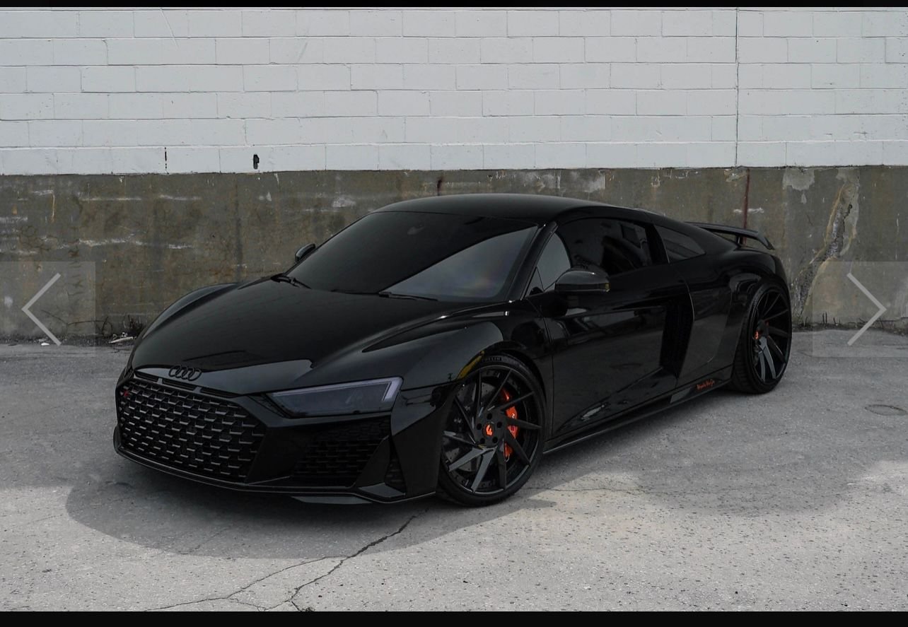

Hello guys, I’m a newbie. I’m wheel shopping for C8 corvette wheels since the stock wheels don’t do it for me. Im running the stock tires and will stick to the same stock wheel sizes 19X8.5 front and 20X11 rear. I need info for the off sets please.
I want the wheels to be flush to the fender and and with NO rubbing. Also I want the REAR wheel to have the concave look. The car is NOT lowered so it’s stock height. I’m attaching a pic for the look that Want to achieve. Any replies would be very much appreciated. Thank you guys in advance

Welcome. Very nice.
